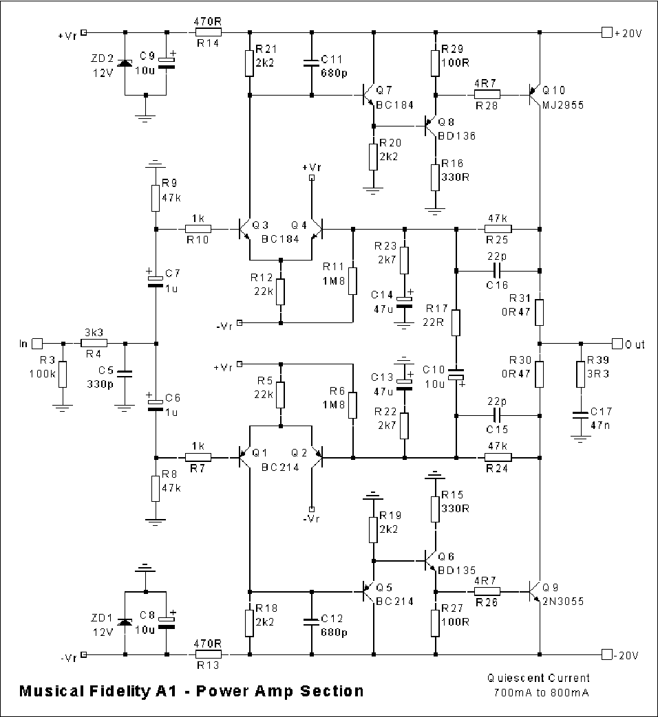

ostripper Member Joined 2008 2024-09-17 7:04 pm #21 2024-09-17 7:04 pm #21 What a simple amp. I'm sure the Chinese have dumpsters full of them parts. Hmm , the CFP output maintains class A bias. Would of been nice with idle/offset trimmers ?? Then they would charge 100$ more for it - fancy. OS Attachments musical-fidelity_a1_amplifier_schematic.png 7.6 KB · Views: 55
