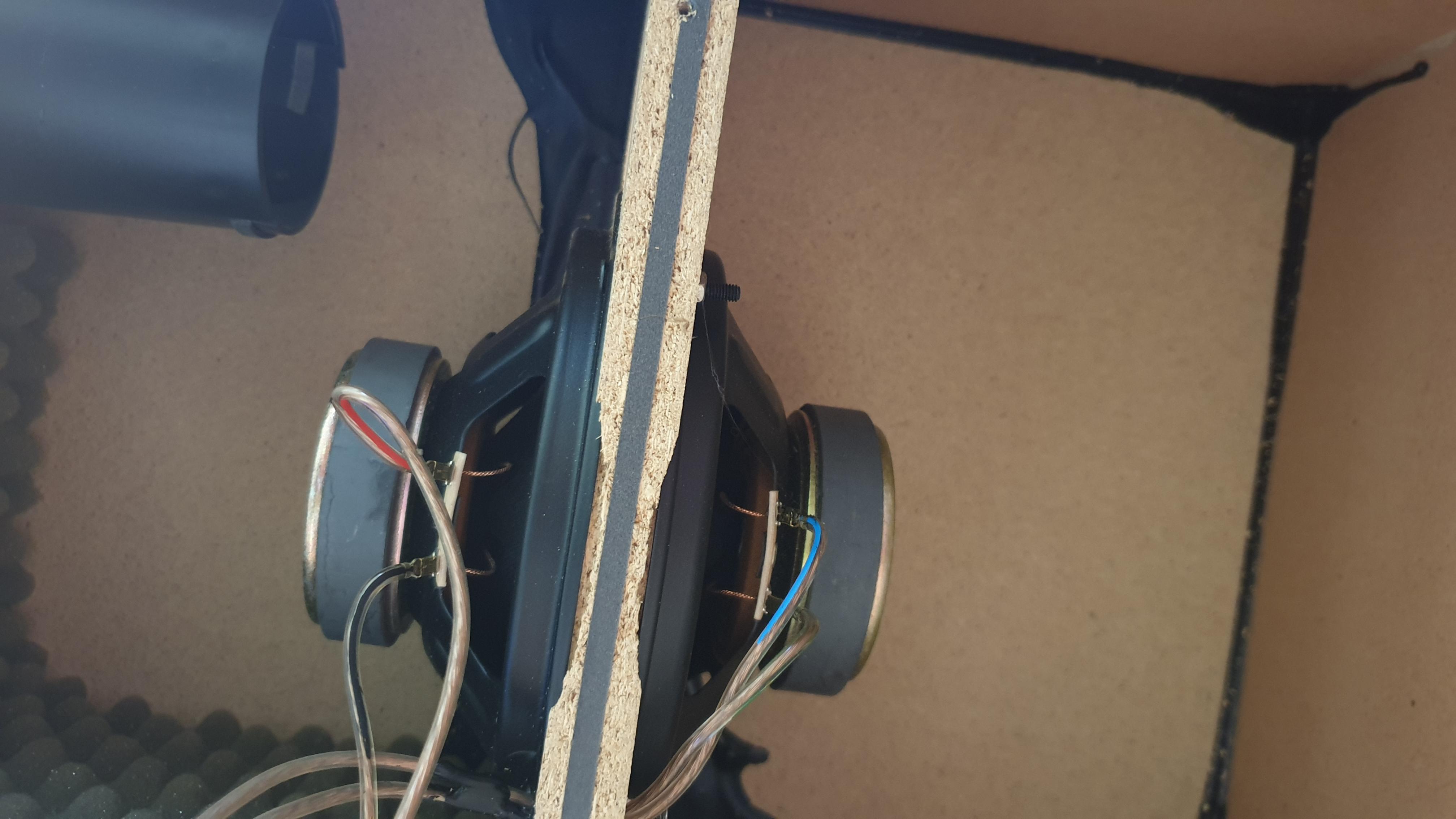

How is this a good idea ?
I was seeking a bit more bass on my sub. So i opened it up to see the crossover circuit.
I am still learning tearing old speakers apart but never a sub. So my question might seem dumb but here it goes. How or why is it a good idea to place the speakers like that ? Does it not reduce the effect ?
Its a jamo subwoofer.

If you simply start from scratch with the isobaric TS parameters instead of looking at it as a Vas / 2, the results tend to be a lot more constructive then if comparing it as an apple to 1 or 2 Sd of that driver. MLTL can be really neat with this. If you already have the parts, it’s kinda silly to pursue it though?? I’ve only done it with ‘leftovers’ from car audio and made an Mltl that was rear vented on the other side with a restrictor plate to fine tune the response (in theory, ��)..
