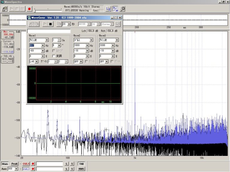

fumihiko said:
I try again measurement with +20dB amplifier and Roland UA-30.
-60dB 997Hz sin-wave 16bit/44.1KHz input,
It is a result of measurement.
The vertical scale,please subtract 20dB.
Can You do 128 x averaging ? The noise ...

Hi Bernhard
averaging 300times
noise is DITHER
my system is CS8412-SM5842(dither on)-PCM63PKx8/ch
averaging 300times
noise is DITHER
fumihiko said:
averaging 300times
noise is DITHER
What would you say where the noise floor is ? xxdB below measured signal ?
Do You prefer parallel PCM63 ?
KONNICHIWA
noise floor -120dB
measuring 34401A with A-filter
