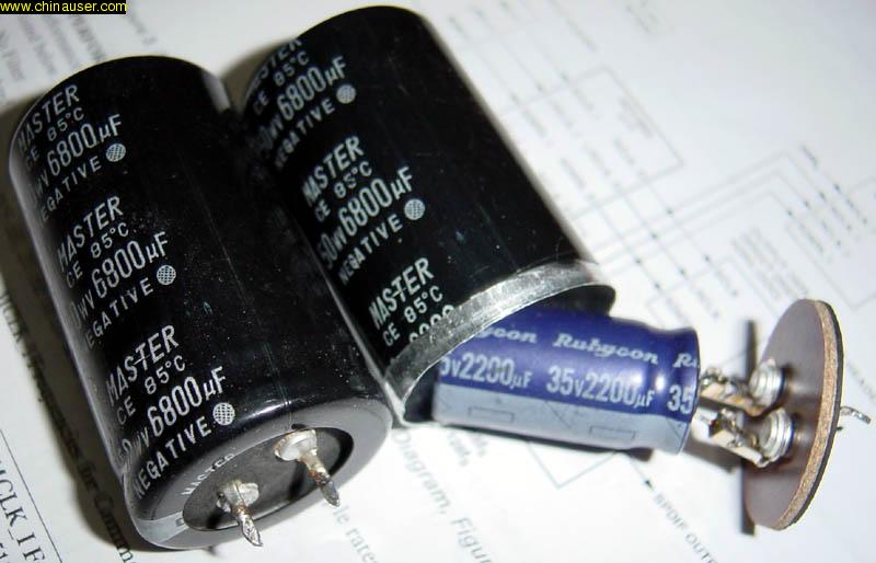

These is a caveat - if the device has any capacitor plague caps (see badcaps.net), definitely replace them. Such a device has probably long since had caps leak all over the PCB and cause havoc though! Alas there are still bad caps around, avoid cheap unknown brands and don't buy caps on eBay unless you know the supplier is trustworthy.
I've been working on amps for over 50 years, both professionally and as a hobby. It wasn't until the market was flooded with fake caps in the mid 2000s that anyone thought of recapping. Then it became a necessity as equipment was failing within months of being released. Otherwise if there is a fault or an amp has had a rough life treat it as a repair. Like previous posts I have amps going back many years and they are fine. I could update the caps and get a different sound but I keep them for what they are and the sound they produce.
Absolutely right.
check out this URLs and pdf attachment
https://www.researchgate.net/figure...he-red-rectangle-The-capacitor_fig1_262772064
https://www.electronicproducts.com/how-to-spot-counterfeit-passive-components/
I've seen that fakery with the small one in the large case for D-cell NiMH rechargable batteries - an AA inside a D-cell case. I didn't kind so much charging more often, the real problem was with vibration as they fell apart in weeks in a bicycle light! I changed to 10Ah Ansmann D-cells - heavy, but reliable!
