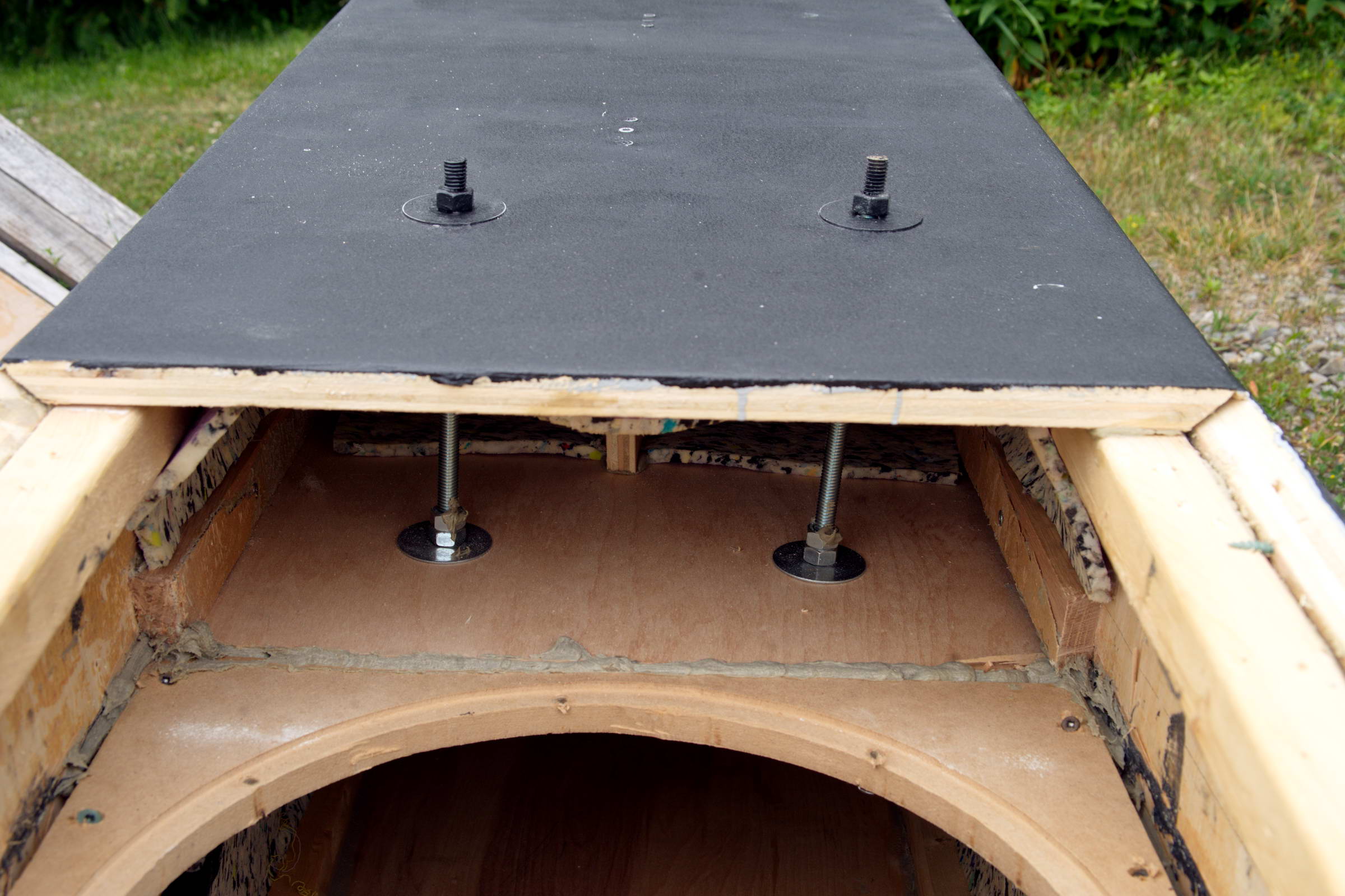

I decided to rebuild a sub and was junking the old one today (keeping the driver though) . Here is an example of what I did for bracing. Lots of PL glue on joints, corners all reinforced with 2x2 and plywood brace which were screwed in place while the PL dried. It really didn't move a lot although I never played it what most people would call loud.
Grant.

The aforementioned threaded rod system is excellent also, especially when building Sonotube, etc., tube type subs to preload/compress all parts together to take max advantage of the tube's incredible axial stiffness.

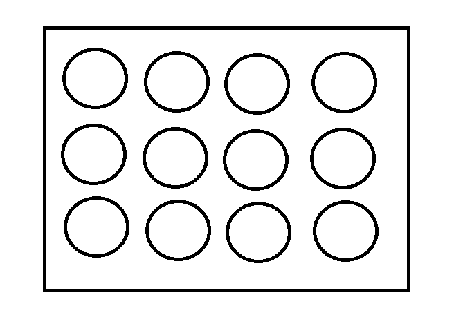

Here is another thought. We all know that if we add a panel across the inside of a speaker that is loaded with holes, it will be just as strong but will take up less space. The load is in plane of the panel.
What if I glued the same panel to the inside of the wall of the sub-woofer cabinet, what it be as stiff as a solid piece of wood? It would still take up less space, but would the area of the cut out affect the stiffness and with the cutout there would still be more area available.
The only problem I can see is how to determine the net volume (Vb). You'd probably have to either fill the empty enclosure with water, or just guestimate, then adjust your port (s) while measuring frequency.
But I like how it would minimize the largest "unbraced" area.
