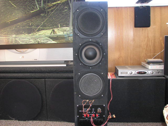

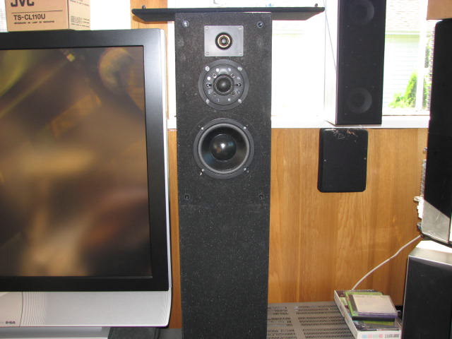

Concerning how critical we all are of our own creations, I think when we do make something we are proud of, we want to share it with those that mean something to us (whose opinion we must value at some level).
I would have very much liked to have gotten other folk's impressions of my latest creation(OK, I designed 'em, and helped build them ), because I think this pair of loudspeakers are quite good, and they are one of the truly full range (as opposed to fullrange, single driver) loudspeakers I have heard. They seem to do most everything correctly. Unfortunately I could not bring them to planet10's place during the recent Van Isle diyAudio'fest, where they would have been scrutinized by folks whose ears I trust. And they are reasonably affordable (and certainly so when compared to other speakers that can produce the same frequency range and dynamics).
Is the construction method the best? No, chrisb(and others) can easily out gun them in terms of build quality, although I do like the over-all look and finish. And a better cabinet would mean not DIY... or at least better DIY, with better methods and tools than I have available to me.
and yes, I start lots, but rarely finish.
