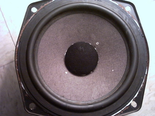

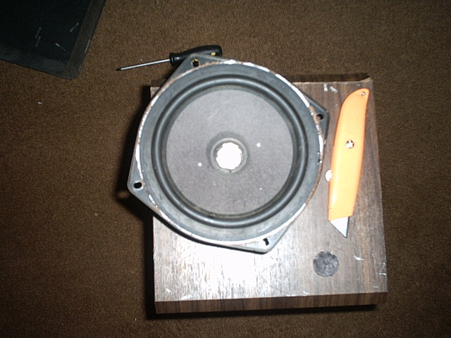

I got a wild hair to fix up these speakers that had been abused by their former owner, i got them for free so what the hey. They are ADS inc. from 1986 model number L470/2. anyways they had the surround completly separated from the basket so i bought some glue (crafters pick the ultimate, big thanx to MarkMcK for the info). and fixed that prob. the dust cap was all crushed in and i read a thread about replacing the dust cap a few days ago and got some ideas.

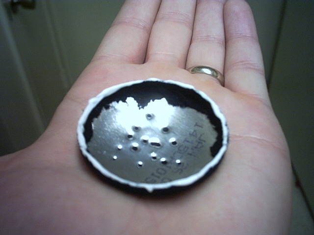

the firsto photo (i've never posted pictures so please excuse any ignorance you may encounter) is of the cut out dust cap, i used a razor to remove as much as i could, there was even dust under the dust cap! I could see the voice coil inside, it was an aluminum one.

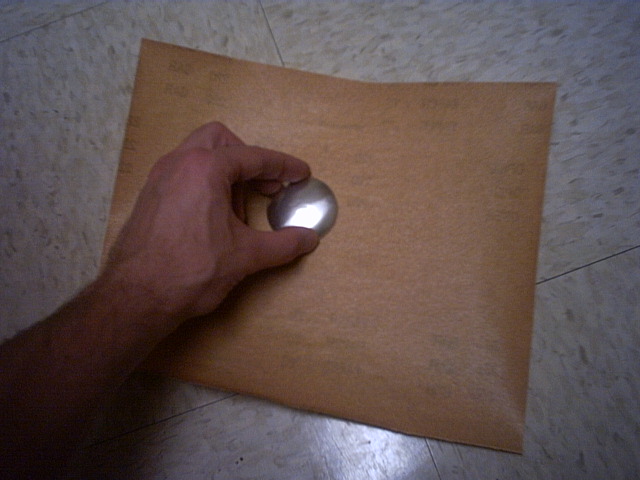

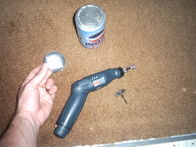

still new to this... anyways, after i cut the piece off the pepsi can i took my dremel to it to make it semi even, no sharp edges. the i laid a piece of sand paper out flat and made sure it was even and flat on the bottom.

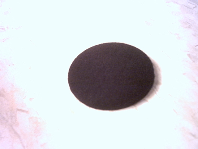

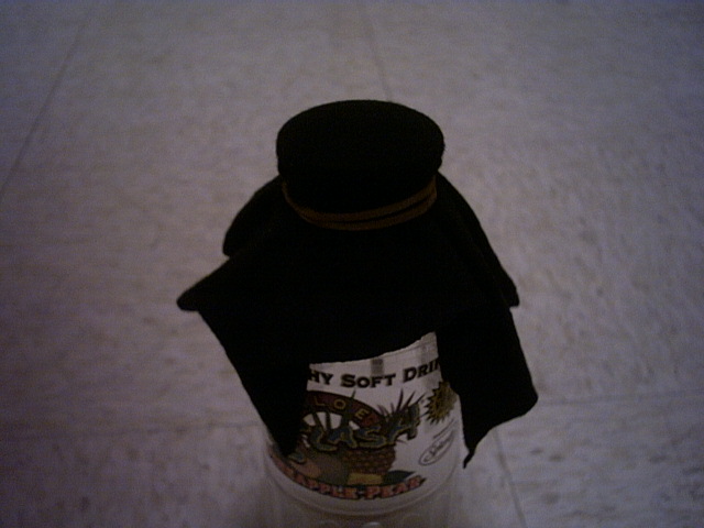

took some stretchy black cloth and glued it with the same glue as i used on the surround. painted it on with a brush on all the top and sides. then i rubber banded it and let it sit for 10 minutes or so. then i cut around the edges.

I hope it stays on. it seems pretty sturdy on there. i glued the edge of the cap all the way around. I will re-edit all these posts once i am not being moderated for being a newbeeeee! thanks for your patience.
Tell me what you think!
