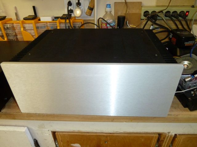

Running about .59V at the .47 ohm resistors, i have 20 deg C over ambient at the heatsinks (using remote laser scanner). That is with the amp running music for about 3 hours. I will up it a bit to .65V tomorrow while monitoring the temp. I do not want to risk blowing anything up and Nelson recommended the bias current at 1.3 amps or about .6V at the bias test point.
Also, I am running only 20v DC vs the 23v most have. Using a 16V transformer, as the 18v are out of stock. Not sure how much that affects things.
With the 5U chassis I am at .760 (1.6Aish). I can hold my hand on the heatsink forever. I have small kids and a curious cat so I think I will stop at 1.6A. And I am getting sick of having test leads sticking out of the amp all the time. One thing is sure though...every bump in bias (I've gone from .5V to .6V to .7V and now .76V) has sounded better with more dynamics, more control and a more precise soundstage.

If you really want to know how hot you can run them it goes like this ,If you have big heat sinks,you can run the bias up till the heatsinks get up to 50 C,then you keep a eye on the transformer because if it's not big enough it will get hot and most of the time starts buzzing,Fans will help the transformer and the heatsinks,alot of folks run .6a and play music,some run 2.6A too ,It's just how much hardware you have and how well you can get rid of the heat,lol. I guess a balancing act so to speak!
I am running water cooled sinks ,I ran up to 3 amps bias but backed off to 1.5 my trans former started getting warm,My F5 sounds good there ,so I am happy,I also have 2 F5c they give the bass a new name ,lol. I read all the F5xxx threads 2 ,,,takes a while,(weeks)might double up your Jfets too! If you have a variact ,try dropping the rails to 18v and reset your bias and then your DC offset,

Thanks for the info. I am running a 18vAC transformer, and biasing it now at .625v at the resistors. Sounds great so far, so I probably will not push it farther.
I may go up a bit on the transformer voltage to 20v (when available from Antec) or 22v. Not sure.
OK, final report. F5 bias set at .625v both channels with 0 dc at the speakers. Heatsinks are 23deg C above ambient. Sounds great! John Hiatt never sounded better, at least in my house....

You can take a single pair of mosfets up to about 2 amps with 24v rails…assuming you have the heatsink. I’ve run a single pair f5 at 1.8A I. A 5U chassis for a long time. Higher than 2 amps you risk overstressing the devices even if the heatsink temps are reasonable.
If you have another pair of mosfets like the f5 turbo you can go higher. Currently running 1.8 amps with 32V rails with dual pair mosfets in a 5U Chassis.
