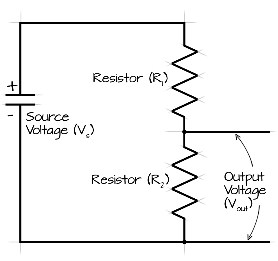

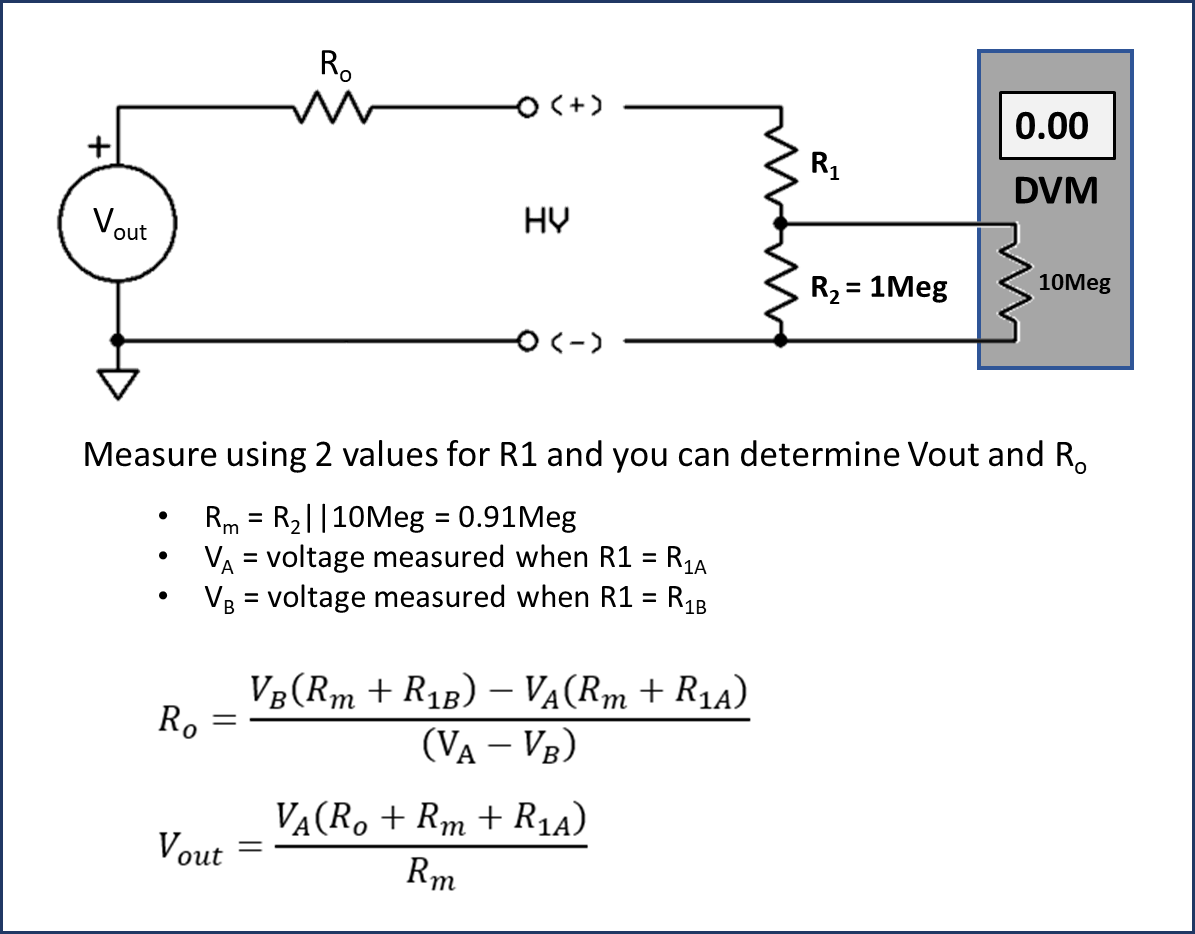

Am I blind or has nobody asked about the input resistance of WrineX's meter that's in parallel with the tapped (final) resistor in the chain? Isn't that the basic question here?
Like post #2, I use a string of super-high resistors (might be in the giga range) in a plastic tube, which results in 1000:1 ratio. The tapped resistor might be 1 meg (not sure) which works OK with modern digital multimeters.

I use a 10G 5W from Aliexpress straight into the 10M input of a vanilla DVM, forming a 1000:1 divider, direct reading in KV. Less than $10 shipped.
It's perfectly safe and stable.
