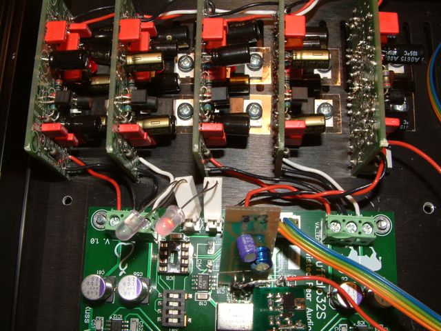

BUF32S with analog stage on LL1527. All opamps removed, 2 x LT1086 3.3 as temporary AVCC supply. Seems I'm not alone modifing TP design ...

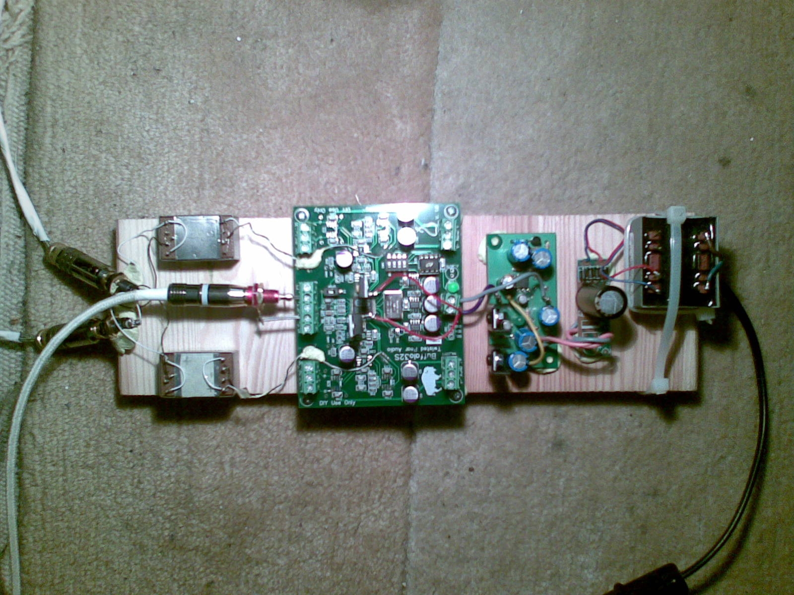

BTW guys, my advice regarding the output stage of Buffalo32s, no matter what regs you use , try running its supply for left and right separately:)
Running temporary until I get Pauls regs.
For each Left and right channel I currently use 1 x E/I core centre tapped transformer feeding rectifier (UF4002 diodes) - 3300uf 35v Panny FM - Burson reg - Buffalo32s
This was better than using single toroidal transformer with dual secondary supplying 1 x +/- main psu board feeding 2 x +/-v Burson regs
brgds, I initially wanted to use an external supply at the positions where you have put the two LT1086 but in a thread on the TP forum Russ commented on the possible benefits of this by saying that:
"None that I know of. :) I just added the capability so I could adjust the voltage level itself. By increasing to say 3.5V you get slightly better DNR and more output swing. :) By lowering it you get lower output etc. You could do that very easily with a voltage divider and say 5V from some place :). The ref line has a RC filter prior to the reg. That will still be in play even if you use an external ref".
This kind of turned me off (maybe wrongly) as I don't need more "output swing" and as the DNR is already quite excellent. Did you find any improvement of this mod?
Why are you feeding the analog rails on the PCB traces? Am I missing something?

Nic,
to put any supply for 3.3V was a necessity - after removing of opamps - the last one LME49710 - buffer - is the one that supplies AVCC dynamiclly being driven by current signal level - AFAI understand. Unfortunately, TP guys weren't so kind to publish the scheme, moreover, they claimed that it's very hard to omit opamps and they wont support such ideas - the product itself is an excellent one and that's all. Why did I removed opamps? They simply sounded bad. AFAIK there is no other way than take the signal from PCB traces (or first opamp nodes after removing them) to feed trafos.

Anecdoatally, the Sabre seems to respond well to separate & clean PS for each part of the DAC (some parts are more sensitive than others) & it would seem that the Buffalo board does not accommodate this too well - I think Neo's board has all the supplies separated? - maybe he can say something about this aspect of his design. Gordon Rankin with his Crimson DAC incorporating the Sabre also goes this route with something like 8 regulated PS to the DAC. For instance, I have been told by a very knowledgeable digital audio member that it's also important to keep the supplies DVCC_top separate from DVCC_bottom for clock purity reasons - something that may be impossible to do with the Buffalo configuration.
I figured when you add up the cost of good regulated supplies for these 8 (or more supplies) it gets costly (just price a PH reg) & begins to make it a complex build. I cut through this cost & complexity by going for High current delivery 3.3V batteries for individual supplies & 1.2V for core supplies - cuts down al lot of the cost & complexity & the batteries are 4mohm impedance. This was not my idea but a member here. This member also uses a transformer output stage rather than any active device (as does Gordon Rankin)
I also decided to use a prototype board as a tweakers platform, which even though it may not be optimal, gives the ability to experiment. Of course this is all vapour at the moment - I haven't built it yet - it's mounted on the protoboard & I have the 3.3V batteries - need to source some 1.2V batteries, connectors, etc
