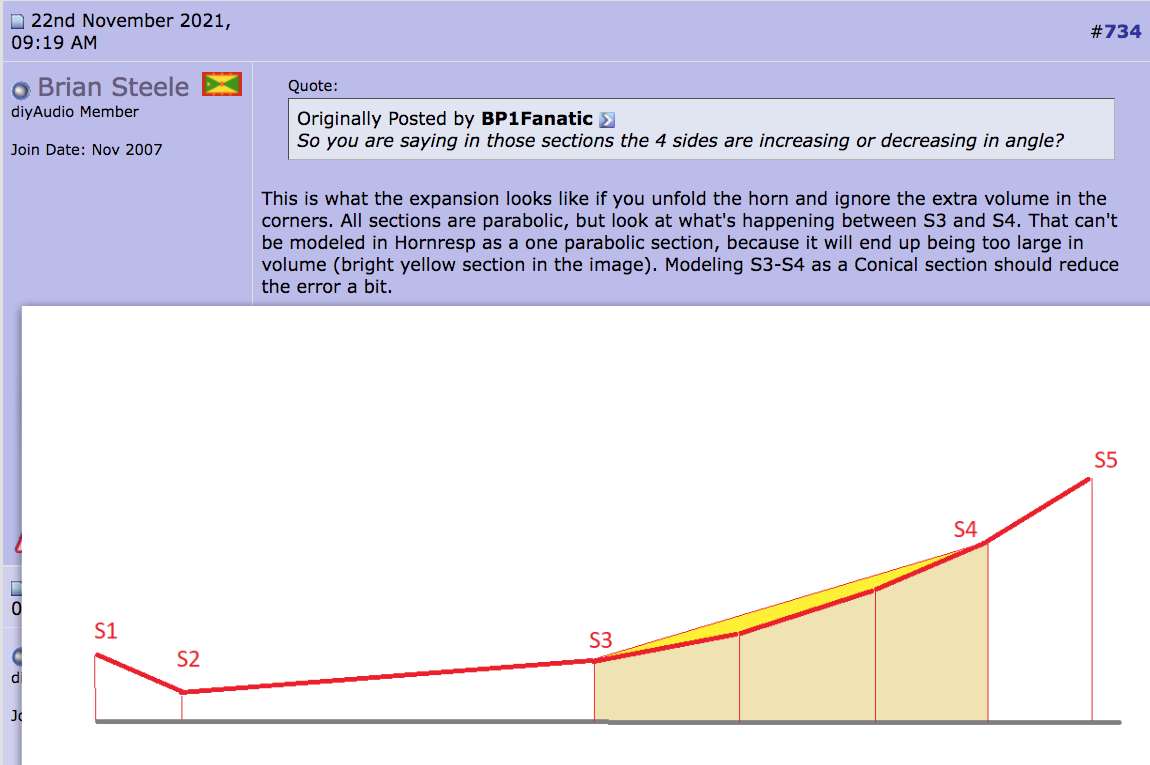

Hornresp is accurate - I find the worst discrepancies are caused when people create sims that do not correlate to the physical sizes of the cabinet.
The system volume in the schematic diagram is a good sanity check. If its way out there is definitely somthing wrong.
In what way would it be way out?
A good example of "modeled" versus "built" is using CON or EXP as a segment flare.
I have yet to see a "built" CON or EXP TH.
The correct flare is PAR.
Oh right..
Par meaning parabolic?
And why does it need to be that?
Yes.
Because what you build will have 2 parallel side panels and non-parallel top and bottom panels.
Right, so what you’re saying is with any normal fold, it is impossible to use conical, unless the box has non parallel / irregular surfaces?
Two parallel side panels and non-parallel top and bottom panels are a parabolic, not a conical expansion.
That said, multiple series parabolic expansions can be nearly equivalent to a conical, or even exponential expansion.
Since the amount of horn segments in Hornresp is limited, a choice of "conical" compared to "parabolic" may be more appropriate to what the cross-sectional area expansion is in a specific region of a horn's fold.
So are you saying conical is closer to reality in some horn reap models?

Posts 731-734 In Brian Steele's "Spreadsheet for Folded Horn Layouts" thread explains what I wrote a few posts back.
Spreadsheet for Folded Horn Layouts...
Hornresp assumes a circular, not square, rectangular or any straight-sided shape.
As far as low frequency sound waves propagating through a horn, the cross-sectional area, rather than shape is the primary consideration. If the horn's cross-sectional area as built matches the simulation closely, the Hornresp simulation should also be close to measured response.
