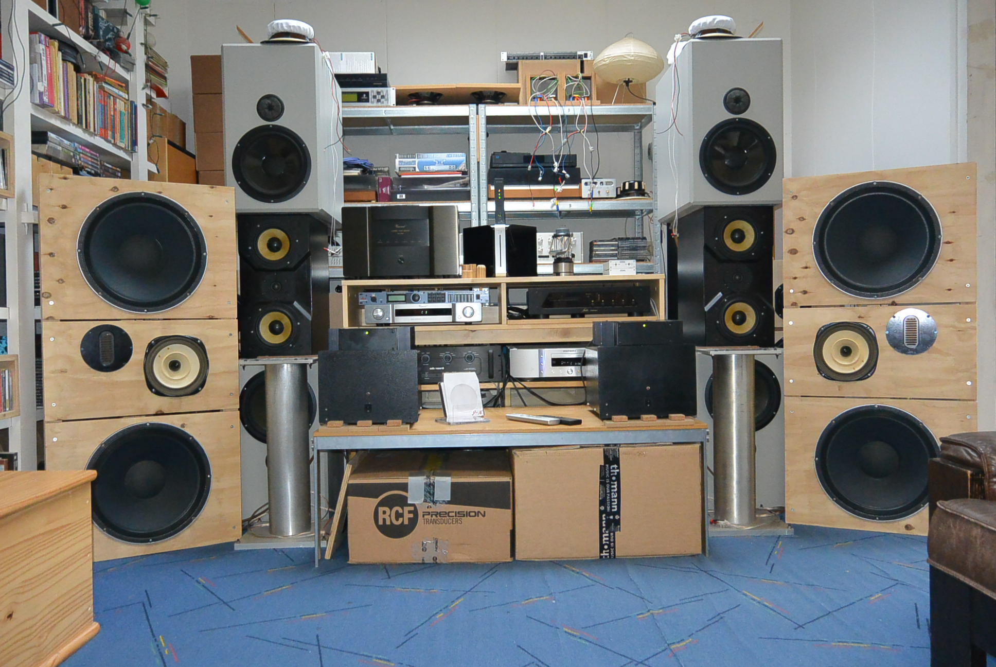

I use OB speakers with passive XO.
In the back (picture) you see my large conventional speakers.
6x 250 watts Vincent amp for DBX driverack PA and complete d'Appolito config. 2x Eton 11 inch , 2x 7inch kevlar and Scanspeak Aircirc.
I used mini dsp before the driverack.
Just passive OB is more musical to my ears.
All those dsp stuff is a little 'artificial" , so try people to go passive all the time.

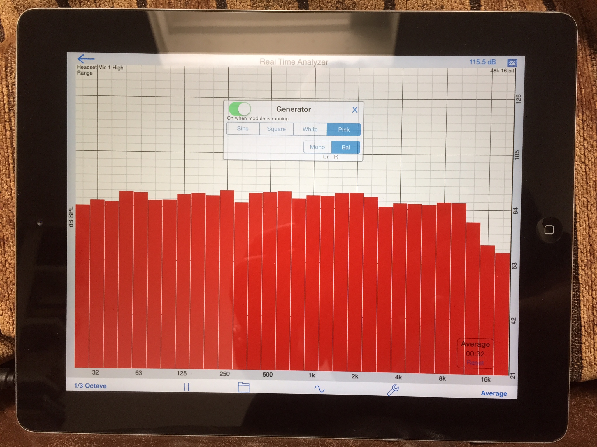

Measurement at listening position in room using iPad and cal. Dayton mic.
This was before adding the AMT tweeter 🙂
sinc. Leon

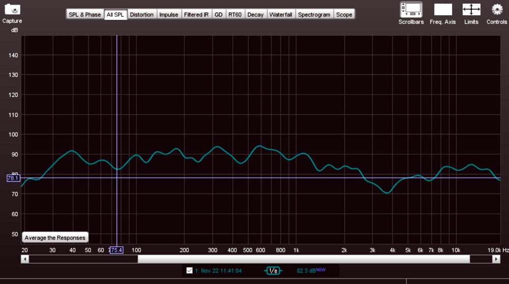

Here you go Ben,
Acoustat X... no eq, taken moments ago...

Many thanks to mark100 for the FR, although 1/12 might reveal a bit more fine-grain. I also do fresh REW curves and post them (when I'm not packing for a vacation) and, no disrespect, know I can pick-and-choose the ones I like best, moving the mic just inches. Being a curve poster, it is no fun when people say that to me, but it is the truth.
Yes, in my opinion, if that curve summarizes the listening experience, nobody playing acoustic music on the planar forum would be missing a thing and that includes me. It is quite good although not clear what causes the 40 Hz boost and if that boost isn't as tasty as the rest of the sound compass.

Ben, you need more information...... for the conclusions you are drawing.
That curve I posted was neither handpicked, nor begins to represent what the speakers sounds like. In fact, it was literally the first time I've ever measured an acoustat. I've read electrostats are inherently difficult to measure, and frankly I've given up caring about home gear quite a few years ago.
That quick curve was solely at your request to show it has good relative bass output....single octave smoothing would be fine for that purpose.
Heck, I didn't even pull the speaker out into the room position I've found that sounds best. Took 2 sweeps, first with mic on floor had no highs at all, no surprise. Next, the one posted, was simply the mic on a stand about 3ft from middle of speaker.
And no offense, but who cares what'd going on at the sub forum? A speaker's bass is defined by how low it extends, and does it have the bass volume to keep up with the rest of the spectrum at the SPL the speaker was designed for...

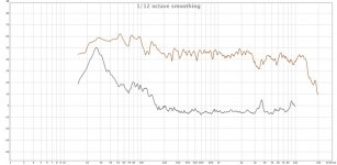

The last REW FR on my system was May 31 and here it is. Both L and R. With EQ. 1/12 smoothing. With THD (distortion). Mic where my head would otherwise be. BTW, both cone subs are about a half-century old.
This is a stupid argument: at their best (and uncommonly), ESLs can have good bass but not great bass. Anybody disagree with that?
