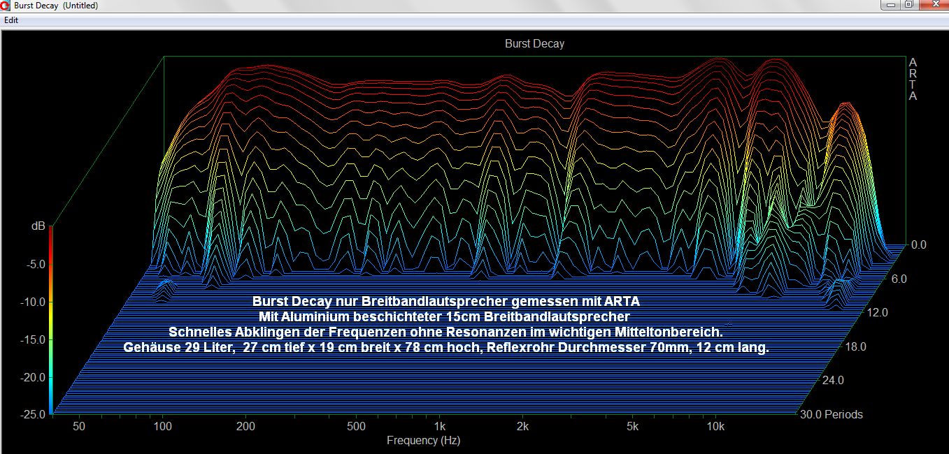

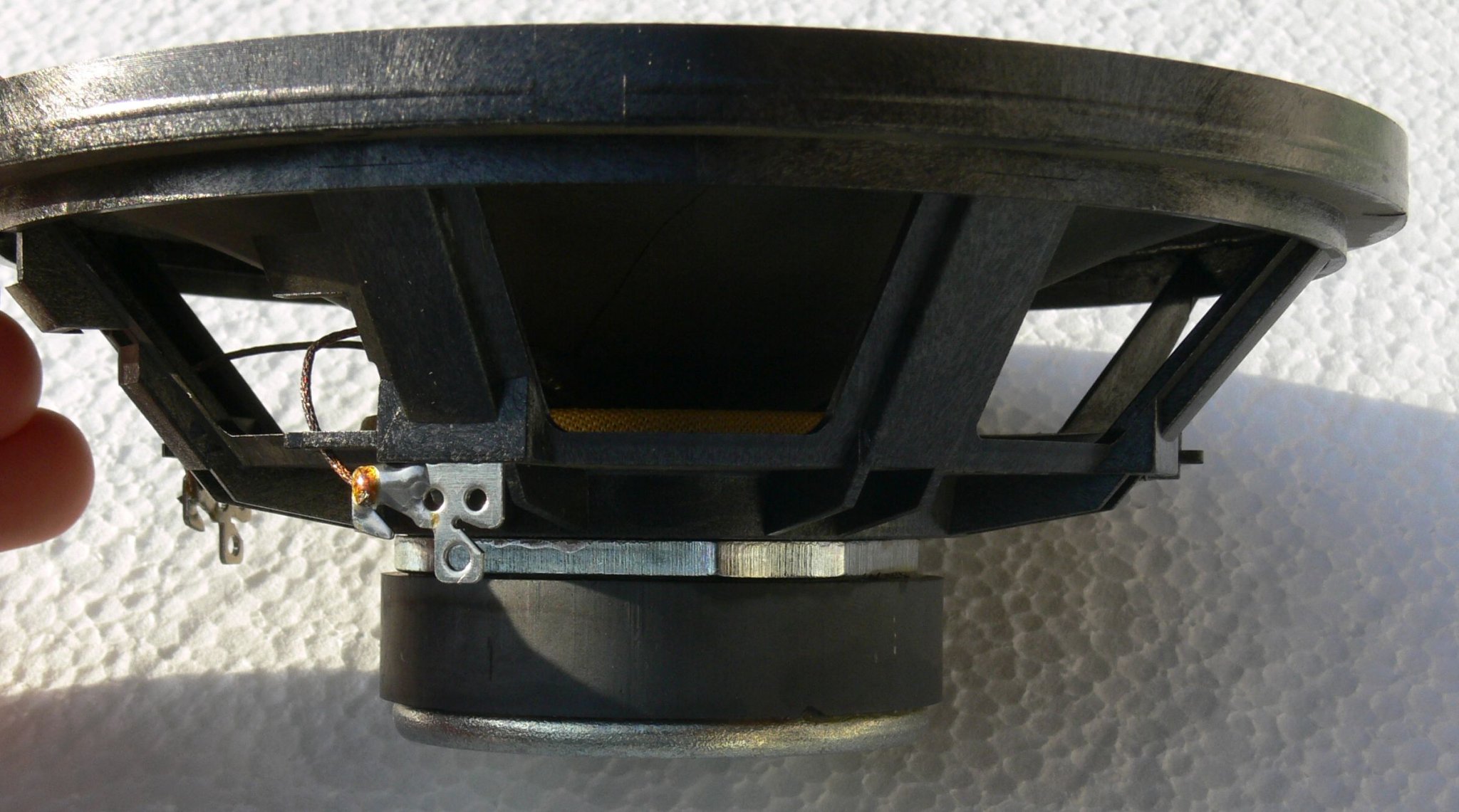

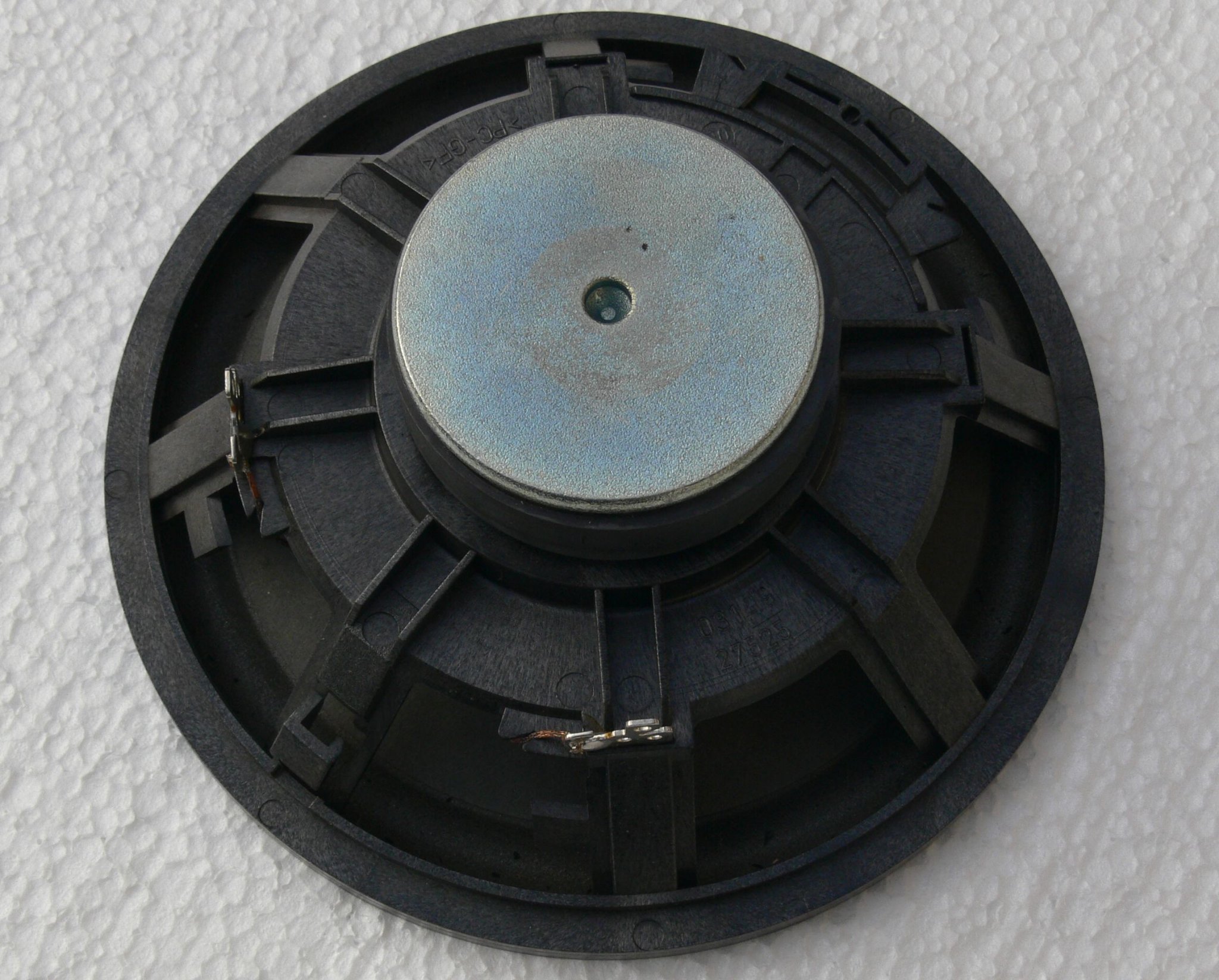

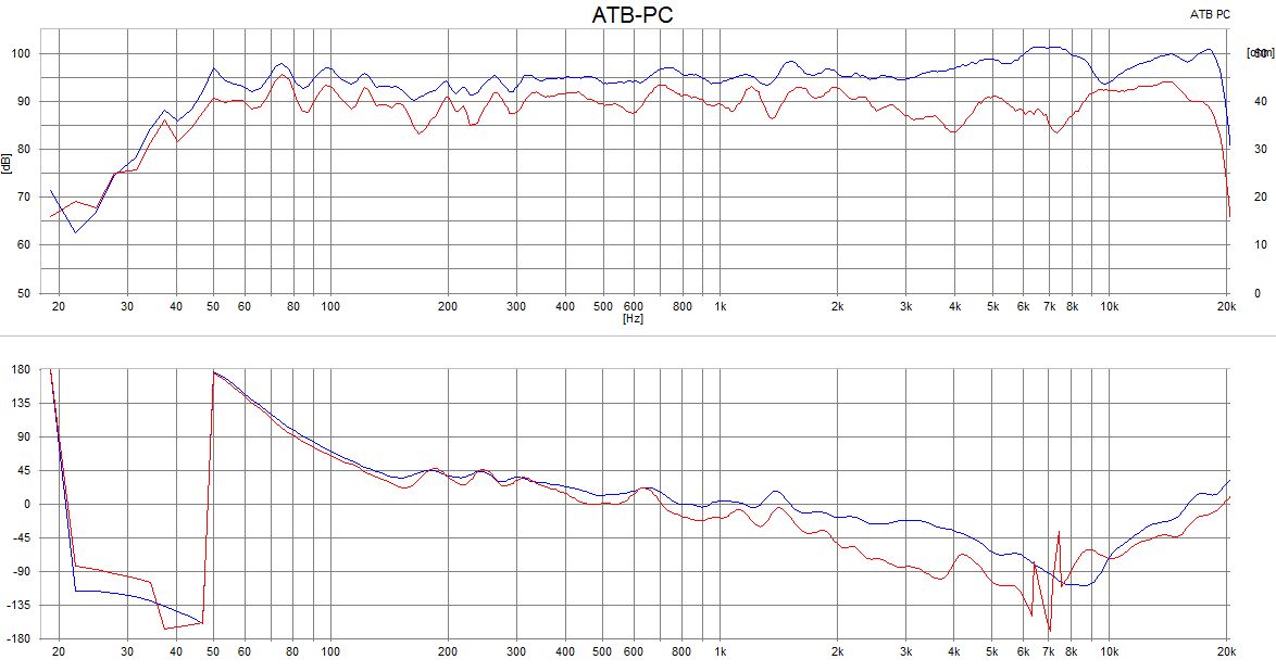

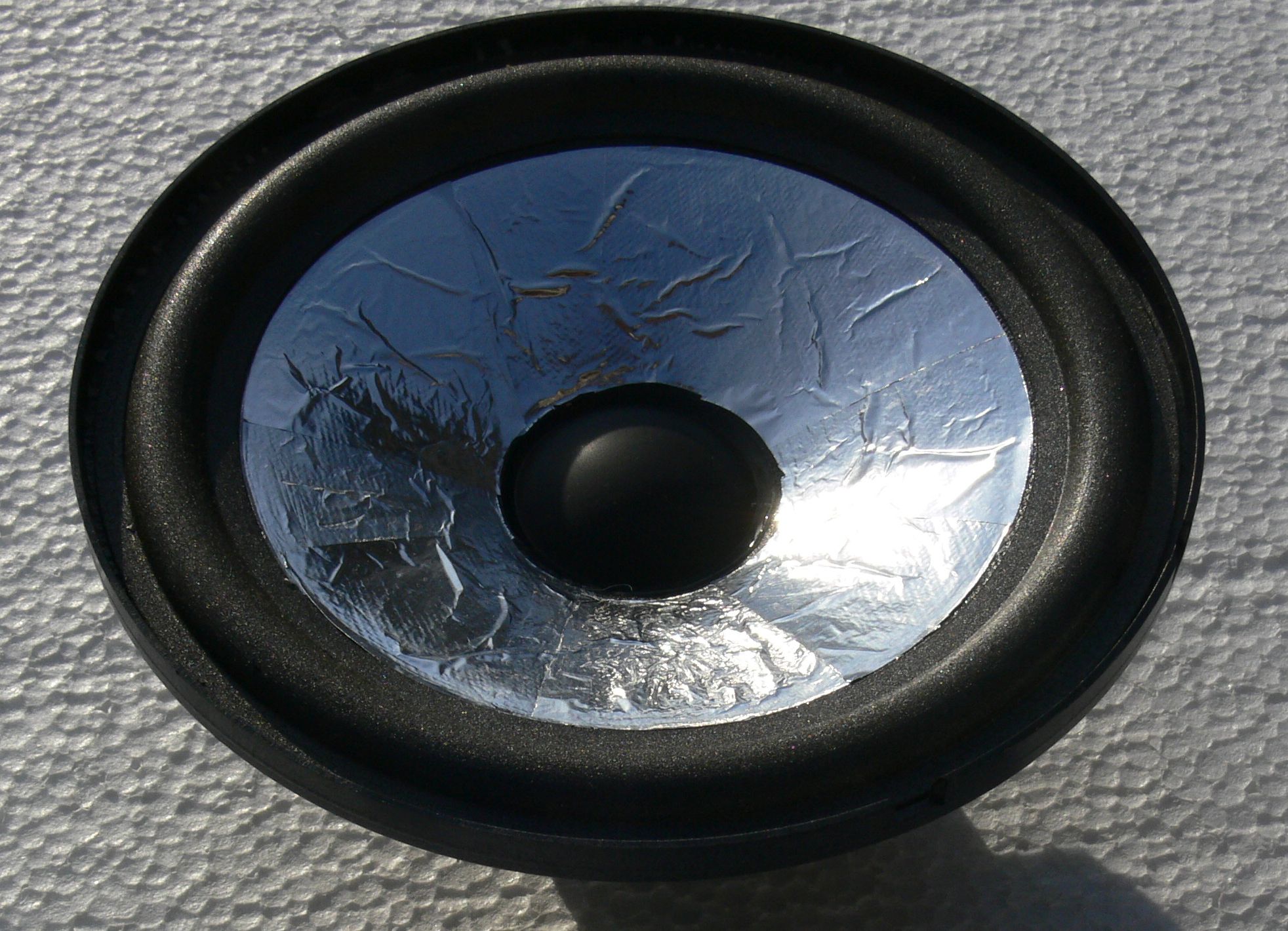

For example a simple 15cm fullrange driver which in a 29 liter reflex box made perfect sound, no crossover at all it goes up to 12khz with one sided diy aluminized paper cone (household aluminium foil and usual glue and a scissor to cut it thats all you need to do it).
Married it with an Audax like tweeter (mix of cone and dome) which works just with a simple 6db crossover to get more in the highs up to 20khz.
It sounded really really good with the box close to a back wall. Very vivid and transparent sound. Just the right amount of distortion that made listening fun.
frequency response (blue line) is with the tweeter on axis measured
red line is 45 degrees off axis (also with tweeter) - (measurements were put optically apart - measured with different voltage)
This is only an example what diy can do what commercial systems cannot compete with:
The box / enclosure I got from the bulky waste
The 15cm fullrange driver is from a bargain selling - I got the drivers for 2.5 euro each
The tweeter was also from a bargain selling 0,5 euro each
So this is a kind of "high end" speaker which I could build "for nothing".
Pretty linear, fine burst decay for such a design and it has voila a linear phase(!)
