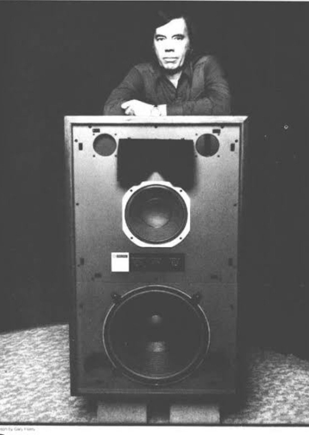

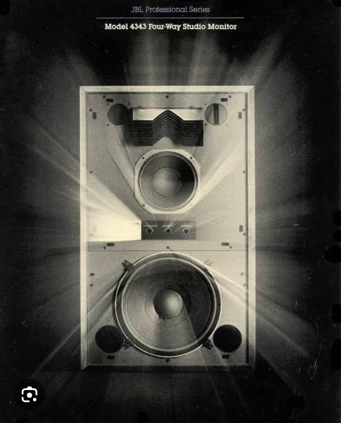

When l was about eighteen l boldly set my eyes on building the JBL pro 4343 monitor system. Three years later it was used in the Alexander theatre at Monash University by request of the house engineers to replace the Altec system for a ballet school concert. The 4343’s were then used for seven years at that event. The theatre unfolded the true potential of these monitors playing recorded music for the Victorian Ballet School. The difference between a 1970’s lounge room listening space and this theatre is undeniable.

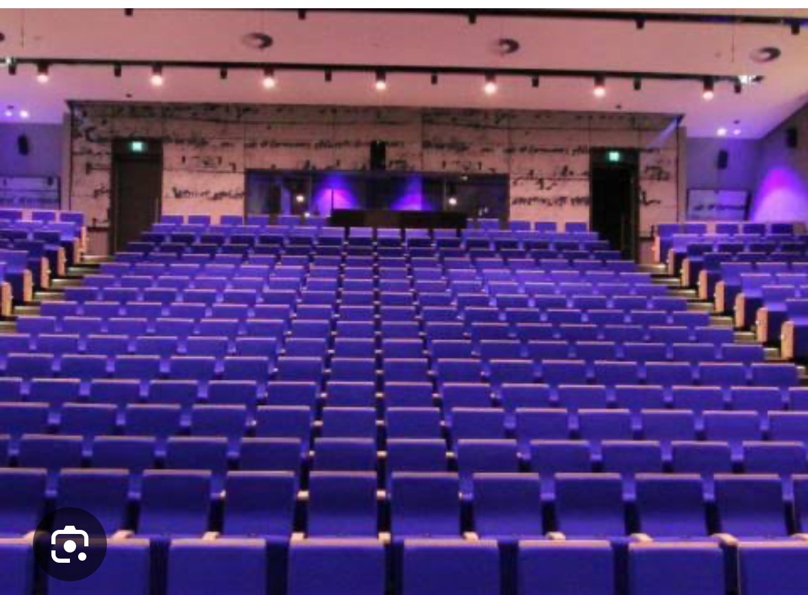

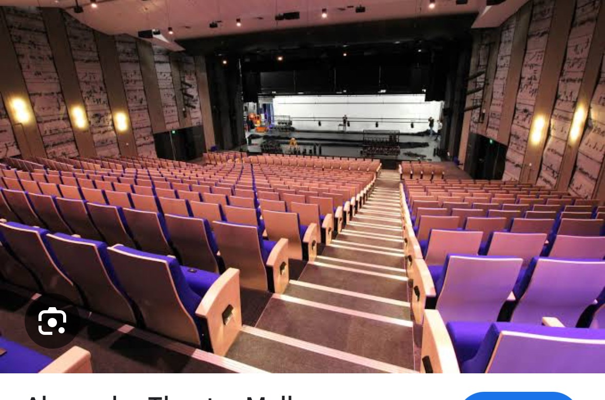

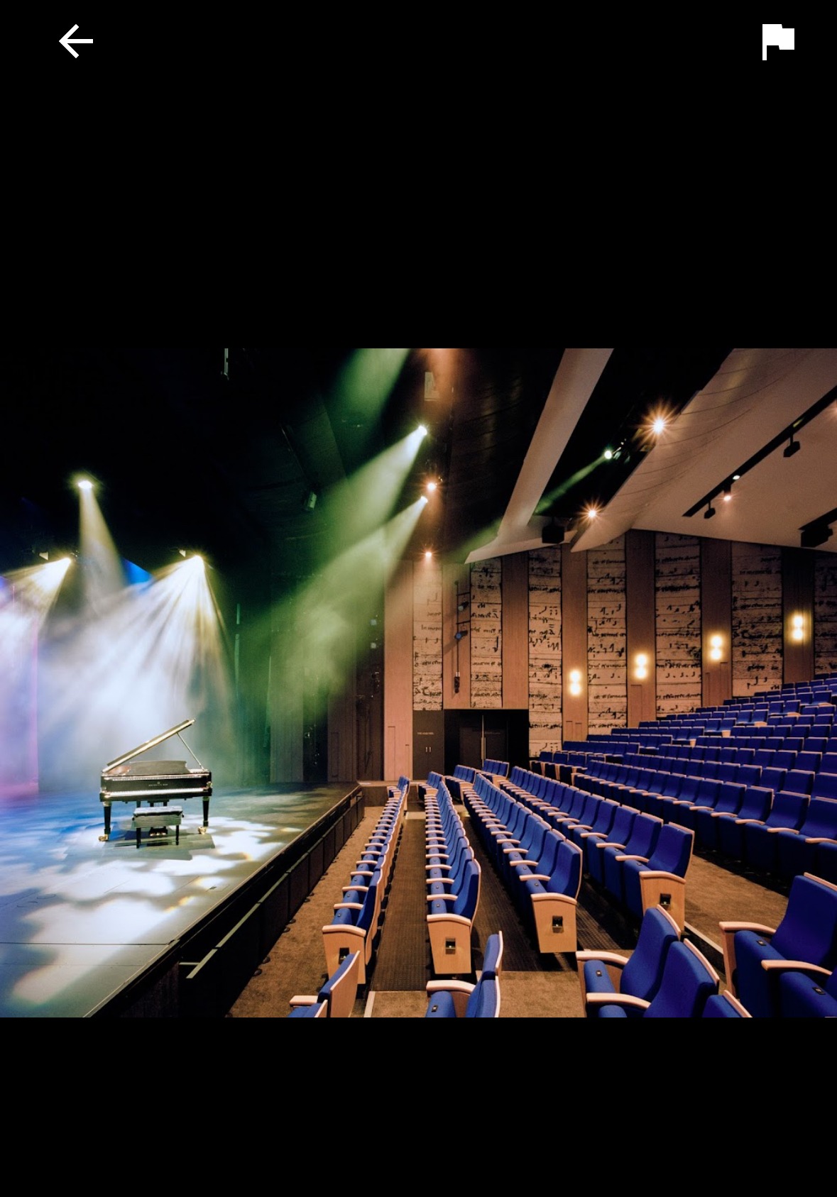

It’s said that a recorded event will never match a live in unamplified event. That is true. But a significant component of that challenge is the acoustic space in which the recorded event is being re played.
https://cleardesign.com.au/projects/mpac
