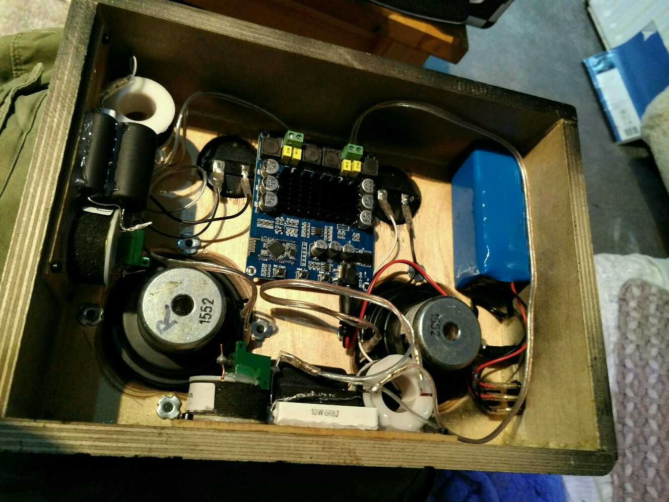

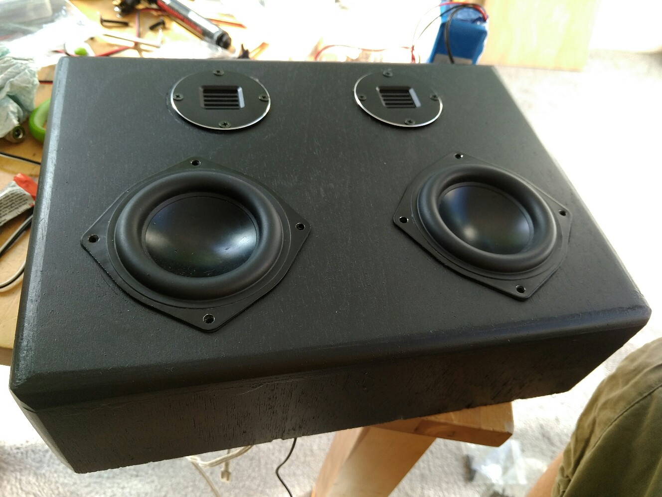

I use a Playstore app called Bass Eq which works with everything including YouTube on my phone with my portable speaker. It has a pair of ND91's, AMT tweeters and a 6.5 "Dayton PR to make the most of their big X max/ mech.
Not a stereo pair that you are looking for but the sound quality is very good.

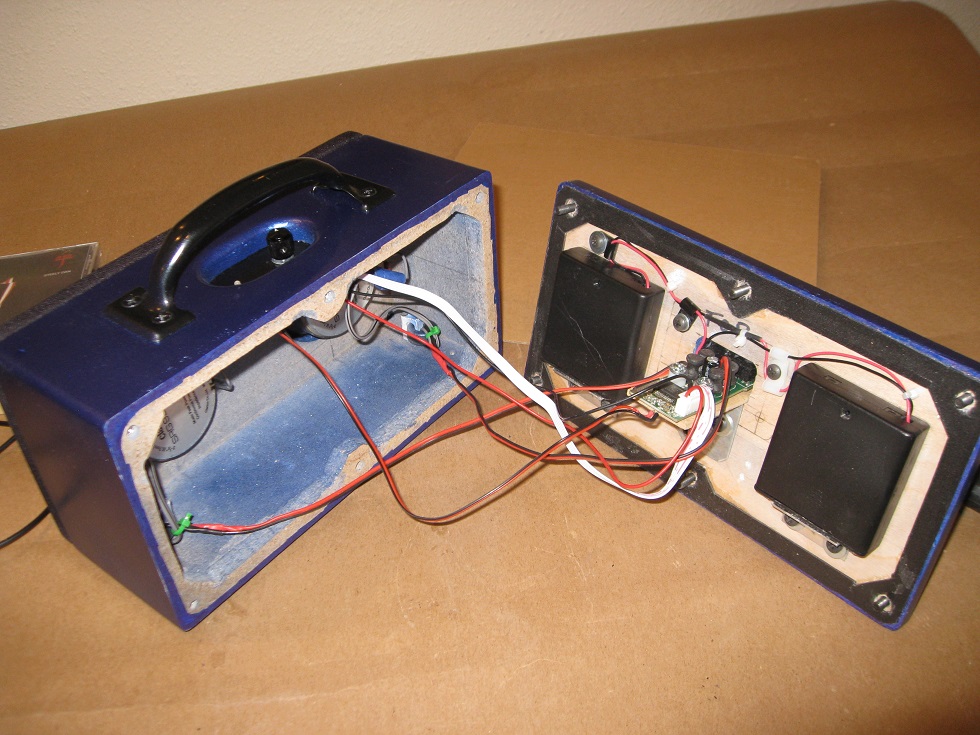

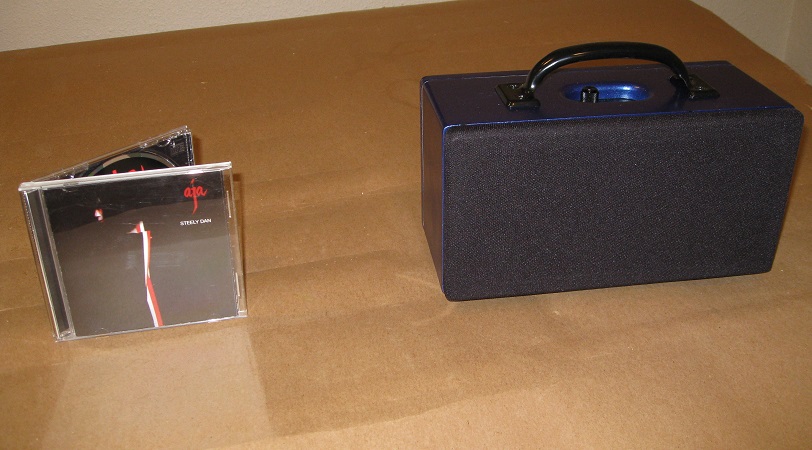

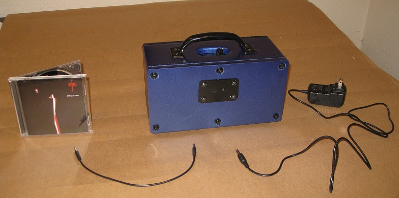

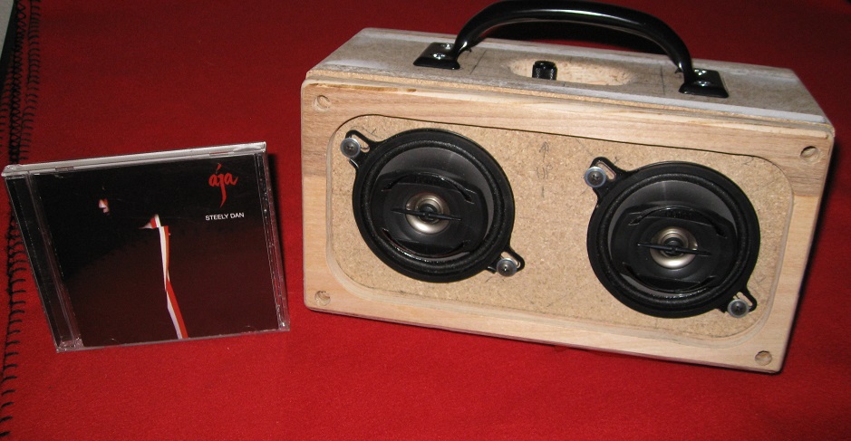

I made a small boombox using a pair of 3.5" car coax speakers, so there was no crossover needed. The amplifier board that I chose doesn't have Bluetooth, but I could buy a separate Bluetooth receiver. It runs on a 12V power supply that plugs into the wall, or 8 AA batteries. The sound quality is quite good.
There are a lot of amp boards with or without Bluetooth, different power ratings, etc. And you can find other speakers. If you want to build your own enclosure, you can customize it the way you want it.

Thanks Marty! How does stereo sound when drivers are close to each other, like in photos 3 and 4?
Dave, nice build! Thank you for sharing! Yours have two drivers. Would rechargeable batteries inside be also practical to power up a small enclosure speaker with two tweeters and two woofers all with crossovers? Would a speaker with 8 Ohm drivers play longer on batteries than with 4 Ohm drivers, or the difference is not that important compared to the other components' share?

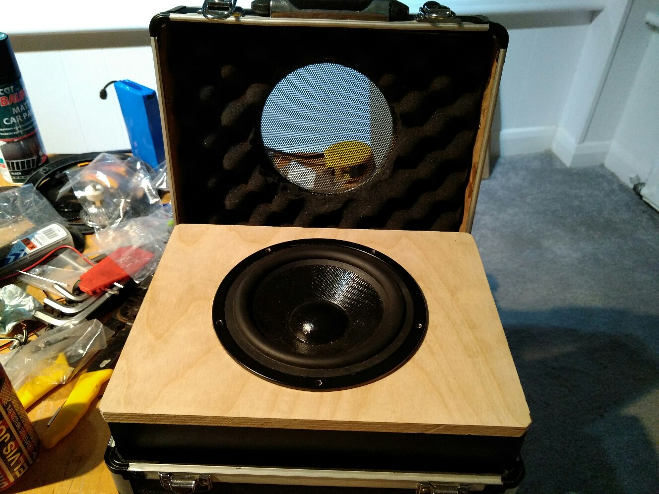

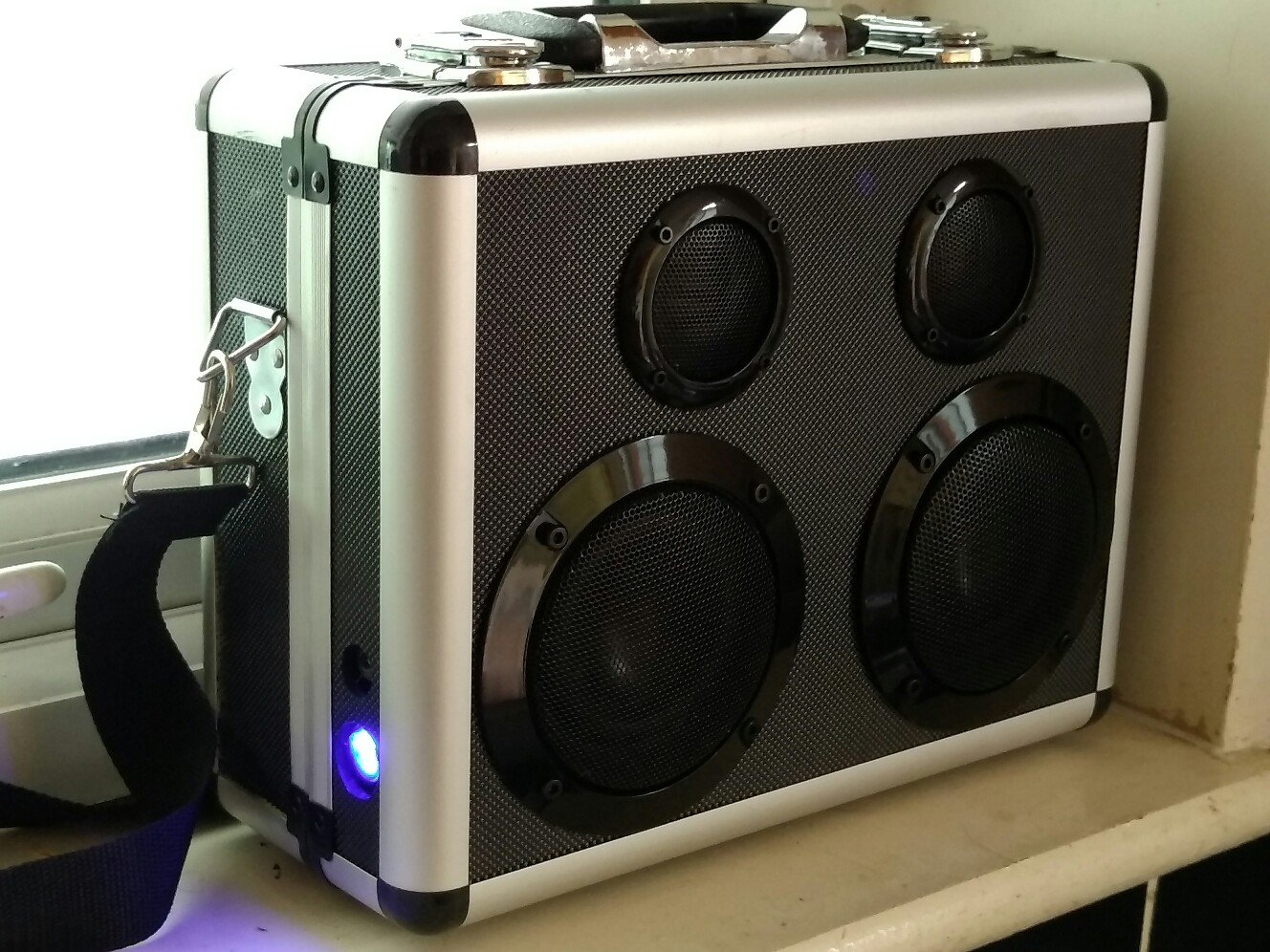

Hiya, its better to have separate enclosures for the mid bass but there's no stereo effect in my 12" wide box so I don't think I'm missing much. When I came up with my design, there weren't any suitable smaller PR"s for separate chambers. The drivers are good quality with low distortion and it goes plenty loud with bass strong to 55hz with a little help from the eq app. I used the crossover design from Tom Zarbo's 'Bantam' speakers ( check out Parts Express Tech Talk forum for loads of DIY goodness!). The Bluetooth 4 sounds great on the eBay TPA 3116 stereo amp. I've got all the parts for a 2.1 big brother with a Tang Band W5 sub as my next bass heavy project.

The amp board that I used has input locations for adding 12Vdc worth of batteries. (the leads need to be soldered to the board) However that particular board doesn't have recharging capability by itself. At moderate levels, the (8) AA batteries will run the 3.5" coax speakers for a couple days or more, before having to replace them. If the 12Vdc power supply is plugged in to the wall, the batteries are not used. The amp module that I chose was rated at 4 ohms, so I chose 4-ohm speakers.
There are add-on boards that will hold rechargeable batteries -- and recharge them. There is a wide variety of different amp module boards available to choose from, with lots of different features and wattage output to suit what you want. I don't have any affiliation with them, but Parts Express has quite a few to look through. The possibilities seem limited to one's imagination -- and budget of course .
I chose to keep the design as simple and compact as possible. It's just a little bigger than a box of kleenix. I figured it would be used mostly where it could be plugged in, and only occasionally where it needed to run on the batteries. Making the back panel removeable -- and still keep it sealed -- added complications, but everything inside including the batteries is accessible.
I am planning on making a more deluxe model later this year. My plan is to incorporate Bluetooth and rechargeable batteries, along with a few other features that I've been thinking about. Haven't got that far with that one yet.

Thanks for all the info Marty! Yes, great resource for a beginner! Do you mean that you have to tweak the values of the inductors/caps/resistors in the crossover for your particular drivers? Or that wouldn't change the sound much?
Hiya Harum, my design uses (almost) the same drivers as Tom's Bantam so I borrowed his xover design and it seems to do a good job. It wouldn't work with different speakers. I use a 24v Lipo rechargeable battery I got from Aliexpress. Lasts well (at least 10-12 hours loud!)
