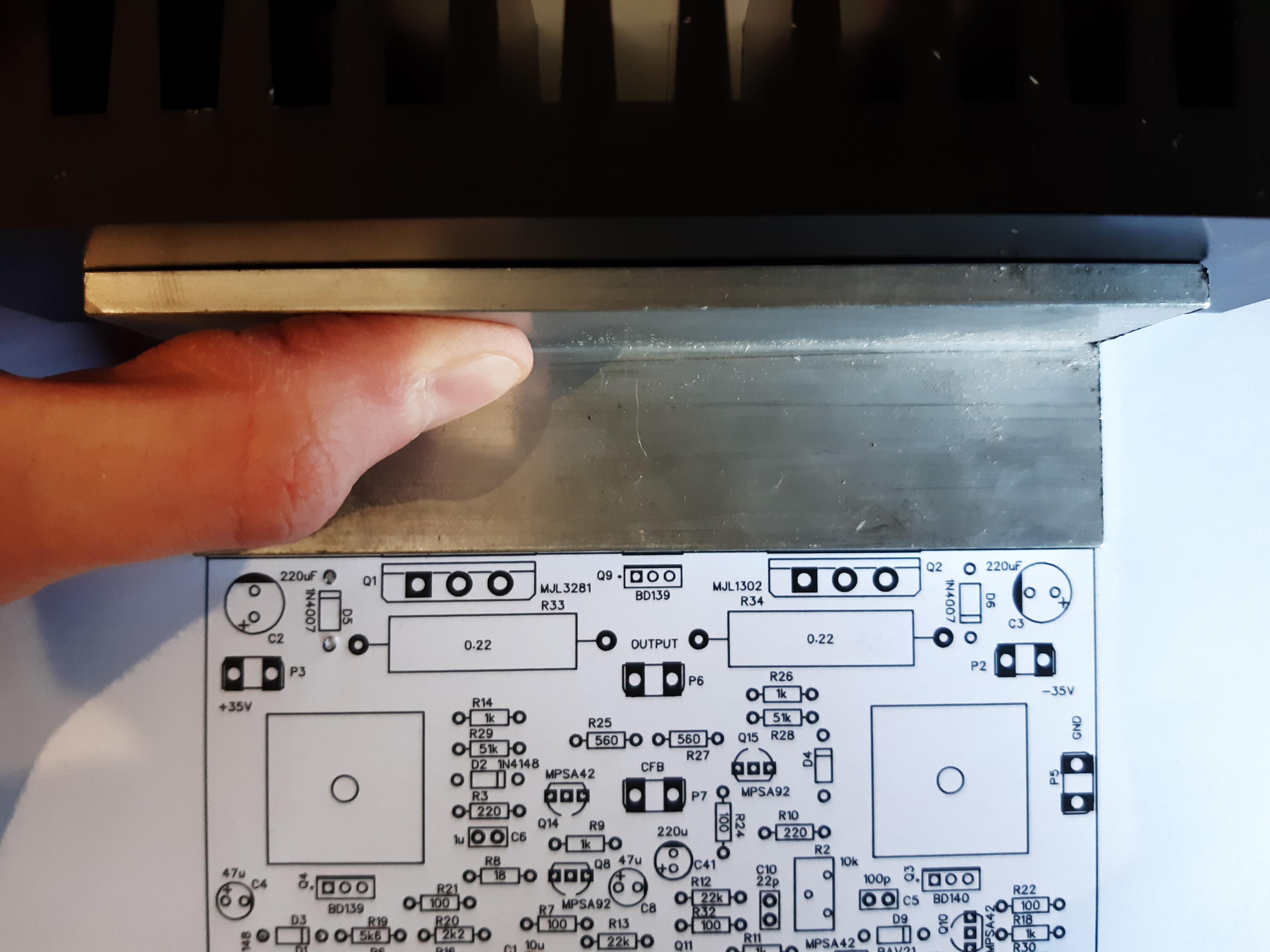

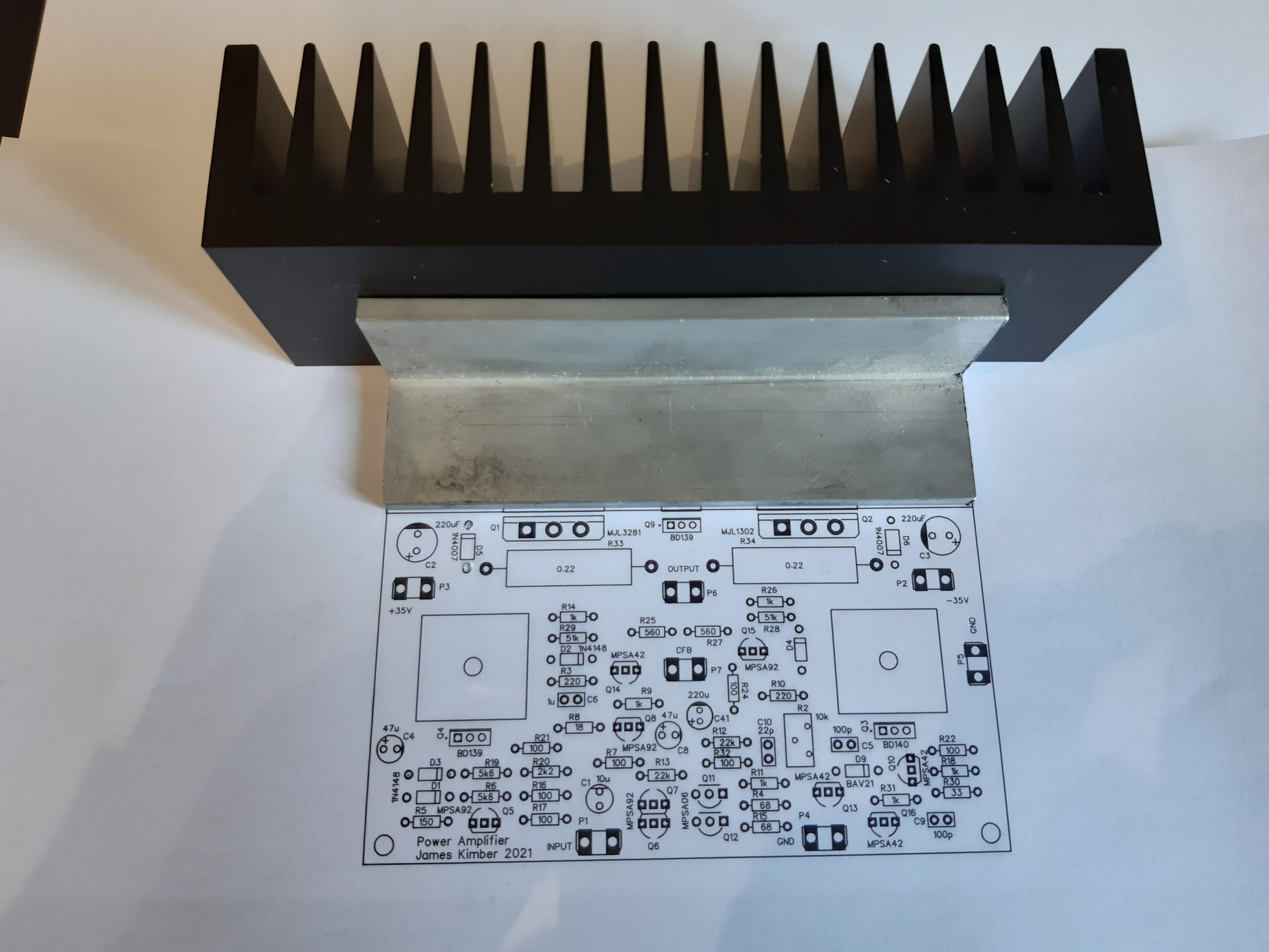

I've just received a heatsink for an amp I'm building (main thread over in Instruments and Amps, I split this here because it's a more specific problem) and the surface isn't flat. There is a slight concave along the width which means the aluminium angle won't mate properly. I've attached pictures of the problem.
The question is, how usual is this for heatsinks? Can I expect to return it and get a flat one or are the odds that that will also be curved? Should I just take it to a machine shop and have them skim it flat?

Extruded heatsinks are often warped like that, but that is worse then most.
It is fairly common to need to take a face mill (or fly cutter) to the mating face of a heatsink to actually get good flatness, the raw extrusions are seldom good this way.
You can buy heatsinks that have had the face milled, but you pay a bit of a premium for them.

Do you think I should ask for an exchange then? It came from RS.
RS are usually a good reputable company.
I can only guess this one slipped their usually good quality standards.
Given it was described as a heatsink then it should be fully flat or its pretty useless.
Ring their customer support and ask for a replacement.
They are usually very helpful. I have had things missing and they have another one in post next day.

2 mm quite a lot, would you mind inform us what brand and model the heatsink is?
Don't even think of fixing it or force the L-profile flush with the heatsink as that would require much more than 3 bolts and could potentially warp the perpendicular part of the profile onto which you would attach your transistors to creating even more problem, you should definitely get that sorted out with RS.

Thanks for all the replies! This is the heatsink:
SK85-50-SA | Heatsink, Universal Rectangular Alu, 1.3K/W, 50 x 160 x 40mm | RS Components
I'm going to contact them tomorrow and ask to exchange it. If that one still isn't flat, I'll have it machined flat.

I think its a cheapo chinese extrusion - I've got one like it, I think from eBay. Its flat enough for discrete transistors to mount, but will need facing on a metal mill for anything larger, its about 0.5mm out in the middle.
No, hand sanding isn't the way, milling is the best way to correct such a surface, a power belt sander might do at a pinch (but remember a sanding belt clogged with aluminium dust must never be used on rusty steel - thermite reaction).

Read PRR's Post - His answer is the one which works.
I think, PRR has the best answer from all these who have posted.
As you deal with only two Transistors there is no NEED to use that L-BAR. Mount the Transistors direct on that heatsink so you can save yourself a lot of Time, Troubles and Headache and last but not least, TIME. and possibly money.
If the HEAT SINK is larger than the PCB * from the Pics I see in your post PCB seems to be smaller than the heat sink*, then just mount it on that Heatsink and the Transistors also. Better heat Dissipation and smaller build.
But this is all up to you..
