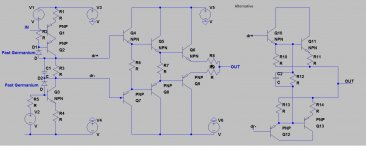

That is correct. Thus to the designer the objective is to keep all "solid state" elements out of saturation. In those old days if someone wanted it really fast he had only one choice: emitter coupled logic. This always operated in linear region no saturation.
Here a "broadband topology"

My simple view is based on the fact that if you cascade amplifier stages then the cumulative effect is to give the lowest bandwidth. So if a disk is played with 20kHz BW then a 20kHz amplifier is going to seriously limit its performance. Therefore I tend to design to 10x BW (200kHz) which is possible. For 100W amplifier into 8 ohms that means 50V/us, but I can't tell much (any?) difference with 30V/us. Not tested anything less, since 30V/us is quite easy to achieve too.
I don't think speaker systems for 100W will put 100W into the treble unit. The crossover networks usually attenuate the HF - depending on the tweeter design of course.
ok but is BW full power BW or "half power"? To put in perspective....a tube amp is internally pretty much faster than semiconductor but the transformer for 200 kHz full power BW is a luxury you cannot afford. I am not an expert in tube amps but learned the Williamson amp had been equipped with a rather sophisticated transformer but its power BW ...i guess certainly not above 20 to 50 kHz at a very high price. And yet there are few if any complaints that much less sophisticated tube amps limit performance of standard compact disk in any way. I think the 30V/us answers the quest for "fastest audio amp".
You make a good point about transformers. I'm not sure a 200kHz wide-band transformer is possible (unless using ferrite - then LF disappears) let alone a luxury. Sowter's best designs, last time I looked, were maxing at around 100kHz, only better with mumetal; higher power units were generally 40-80kHz. It does appear, though, that tube amps seem to deliver the goods without too much trouble.
