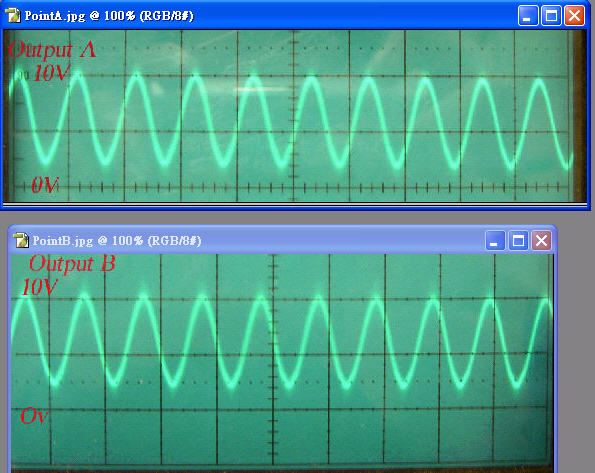

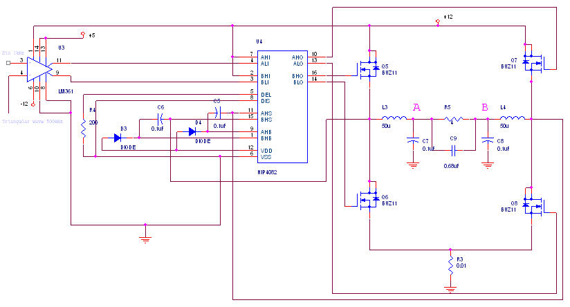

I just make a simple class D amp.
But their is always an offset voltage(7V) at output A and output B.
This make me sad.
What way can I eliminate this offset?
Or...may be my design is wrong?
Or ...need make a change on any part of the circuit
thanks
schematic attached
****two waveforms at output A,B ********

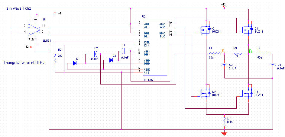

I think you're design is a little off.
L1 and C3 is a filter for one half of the bridge, and connected properly. Then you've got your load connected from that, directly to the other side of the bridge, and there's your mistake.
R3, your load, should instead connect to the node in between L2 and C4, this way it is filtered from both sides of the bridge.

Ah yes that's a good point.
However it could all be referenced to a negative rail instead of ground, which would put the outputs near ground potential instead vsupply/2.
I think this method is prefered for safety reasons, the outputs don't sit at a high voltage. Other than that though either way works.

Hi Chris,
Your idea would complicate control circuit a bit. With zero signal, both lower fets should be on all the time. With input signal, one leg would stay on all the time while on the other duty cycle of lower fet would be decreased from 100% to 0%. This would require two PWM comparators and offseting ramp or reference signal for each one. The main problem I see is crossover distortion at small input signals if run open loop.
But there are some designs using above control metod in PFC circuits, where you can get rid of input bridge rectifier.
Best regards,
Jaka Racman

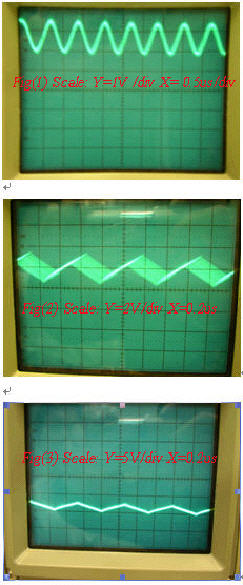

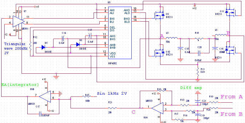

During testing, I choose that circuit (picture)as feedback
Figure (1) is shown the waveform at (C) when only a diff amp was connected to A and B.(EA ,comarator were disconnected, signals provided function gen.)
After, EA and Comparator were added.
Fig(2) is shown the waveform at negative input of EA.
Fig(3) is shown the negative input at comparatorLM361.
Both fig(2)&(3) were failed to get the proper input to LM361 which need +/- 5V input signal applied.
I replaced R15 with 1.5K but the negative input at LM361 nearly the same as Fig(3). The DC offset was still around -8V. The sin wave always seem disappeared.
I am quite confused.
What is the principle of feedback using diff amp (why need do that way? I build this feedback just by reading information searching from webs and old posts and some hand calculations ¡Kbut I still cannot really understand ¡K )
Also what is the role of EA in this case? What should be possible correct signal at negative input of EA?
More important¡K
Subwo1 mentioned that ¡§The best way I know to eliminate the chance of it is feedback referenced to a fixed point between power supply rails.¡¨
In both fig(2)(3), there always a dc offset. I am afraid ..How the feedback cirucit can eliminate the dc offset?
How can I change the circuit(feedback, ..,even power stage)?

You should measure the offset between A and B. As already mentioned, with a single rail you will of course have a DC offset. Ideally it should be 6V with 12V rails, but you haven't added a "virtual" ground that would serve as a reference point.
It could be achieved by biasing the +input of U9B to +6V and feeding the input signal via a capacitor, maybe.
