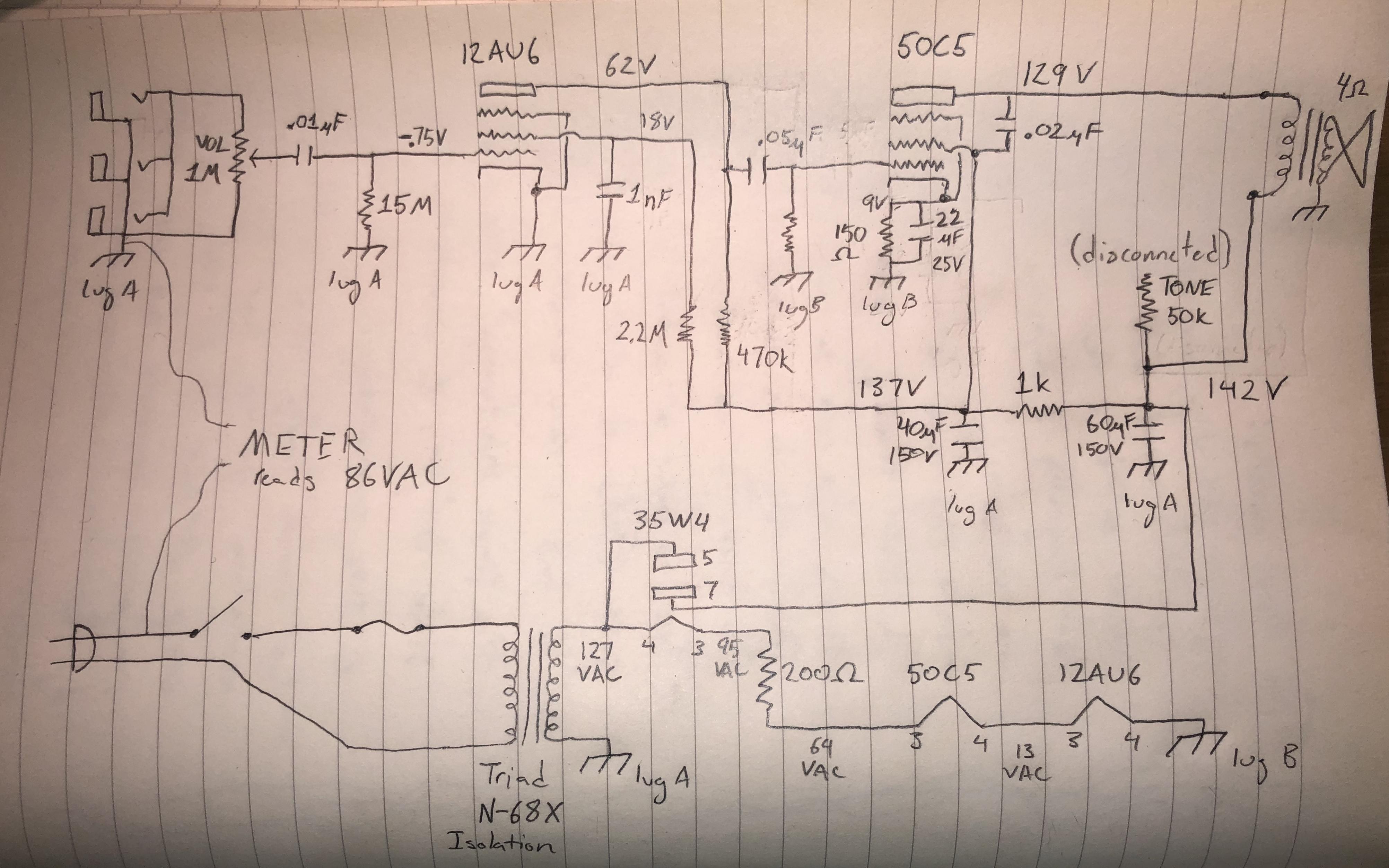

Okay, finally got a chance to make a sketch of the project I was actually working on when I noticed this phenomenon. This is an old Knox Model 602 series-filament widowmaker that I'm trying to make safe & reasonably quiet. I've added an isolation transformer and removed the original floating ground and death cap setup.
I was trying to verify that I had the wiring of the isolation PT correct when I originally discovered that my multimeter reported significant AC voltage between the chassis and both the hot and neutral wires from the wall. Went and checked the 5f1 and another amp and immediately found similar behavior with those. Here I've shown my measurement tonight between the line and the chassis ground: 86VAC.
Does the ghost voltage idea still make sense in this setup? Does the schematic look like the right way to wire an isolation transformer?

Great, that's exactly what I intend to do. I was honestly worried about making this connection because I understand safety ground is connected to neutral somewhere in the building and I'm reading voltage between chassis and neutral.

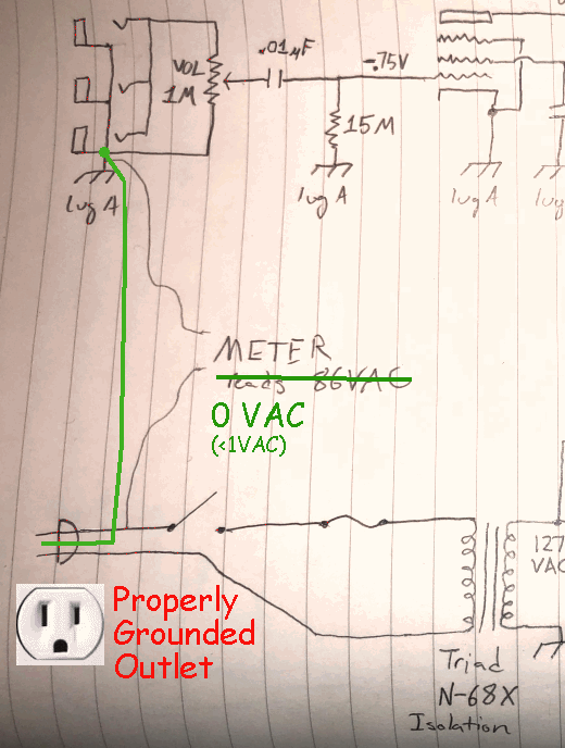

I'll run an extension cord from one of the few grounded outlets I have and verify that it doesn't blow the fuse, and the meter reads ~0VAC.
Ran an extension cord from a grounded outlet. With the safety ground connected, chassis to hot wire from the wall measures 120VAC, and chassis to neutral measures 0VAC, on both the 5f1 and the Knox. My lightbulb current limiter remains nice and dark, so I infer that there isn't any significant current flowing between the PT secondaries and ground to establish this reference. So that mystery seems to be resolved. Thanks for your help!

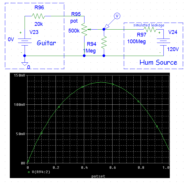

Here's a simulation of this effect, which should be familiar to any guitar-amp builder.
Because of sim stupidity, I have modeled with DC. The "100Meg" impedance represents typical leakage from a hum-source to pot wiring. (Approximately 3pFd at 60Hz.) Turn the pot zero to max. The leakage increases from zero to half-resistance, then falls off at max.

This turned out to be a great chance to learn what happens when screen voltage is insufficiently stiff. It dropped easily with even a little signal, and the result was a slightly distorted, compressed sound. A 10uF cap from screen to ground made the screen voltage stiffer and cleaned up the sound. It now sounds better to my ears than it did originally with excessive screen voltage.
So, old design was rectifier output to a 60uF cap for B+, through a 1k resistor to a 40uF cap for B++. Now I have an additional 10k resistor and 10uF cap for the screen... B+++, I guess. Does this design seem reasonable? Would I be better off sticking with a single dropping resistor and less total capacitance?
Second question: I found someone's instructions online for adding this same isolation transformer to an amp with a very similar circuit. Unlike some other posts I've read, he recommends adding a silicon bridge rectifier before the 35W4 to use both halves of the AC waveform, because of the load put on the transformer by half-wave rectification. Is this really necessary? My math says it's not, but maybe I'm doing something wrong:
Transformer is rated 50VA, 435mA. AC heaters use 150mA and I assume I should take that off the top. The remaining 435-150=285mA, times 0.28 per Hammond recommendations for half-wave rec is 80mA. Adding up the highest quoted max-signal values for plate and screen currents in the 12au6 and 50c5, I get 74mA, which I infer should be about the max DC current draw (and actually I think the 12au6 is running pretty cool vs. datasheet specs). Am I missing something, or just this transformer just barely able to handle this amp?
In practice, the transformer doesn't get hot from use, though maybe lukewarm or maybe that's just the nearby tubes warming it up.
First, I realized that my 50C5 screen voltage was too high at 137V. Data sheets variously give a max of 110 or 120V. I guess the problem was that the output of my isolation transformer on modern power is around 127V, more than the amp was designed for.
To fix it, I first considered a resistor on the AC input to the rectifier, or increasing the 1k dropping resistor producing B++, but I already had most of the voltages in the amp about right (maybe 10% high). Finally I settled on a small 33Ω resistor on the AC input to get most voltages right where I wanted them, and a 10k resistor on the 50C5 screen to get to 110V.
....the highest quoted max-signal values for plate and screen currents in the 12au6 .... actually I think the 12au6 is running pretty cool vs. datasheet specs).....
Obviously this AU6 is not running the 10mA-15mA on the datasheet. It has a 470k plate resistor, so even if the tube were flat-short it could only pull 0.3mA; to "work" it must be pulling ~~half of that.
When a voltage-amplifier is *choke* loaded, as in an RF/IF amplifier, best gain comes at HIGH current. The datasheet guys like those numbers.
When a voltage-amplifier is *resistor* loaded, as in most audio amplifiers, best gain comes at LOW current. Limited by the load of the next stage. The fall-off of Gm with current is not as much as the increase of gain with bigger plate resistor.
I would not panic running 50C5 G2 somewhat over the book values. It's a soft limit, and 50C5 are still very cheap. However if 10K gives a good drop, do that. There is some loss of gain and max output with such a large resistor; as you found a capacitor will smooth it out for speech/music and even e-guitar (with some "bounce" on overload transients). If you were trying to build a stadium-blaster, there might be some better optimum; but you didn't pick a 50C5 to blast stadiums or even tiny clubs. It's a big bedroom amp and I doubt a tenth-Watt more or less really matters.
Don't put a bridge rectifier in there!! It can be done but with the confusing "ground" connections in a cheap amp you are very likely to get it wrong and blow it up. Cleanliness suggests losing the bottle rectifier, running both plates and heaters off a FWB... but all the voltages will have to be dropped and the ~~15W of excess heater power means a resistor bigger than the 35C4 bottle. Leave it be. As you figure, the PT is not so close to its ratings that the half-wave underutilization will hurt much. Add filtering if needed for 60Hz hum, e-caps are cheap today. While you might stick to 50-60uFd first cap for rectifier stress, you could then go 150r 10W to a 470uFd second cap to feed OT, that will be very clean.
