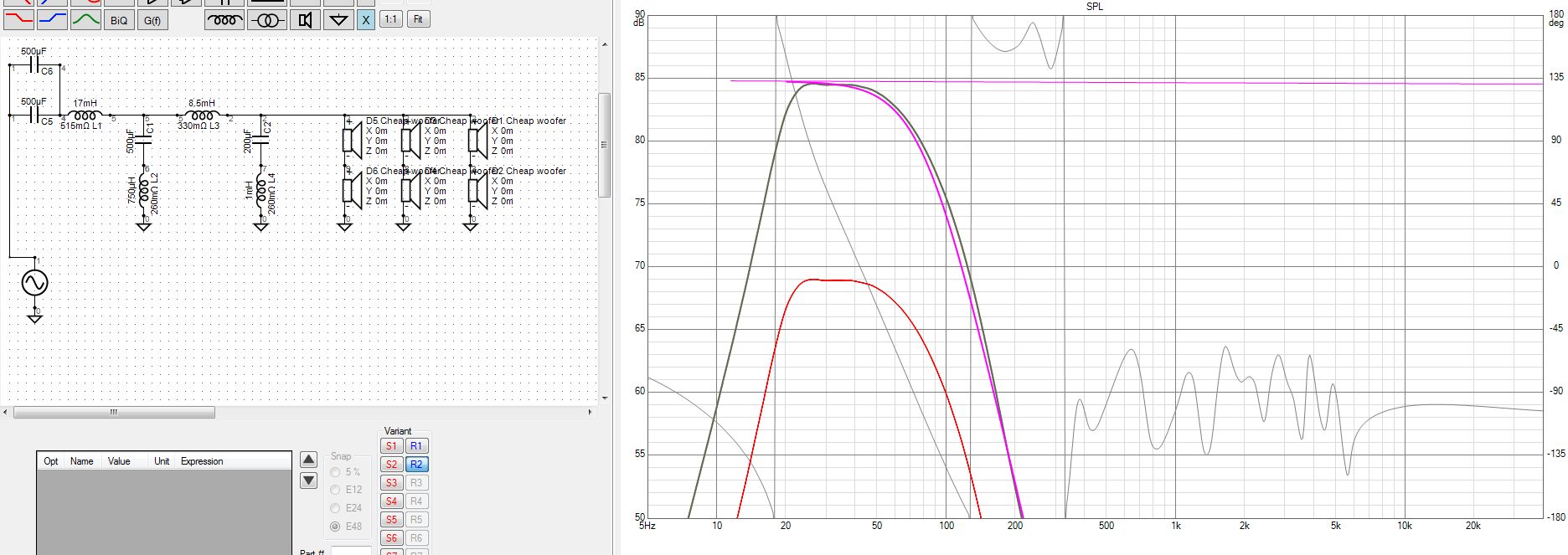

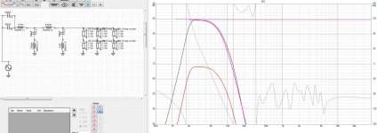

How many things are wrong with this proposed/crossover design?
Even using Non-Polarized Electrolytic for cost reasons, this would be an expensive circuit.

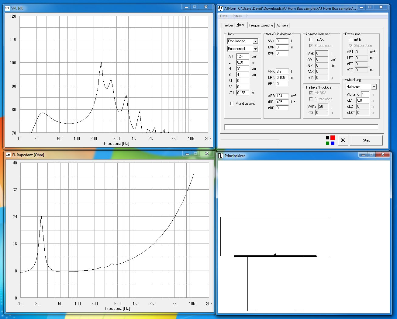

This would be a six 12" woofer setup in a stacked Ripole/Linkwitz fashion, cone to magnet with an overall height of about 30". Total cone area equals ~ two 21" woofers.
Woofer enclosure was modelled in AJhorn 7.0 for one woofer. Impedance and frequency response were copied to VituixCAD where the crossover circuit was "designed" (<- a term I use very loosely). I was shooting for an LR4 at 75Hz.
These are very cost effective high QTS woofers (QTS=1.3) and efficiency was thrown out the window in favour of frequency response.

I'd skip the passive crossover and do something at line level, before the amplifier.
You could probably grab the following:
- Behringer NX3000D
- Cables needed to split signal out of the current system
- Silent fan
... for the cost of the crossover parts.

Acoustically an extremely inefficient system. I don't know AJHorn program, but looks like it is showing something like nearfield response of the "frontside" only - forgetting the backside radiation leaking to the "room".
This kind of systems are extremely difficult to simulate even in free-field. The backwave leaks out through a chamber too, the opening of which is somewhere (down in the simulation picture). Because of the long wavelength, soundwaves will eventually start cancelling/summing depending on pathlength and frequency. When we put this thing in a room and perhaps even on the foor and near a wall, everything changes again...
How about making a quick and dirty particle board proto and measuring it?
