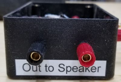

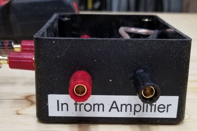

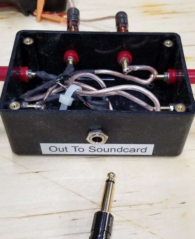

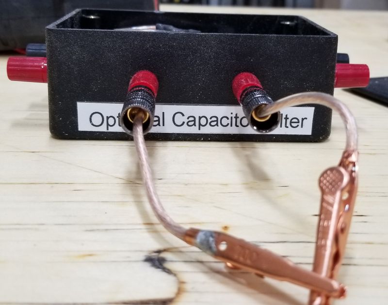

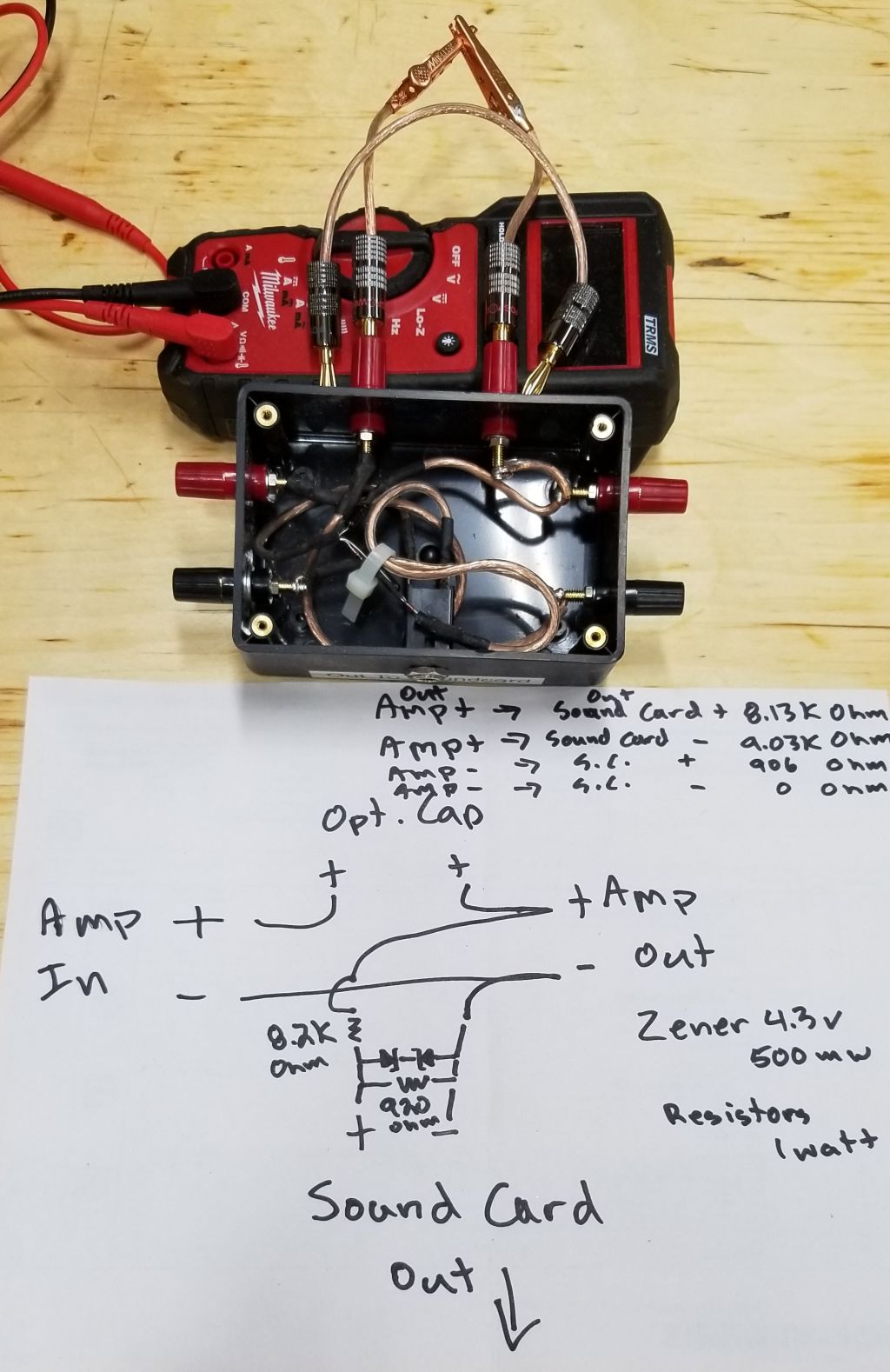

How does this Arta Voltage Probe Look?
Joined 2018
I am still not 100% if I picked the correct parts as there are so many options beyond what the Arta voltage probe diagram mentions.
Diode I used,
PART: BZX55C4V3-TAPGICT-ND
MFG : Vishay Semiconductor Diodes Division (VA) / BZX55C4V3-TAP
DESC: DIODE ZENER 4.3V 500MW DO35
Blocked
920 Ohm resistor I used,
PART: A129366-ND
MFG : TE Connectivity Passive Product / H4P910RFZA
DESC: RES 910 OHM 1W 1% AXIAL
Blocked
8.2K Ohm resistor I used,
PART: A129365-ND
MFG : TE Connectivity Passive Product / H4P8K2FZA
DESC: RES 8.2K OHM 1W 1% AXIAL
Blocked
Does it look okay?
Thank you,
David.
