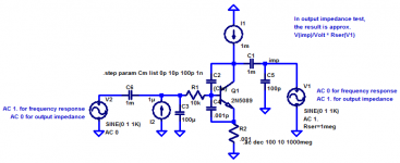

How does pole splitting works ?
Hi friends please help me on this...
I want to know how exactly modifying the value of Cfb1 in the circuit raises the second pole to a higher frequency..
As the circuit involves two poles...
The first pole is due to the feedback capacitance and the second pole is due to Rout1 and Cin2..
now since increase in value of Cfb1 increases the negative feedback which decreases the gain and the output resistance (Rout1) of the first stage, which further increases the second pole to a higher value ..much higher in frequency...
So how does decrease in the value of Rout1 due to Cfb1 shift the second pole to a higher frequency...
I need some intuitive explanation....
Thanks!!
source:Music and Audio Electronics
The pole due to Cfb1 does not shift to a higher frequency. It becomes lower - a lot lower and becomes the single dominant pole. Hence pole splitting - one goes way down the others go way up. You sacrifice one that you can control to effectively remove the ones you can't. Those other non-dominant poles are often ill-defined - they depend heavily on output stage bias, output voltage, output/driver transistor beta (which isn't constant),and load (which is highly complex).

Yes, Rou1 and Cin2 form a low pass filter.
p2 =1/(Rou2 * Cin2)
Also do you understand the feedback theory? And why Rout1 decreases when we apply a negative (voltage)feedback?
The situation looks like this:
Without the feedback Rout1 = Rout1, but as we add an negative feedback across the amplifier the Rout1 will decreases to the new value
Rou1 = Rout1/(1 + |Av|) this is true for the case of an infinitely large feedback capacitor Cfb1.
The time constant associated with Cin2 therefore changes by a similar ratio, moving to higher frequency as the feedback capacitor (Cfb1) increases.
In the limit of very large Av and Cfb1, the output resistance approaches Rou1/|Av|. Furthermore the output (Cin2) and input capacitors (not present here) are essentially shorted together in that limit, leading to an output pole of p2 = 1/[(Rou1*Cin2)/|Av|].

Here's something to play around with in LTspice. It's the first stage, with a capacitor simulating second-stage input impedance (and giving the resulting second pole).
attachment.php
You can see how the first pole (associated with the transition from constant high impedance to first-order dropoff at low frequencies) is shifted to the left as Cm is increased. The second pole is associated with the dropoff after the second, higher-frequency shelf, and that gets shifted to the right as the impedance shelf moves down.
