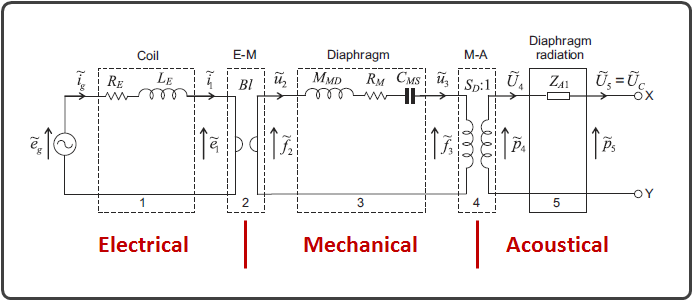

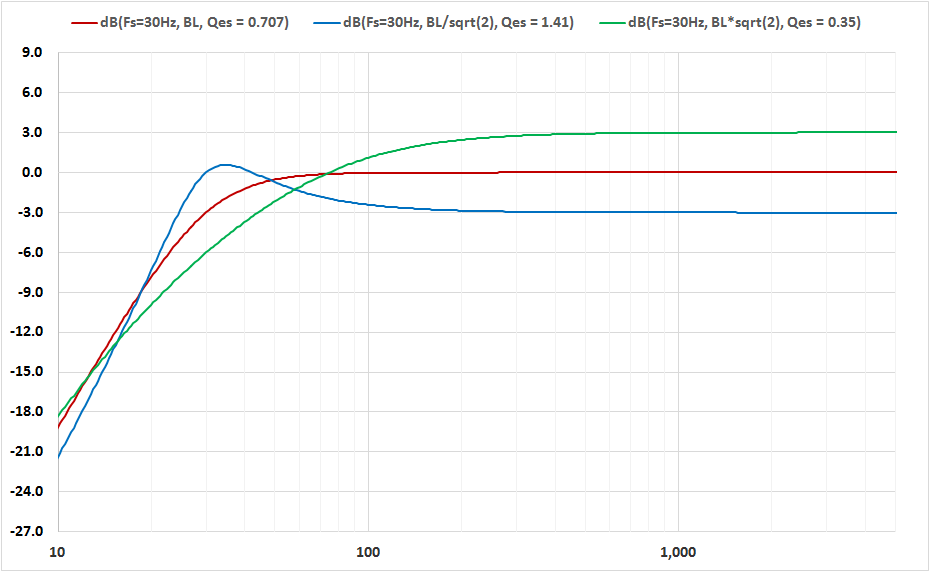

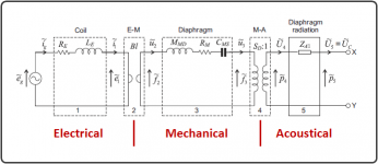

Most modeling software (including Hornresp) use a lumped parameter model for loudspeakers where BL defines the transduction coefficient between current(electrical domain) and force(mechanical domain). Keeping all other mechanical and electrical parameters the same, if you increase BL by a factor of sqrt(2) = 1.414, Qes will be halved and mid-band sensitivity will increase by +3dB; reduce BL by sqrt(2) and Qes will be doubled and mid-band sensitivity will decrease by -3dB.
Plots often aid in understanding interrelated trends like this. For illustrative purposes, let’s assume a woofer with Fs = 30Hz operating in an infinite baffle, and mechanical damping is extremely high so that damping is completely dominated by electrical damping(Qes) which was set to 0.7071 by initial choice of BL. Then BL is factored up and down by sqrt(2).
Regarding transient behavior, what exactly are you interested in? (impulse, step, burst,…etc).
All types of transient behavior is directly tied to the frequency response of the woofer.
