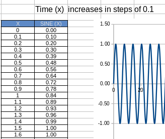

In the last graph created by the spreadsheet, I had increased the time (x) value by 0.5 each time. This time I have set the increment to 0.1, which means a higher sampling rate of 10 times a second as opposed to twice every second.
Not the smoother curve in the same time interval: 0 to 14 seconds. For the purposes of digital music, a sample rate of 44100 samples per second is sufficient in order to represent the highest frequencies.

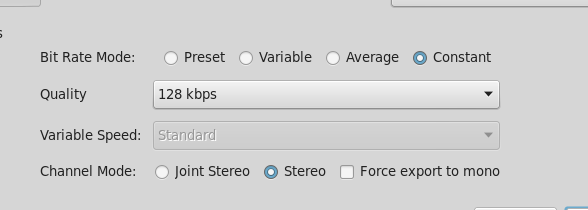

I was experimenting with sample rate reduction and file sizes. Of course once the information was gone, it did not matter what format I exported into . So the reduction in sampling rate is a parameter to adjust for smaller file sizes.
Audacity has a constant kbps setting for exporting mp3 files, which translates into a fixed sampling depth, what is the bit depth of a 192 bps file then?
Decent sound quality even at constant 128 kbps, which means some of my mp3s were not good at all. 4.2 MB compared to the 44 MB original. Not bad.
For purposes of illustration.
An mp3 does not necessarily reduce bit depth or sampling rate. I'm guessing it uses 16 bits (the original signal for generating mp3s is usually the CD equivalent, 16 bits/44.1kHz), but I don't know. If you really want to hear what an mp3 does, don't reduce the sampling rate (that flat-out reduces bandwidth as mentioned), but make mp3s at 64 and 96, and hear how they sound next to 128, 192 and the original .wav file. mp3 is a LOSSY format, meaning it's never going to sound exactly like the original (though higher bitrates like 256 and above come awfully close, I certainly can't tell the difference). FLAC (and a few other formats) is lossless and when played back will sound exactly like the original CD or .wav file, though FLAC files are about half the size.
But yes, all these different things (CD, mp3, FLAC) are basically different technologies.
