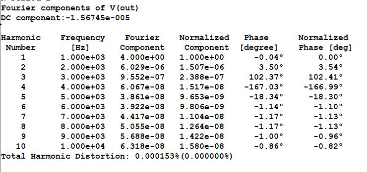

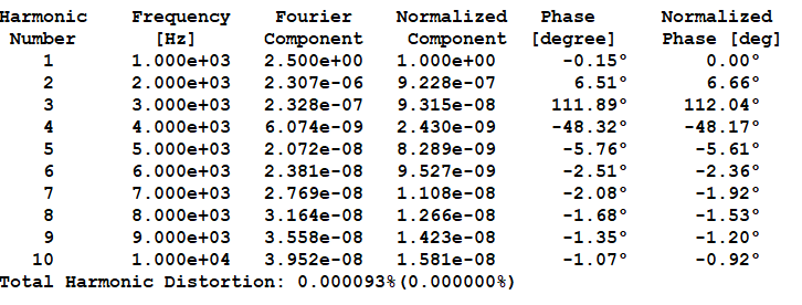

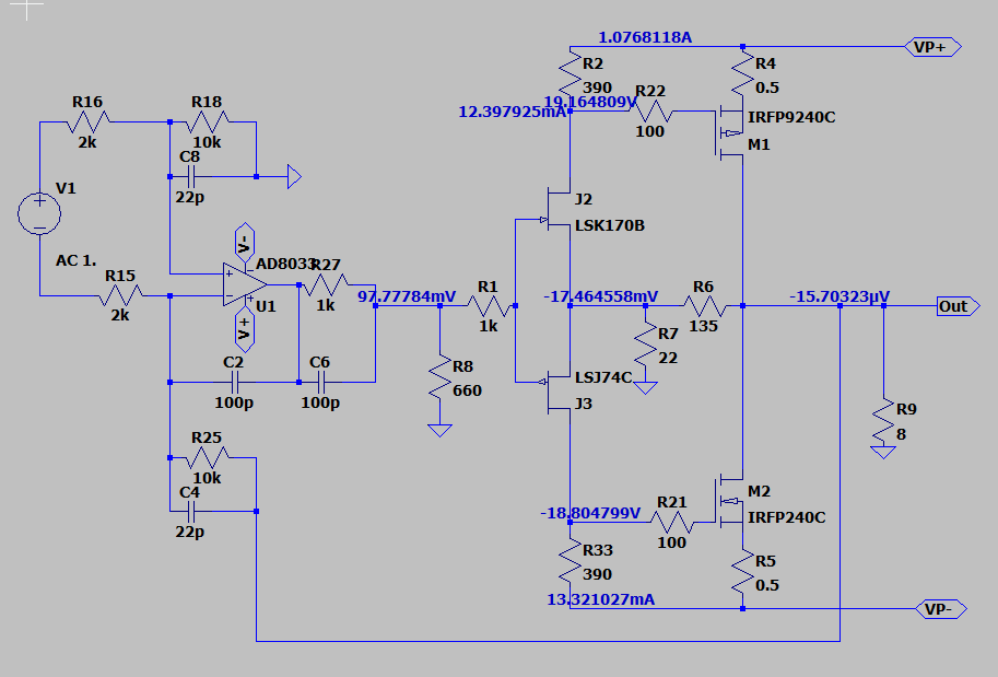

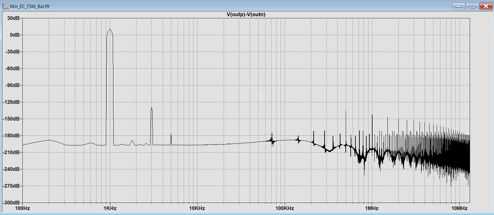

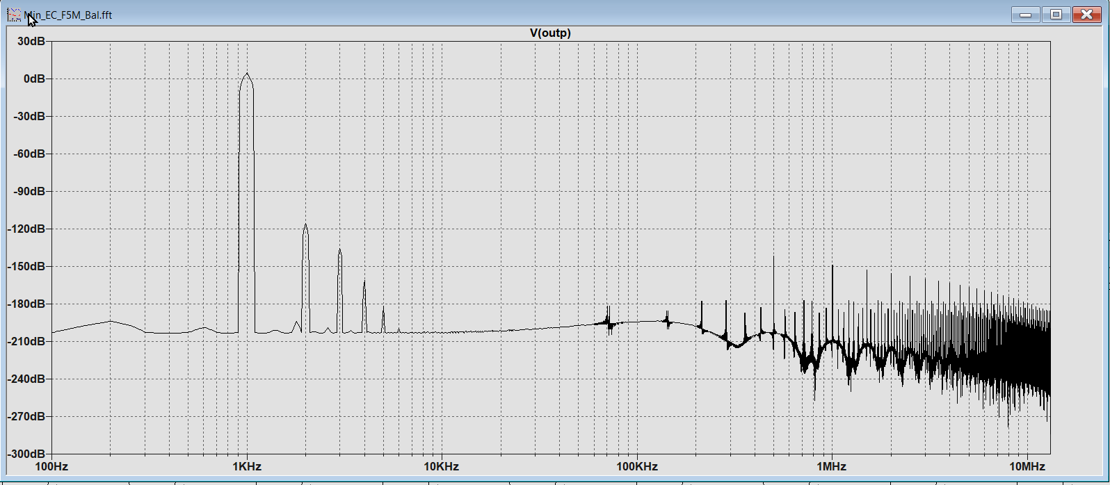

W wwwtttwww Member Joined 2018 2025-03-23 2:28 pm #1 2025-03-23 2:28 pm #1 My Error-Correction/Composite F5M thought. By simulation: 1. PPM THD 2. uV output offset 3. H2 dominant Reactions: userguide, Adams_Leo and adason W wwwtttwww Member Joined 2018 2025-03-23 2:43 pm #2 2025-03-23 2:43 pm #2 Balanced BTL Version. The 2nd picture shows the FFT of half branch OUTPUT to GND The 3rd picture shows the THD of V(OutP) The 4th picture shows FFT of V(OutP)-V(OutN) of BTL output Deminished H2. Last edited: 2025-03-23 2:49 pm Reactions: userguide You must log in or register to reply here.
