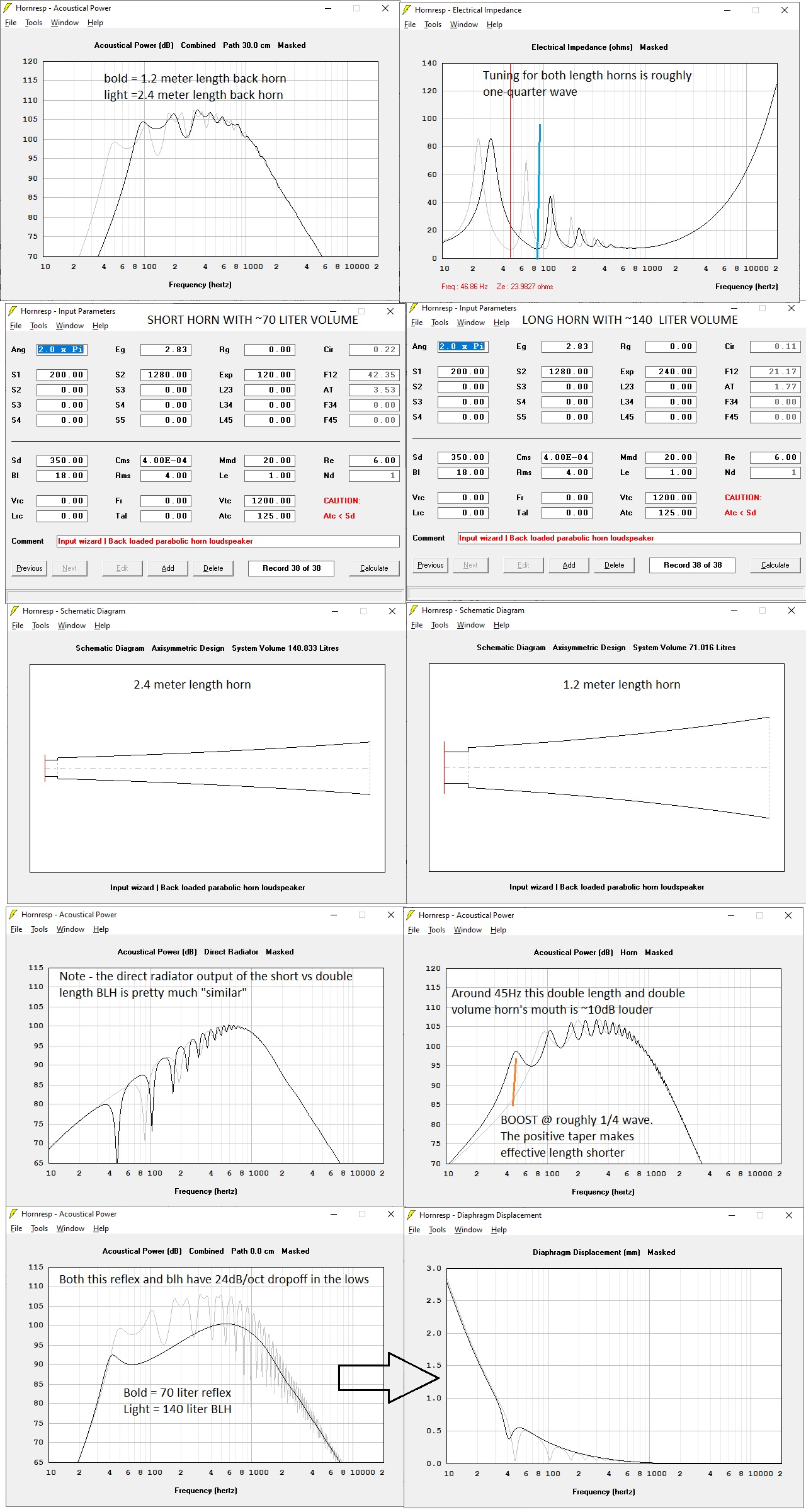

Below is a rough comparison of a driver in a reflex vs a larger BLH - I hope it isn't completely confusing.
Thank you a lot, Fred. The picture you provided has very useful information. Now I can see that:
1. The BLH enclosure amplifies different bands of frequencies,not just a single peak like the simple bass reflex one. From my understanding of your picture, the BLH is less flat compared to the simple bass-reflex. Is that true?
2. The longer the horn is, the lower the bass gets.
3. There's no way for an enclosure to beat the response of the driver in free-air, is there?
All of you guys are great and very helpful!
To a point, although it depends how you define (and tune) a vented box; a chambered back-horn is in essence an [the most] extreme version of the vented box, so it's a matter of degree.
No. It can be true. It depends on the specifics of the design and how heavily compromised the expansion etc. is.
In a sense, yes. The longer the horn, the lower its quarter-wave tuning frequency is. Whether it will produce any reasonable gain (aka 'output') though is another matter: again, that depends on how heavily compromised the expansion is relative to the ideal. You could, for instance, bolt a 20ft long horn to the back of a Fostex FE206NV, but if that horn only has a throat CSA of 1in^2 and a terminus area of 6in^2, it's not going to give you a great deal of useful output.
That rather depends what you mean by 'beat the response' (?).
