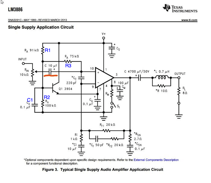

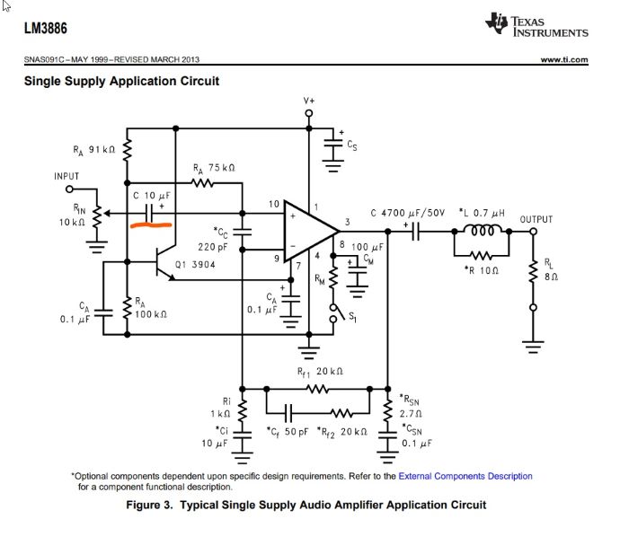

how does 1 choose the input capacitor value (AC blocker?) that's in the LM3886 (and maybe others) schematics/datasheet?
as above. (in the schematic below, it's the 10uF highlighted in orange)

Firstly, a cap will pass AC but block DC, so what that does in this case is remove offset from the input you are feeding the chip. I am not a LM3886 expert, but i believe the chip itself has some base DC offset, so removing any additional DC from the signal input is recommended to keep output DC low. The value of the cap depends on the circuit you are using, but you are basically building a low-pass filter with a parallel R (in this case Q1 i guess), so you have to calculate the exact values to use based on the circuit in question. You can look here for more info: https://www.circuitbasics.com/desig...Low-Frequency-Cutoff-at-the-Amplifier's-Input
If you plan to build the circuit above i guess you could just use the stated values, otherwise look around here, there are a whole bunch of LM3886 circuits that will do it for you.

Why bother with an online calculator? Just commit fc = 1/(2*pi*R*C) to memory and use a regular calculator. Fc is the -3 dB point. That along with Ohm's Law are the equations I use the most.
There are several RAs in the circuit. Also several CAs just for the sake of confusion. I've labeled some of them in attached schematic.
At DC, the input impedance is Rin = R3+R1||R2. That works out to 75+(100*91)/(100+91) = 123 kΩ. At frequencies where the reactance of C1 is significantly lower than the resistance of R1||R2, the input impedance drops to 75 kΩ.
If you want negligible impact of the input cap, design such that it sets a pole at 2 Hz (10x below 20 Hz - the lower end of the audio band). So we get back to fc = 1(2*pi*R*C), but this time we want to find C. Rearranging: C = 1/(2*pi*R*fc) -> C = 1/(2*pi*75000*2) for a 2 Hz cutoff -> C = 1.06 uF. Round up to the nearest standard value: C = 2.2 uF. C = 1.0 uF will probably be OK as C1 hasn't quite "kicked in" yet, so the input impedance is higher than 75 kΩ.
For the exact frequency response, run a simulation. Or build the circuit and measure it. 🙂

1 does not want ac blocker on the input, as music is ac, amp would be silent.
Cap prevents dc to enter amp and be amplified and heat or displace or burn the voice coil. And with amps input impedance cap presents high pass filter.
Some amp designers calculate cap value for 2Hz, to be flat from 20Hz. That may be excessive.
But 1 can use the cap value as advantage in high pass filter for biamplified system. To lower the im distortion and other advantages.
1 can do a lot.

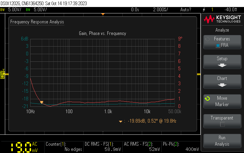

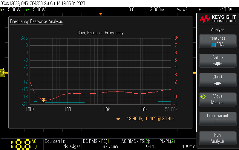

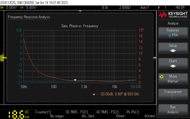

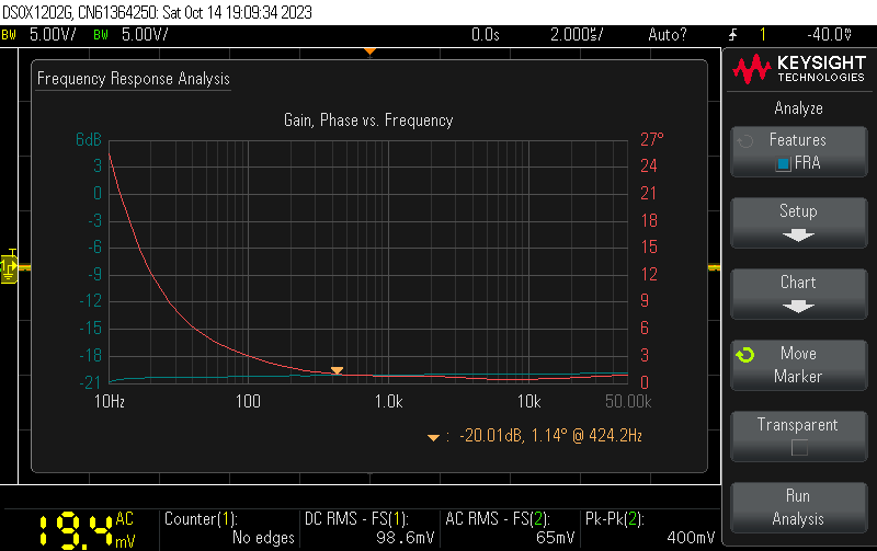

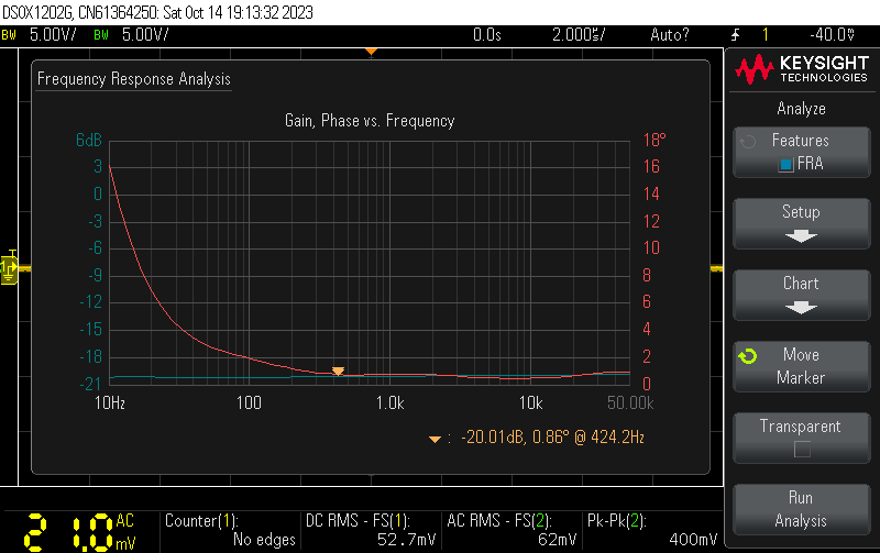

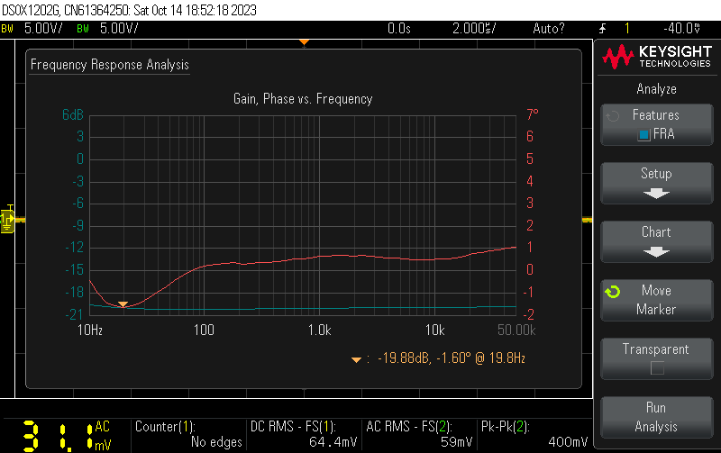

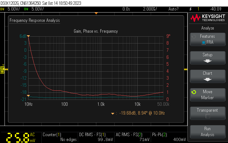

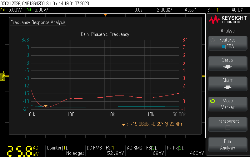

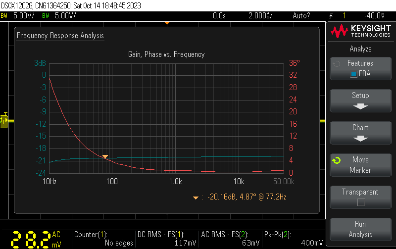

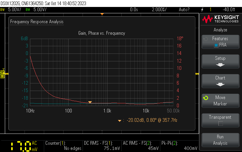

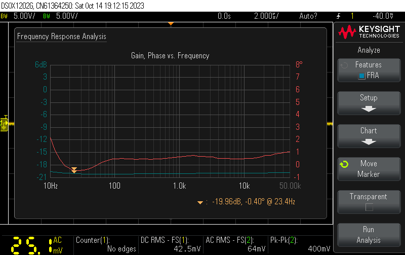

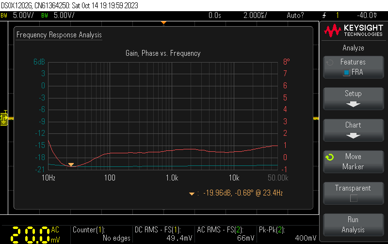

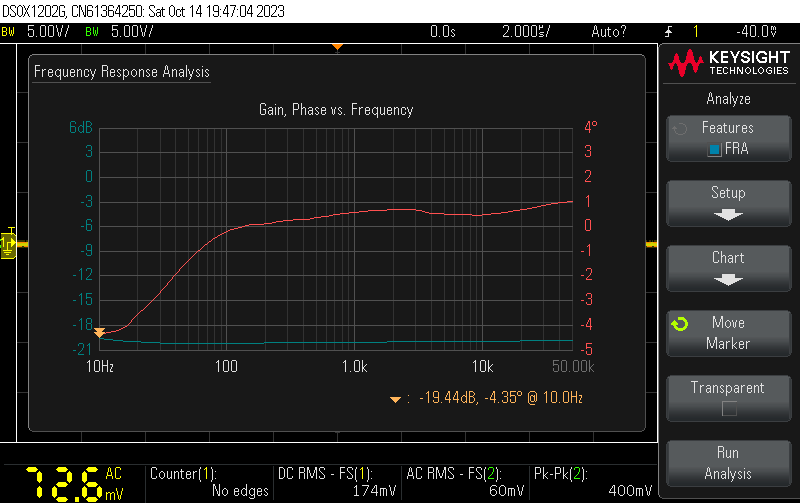

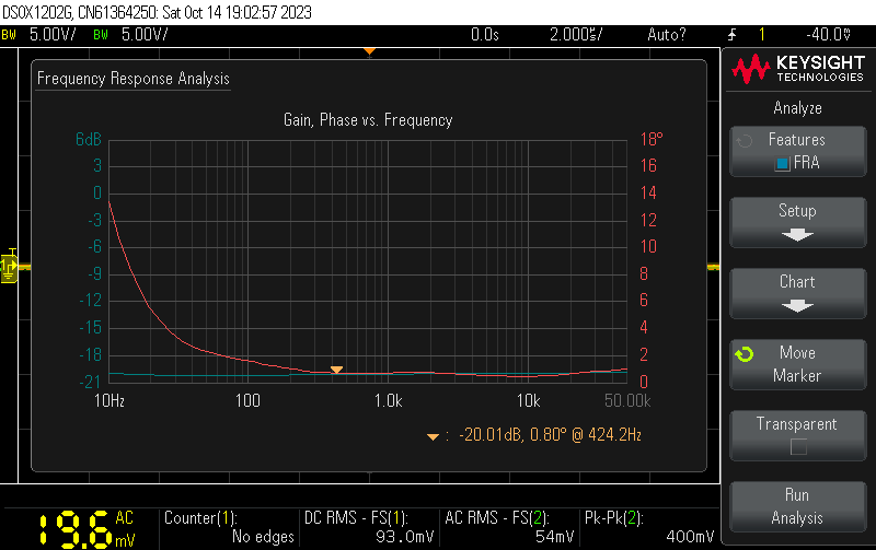

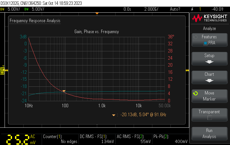

im building the p3a and have a similar question, today i tested 20 different potential candidates for p3a input capacitor, all are tested under equal circumstances, at 22k load, 3 volt peak to peak which is close to two volt rms
how to interprete theese screen dumps, which are the good the bad and the ugly,
list is from low uf value to high.

Hi sadface.. the data is nice, if it isn't flawed, and this date is flawed, look at the roll off in low frequency, I accidentally pushed the x10 to x1on my probe, so I'm sorry to say readings are useless, but I will today do them over, at correct setting, for those interested.
