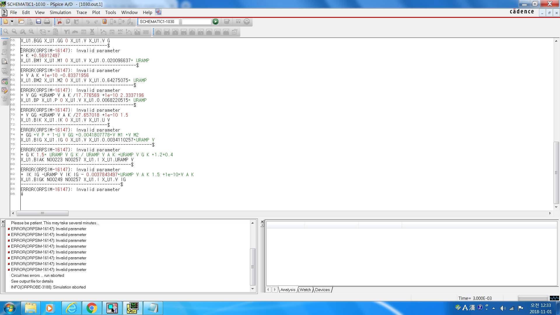

How do you use Ayumi's SPICE model in PSpice?
i forgot photo.
You will need to manually change the syntax as in the examples below.

I don't know how well these will perform in PSpice as I don't use that simulator. These two examples will run in LTspice, but you will need to change all instances of ^ to **. Micro-Cap doesn't like Ayumi's models, it will either fail to converge or throw up a "Matrix is singular" error.
