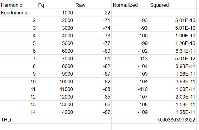

Who are you to make pompous assumptions about what I do or do not know? Exactly what are your credentials?I still tend to feel that the OP didn't really understand the implications of THD
You’re assuming that I’m an idiot who doesn’t know that THD is one of many parameters of an amplifier. Well, I’m sad to tell you, but I’m not.

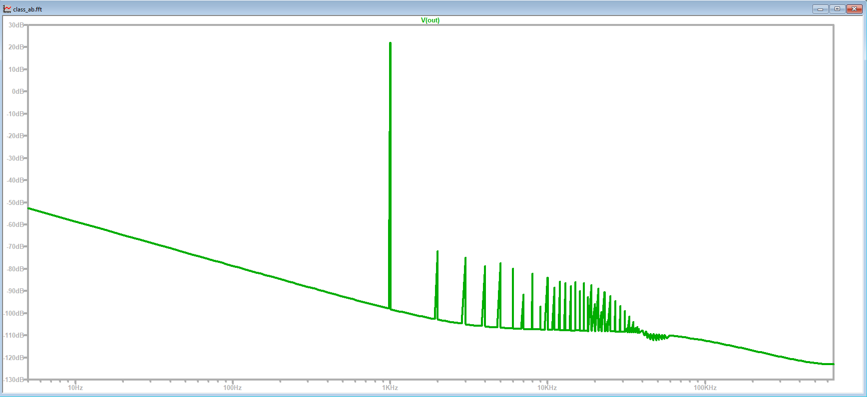

you add -102/-109 ones to a signal that is already having a THD of -90.My "manual" THD calculation from looking at the plot. I can keep adding -90dB peaks until the cows come home without the THD changing much.
Then indeed you need to add a lot of them to make any change.
My "eyeball THD calculator" says that if the magnitude of the tallest harmonic is 10 dB above everybody else, then the THD is determined by the tallest harmonic. If two harmonics are equal in magnitude, the THD is 3 dB worse than either one. It's really only when multiple harmonics are close in magnitude or when I need many digits of precision that I need to get the calculator out.

So when you're stating various THD numbers, how are you measuring them? Up to a certain number of fundamentals? Up to a certain frequency? Or whatever the highest frequency your equipment can pick up? I personally measure up to 50kHz, since the THD number in LTSpice tends to be all over the place and sometimes is lower than the PHD.

Alright folks, I made some mods:
1) Added drivers. Increased the slew rate from 12V/us to 14V/us. THD still at 0.003%
2) Turned the front end upside down, i.e. swapped NPN and PNP. That increased the slew rate from 14V/us to 19V/us. THD still at 0.003%
3) Doubled the current through the VAS to 14mA. THD decreased to 0.0001% !!!
Thank you for all the feedback! The best part is that it's still made from bog standard components. Hopefully I have time to redraw the PCB this weekend so we get to find out what it sounds like! The only downside is that it's even more mundane and ordinary in its design, now that I took out the quirks. 🙂
