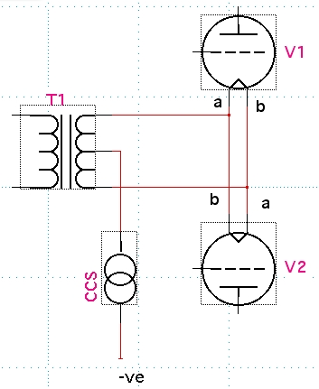

AC:
Cross-connect the heaters in parallel to cancel hum. Connect CCS to centre tap of FLOATING heater transformer winding.
DC:
Parallel heaters, cross-connected is better to reduce effects of ripple. Connect CCS to negative of FLOATING DC heater supply.
Edit: Added FLOATING to AC case.
AC:
