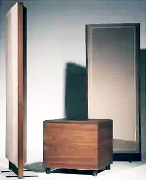

In the 70's several manufacturers used the resource of pointing tweeters in different directions to achieve the optimal sound stage, I remember the Andromeda of Phase Linear and DCM Time Window 7. I listened to both assiduously, because in those years I worked with the respective importers .
DCM impressed me, and it wasn't just me, it had a lot of acceptance among audio fans, they were columns of acceptable size and not a set of WAF bass monsters like PL.
But the manufacturers had problems with the production (I think I remember that only 200 units of the Model 7 were made) and the company was sold.
On the current page you can see that they mention it as an example of extraordinary sound and say they follow the same philosophy. I can't tell, it strikes me that current designs are conventional and no longer use the two front deflectors at 90 degrees from the original. The DSP did not exist, everything was achieved without time delays by electronic means, only the use of acoustic physics, but the results were excellent.
Perhaps you will find a pair used and in good condition still, although from what I have read, the owners do not get rid of it. 😉

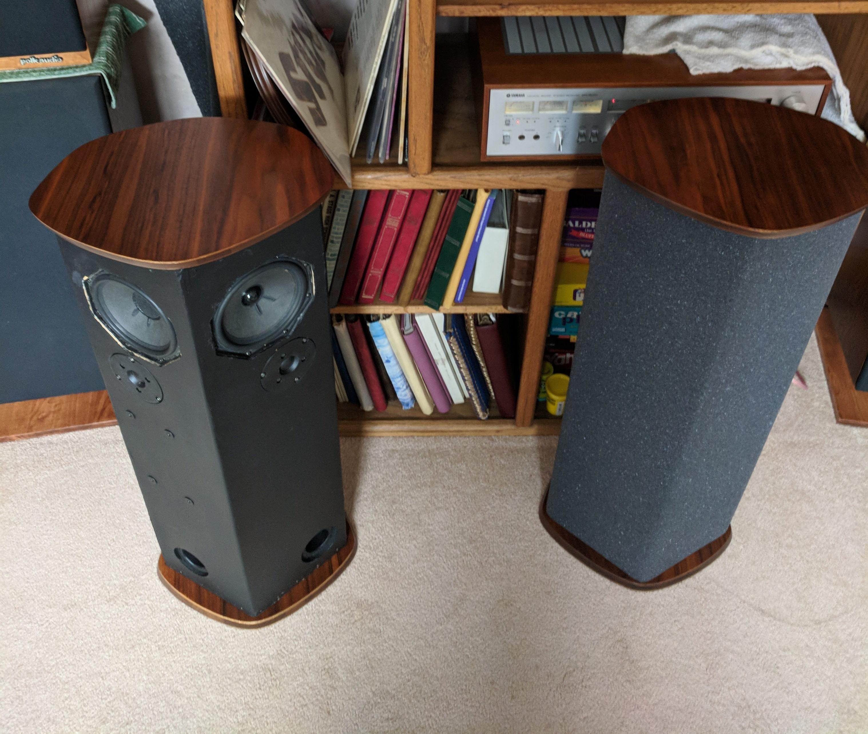

I forgot some photos of the DCM, here they are. The back is a trimmed Sonotube (!?). The speakers were mid-level Phillips.
Conventional XO components, wire coils and ordinary capacitors, not "audiophiles."
Its maximum performance was with good amplifier power. (200 Watts / Rms eg) The front was covered in open cell foam rubber, fitted like a sock. Not recommended for cat lover users.

I wonder why they don't make it today. Perhaps because they had to be located away from the side and front walls to achieve the feeling of space, which does not make them suitable for modern apartment environments.
Here's an inside view, I'm not sure if it's model 7, so I'll have to read the link to find out ... if nobody saves me the trouble, of course ! 😀
