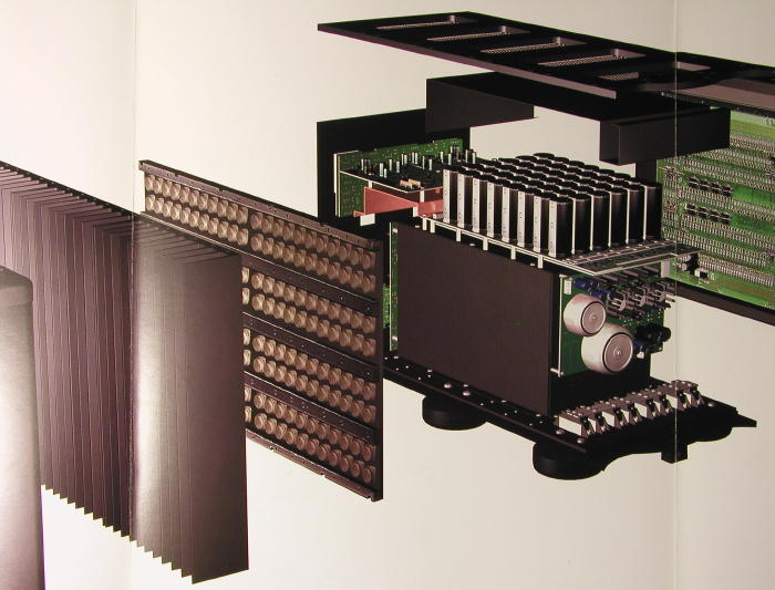

I look at the top cover. If I can stand on it and it doesn't bend under my weight, I have every reason to believe that the amp is build solidly and it may sound good as well. But it's just me.
Peter Daniel said:Here is a good example.![]()
Has that been built or is it still just a computer graphic? (a pretty good one too).

Rodd,
The heatsinks look similar, but the number of output devices doesn't much. I saw that picture tonight and couldn't resist not to post it. The number of devices is really impressive. But I was expecting more power. It's only 1000W into 8 ohms.
The caps have printed Black Gate at the very top.
