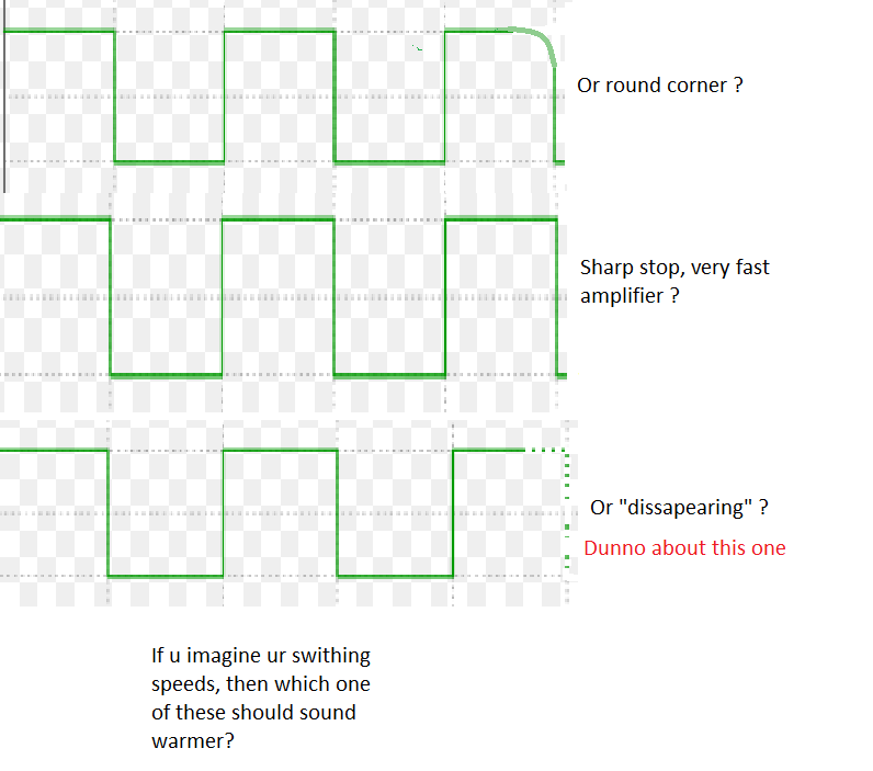

This image here.
I have listened various resistors, capacitors via "opamp" circuitry.
Atleast to my knowledge, changing the curve there and there did not make any difference to the sound quality... so i dont know.

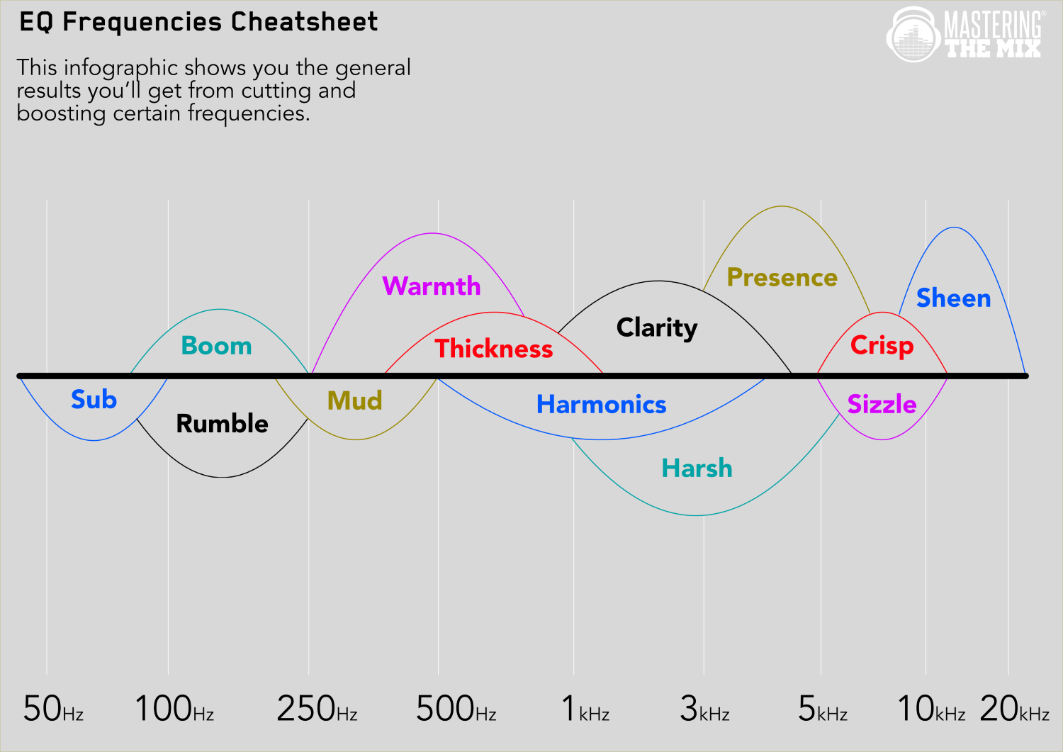

If you have any experience with people who love analog gear, you’ve probably heard the word "warm" thrown around a lot. A lot of this has to do with the limited frequency range and dynamic response of analog gear, as well the way the distortions and colorations that analog gear adds to sounds. This doesn’t mean, however, that only analog sources can be considered warm. In a digital setting, you can often add warmth by boosting some low-end frequencies ....or cutting of some of the super-high frequencies......
The chart below lists the "Warmth" range centered at the 200Hz, with the "Fullness/Mud" range centered at 350 Hz.

A system harmonic distortion profile with more 2nd harmonic distortion balance will have more warmth.
Higher presence of 2nd order distortion in the bass and a stronger presence of upper bass frequency being a a matter of taste, some add closer to 100hz some boost higher up by 200hz.
You can find a bunch of variations of charts like this online

Warmth can be EQ-ed in in a room curve. Look at the cheat sheets given here, that's about right.
I've done so after hearing the Altec setup of my next door neighbor. It is a fine line to get that warmth, without making it muddy.
Worth the try though, it can be quite seductive.
