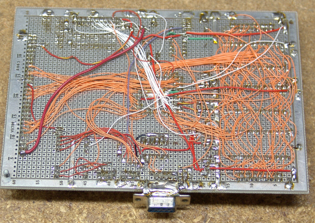

I built this little SBC using a MC68HC11 chip in the early 1990's. It would kick the SWTPC system's butt in every way except for graphics, and run on a little wall wart.
