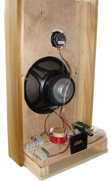

As much as I love open baffle speakers, I can't see doing one with a 3.5" driver alone. Unless the baffle is huge, you'll have a terrible tonal balance with no bass. Low end losses on open baffle are massive, so you need big baffles and a lot of woofer displacement to combat those losses.
With good EQ you might be able to make a decent sounding OB desktop speaker with subwoofer support. Similar to the satellite with single sub computer speaker systems.
There is a long running OB project that uses a 3.5" cone as its tweeter, crossover is circa 700 hz. See here if you would like to know more.
Fast, fun, Inexpensive OB project
I know that's not going to stop you from building a set, (nor should it) but it might help you understand why getting a good tonal balance will be difficult. 😛

Wow nice o.b. speaker Pano. Is that the sea's 4 inch full range drivers back side I see? Just wondering what full range driver you used with your low end woofer. Also nice crossover. Cheers Jeff
