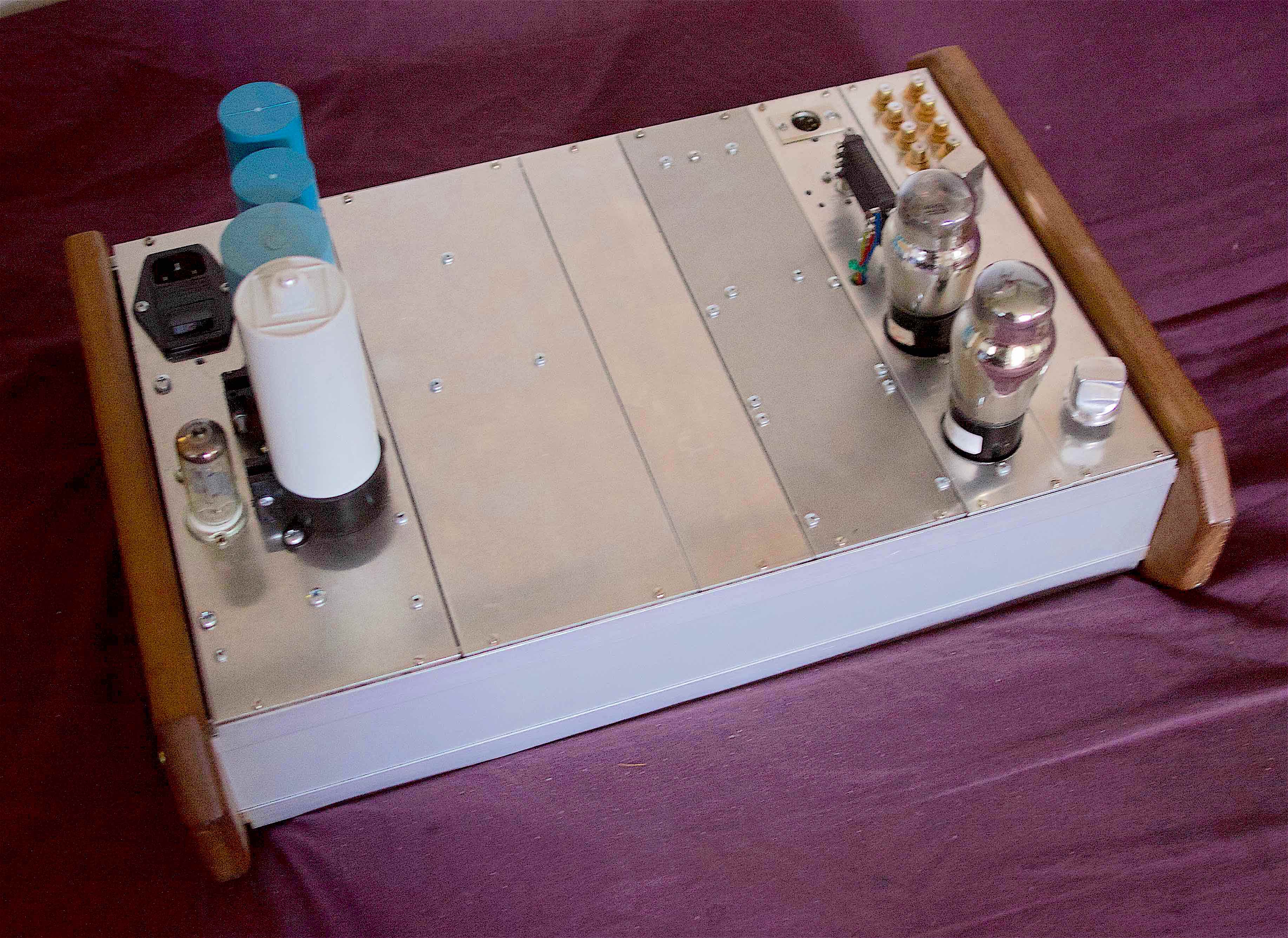

I have a different approach to this. Having been brought up on Meccano I love screwing things together so I decided 10 years ago to use a modular system of top plates and screw them down into 19" rack mount subframe parts like horizontal rails and threaded inserts. Over the years I've built up quite a collection of modules on 100, 70 and 50mm wide plates, all with a depth of 275mm. So I can construct a new project using mainly pre-existing parts. Downside is lots of screw holes when re-purposing plates but I can live with that. Upside is each plate is so small and easy to work on and finish before screwing into the chassis.

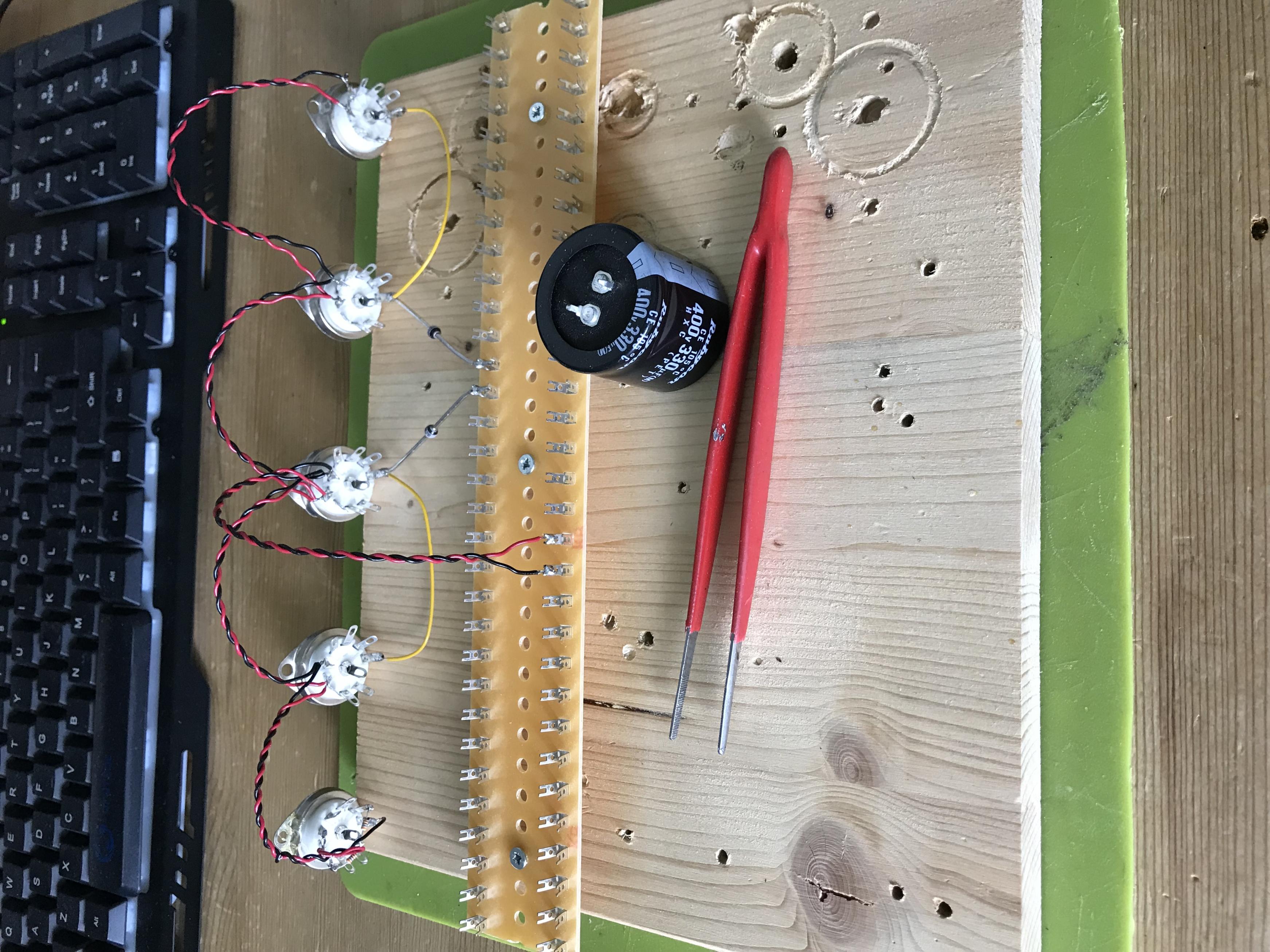

I´ve been prototyping Tube stuff since the mid 60´s, always used the classic bread board method: a serving tray sized piece of wood (you´ll compact layout later, now you need space) with nails all over it, brass preferred if possible but if not, iron works fine, if you have a hot classic 60/100W iron (no 30W snowflake types here).
Tinned solid wire makes ground and various +V bars.
You do NOT clip component leads, as they are reused over and over.
Tube sockets are mounted along an L bent aluminum strip and wires go back and forth.
I make Guitar Amps and a few times the breadboard monstrosities were used live, on stage, go figure.

Would love to see a photo of this to get a feel for it. That seems really pragmatic, I like that a lot. Do you have blog or website that shows behind the scenes stuff?

Also thanks for the correction on breadboards, I quite like this as an option. It seems easy to get started, just need to purchase some PCB for mounting tubes…. and build a power supply!

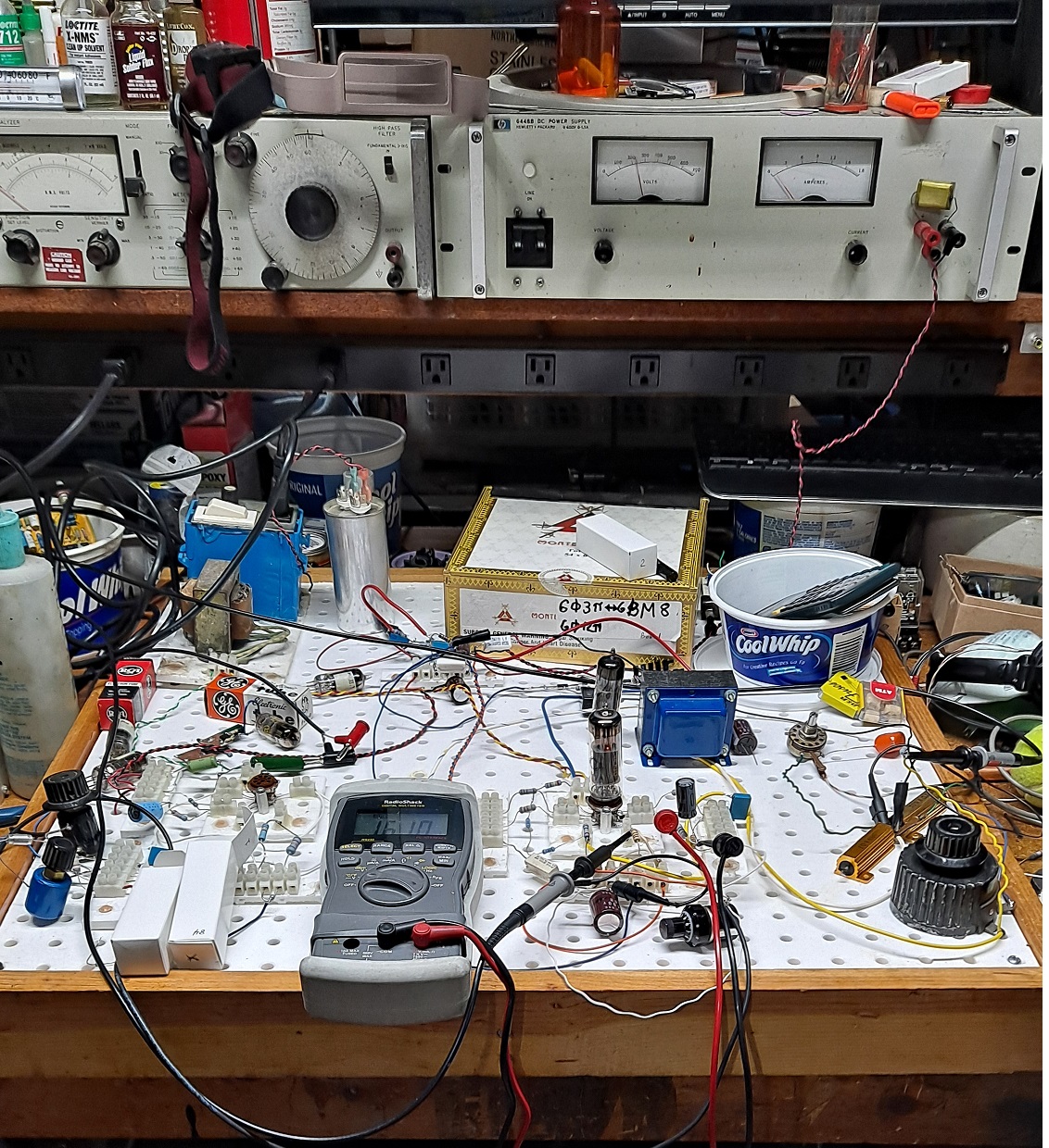

I'm right now breadboarding my SEPP EL84 on separate wood "chassis" - to check all those voltages before making final prototype - It is totally not SAFE!
You need to control yourself and be extremely careful were you put your hands while measuring and while resting alike!

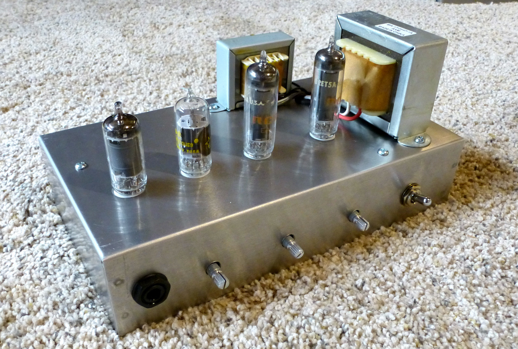

This is where I started in the early / mid 1960's as a kid making tube stuff with parts salvaged from scrap TV's and radios. I used a pine wood board as the chassis.
The connection points were sometimes terminal strips ripped from old TV's, sometimes brass furniture tacks used for upholstery in the 1950's, and sometimes just the heads of brass screws screwed into the wood. As stated a big soldering iron or the trusty WEN or Weller soldering gun is needed to heat them.
I soldered a short piece of wire to each pin on a tube socket, then simply screwed the socket to the board with wood screws. Sheetrock screws would be a better choice today, but they were not common in the early 60's. Each wire was soldered to it's own brass tack after the socket was screwed to the board. Due to availability at that time almost all of my DIY stuff used octal tubes.
Heater, B+ and ground were run across the back of the board with stripped #12 or #14 house wire. Stick one end of the wire in a vise, grab the other with pliers, and stretch it just a little. After that it will lie perfectly straight and flat and can be bent as needed.
I mounted pots to a piece of metal angle and put it on the front of the breadboard.

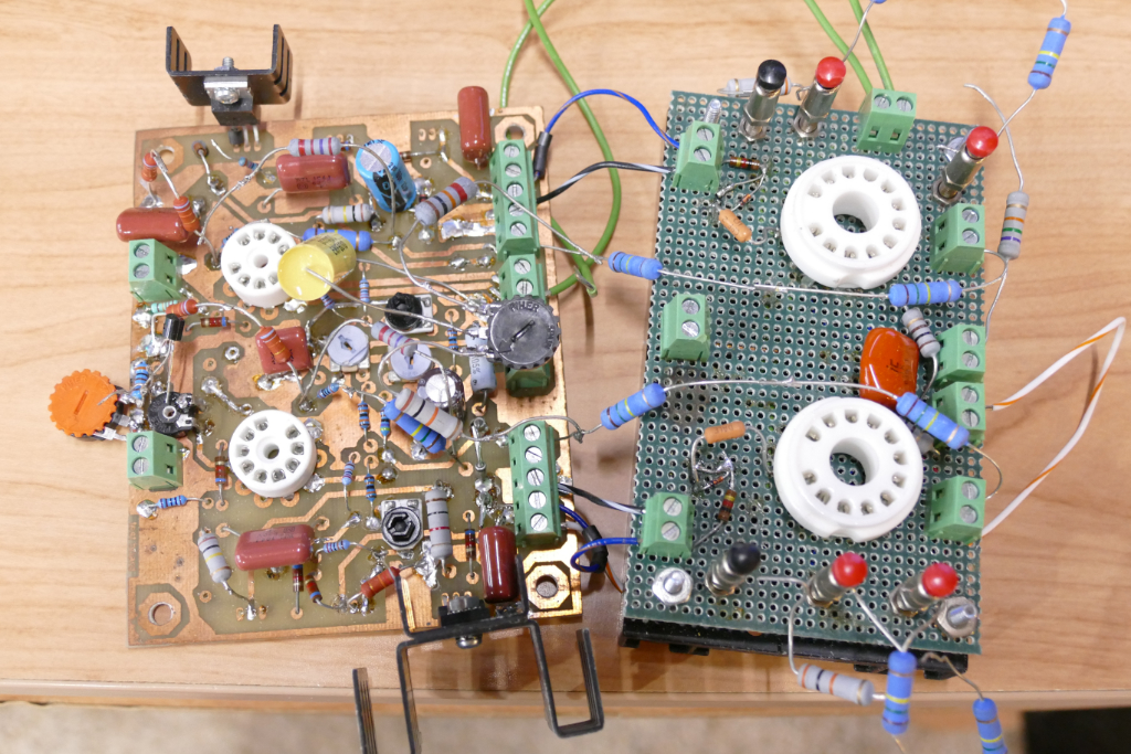

About 30 years ago I made a recreation of my first DIY guitar amp, built when I was about 12 years old. It used a 6SJ7 driving a 6BQ6GT powered by a 5Y3 and a transformer ripped from an old radio. The OPT was the vertical sweep transformer from a TV. Unfortunately it was lost during a hasty move. I had three weeks to clean everything out of my house in Florida where I had lived for 37 years. Somehow the white plastic pegboard "Tubelab III" made the trip, but the box full of modules for it is gone.
I actually sold a few of my DIY amps made this way. They were ugly unfinished pine boxes with window screen for grill cloth, but to my young ears they sounded pretty good. It was the 60's in Florida and I really wanted reverb to play surf music, but tanks could not be found in the trash.....yet. I remember selling one of the amps to the older brother of a classmate for $5, a big deal to a kid in the 60's.
Seven or eight years later I was the service tech at an Olson's Electronics store near the University of Miami. A student from the UM School of Music walked into the store with that amp wanting it repaired. The counter sales person basically told him that it could not be fixed, but I spotted it from the rear of the store, ran out to the counter and told the customer that I could fix it, and would do so for free!
The amp had been found in a corner of a closet in the music lab. It needed a new filter cap and a general resoldering, but worked pretty good. That repair job got me access to their music lab. They had a Mini Moog and a brand new ARP 2600. I seemed to understand what the controls on the 2600 did better than their instructor, so I kept getting sales pitches to come to their very expensive school so that I could become another starving musician or music teacher. A short time later I accepted a job at Motorola 30 miles away and I never saw the music lab again. I stayed at Motorola for 41 years, so I guess I made the right choice.

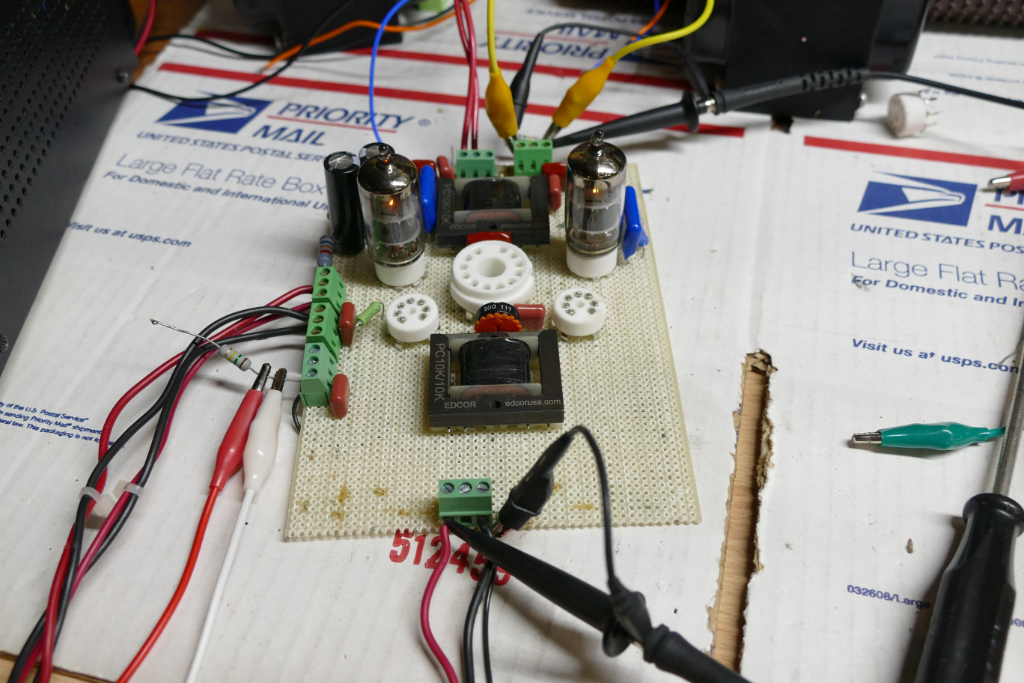

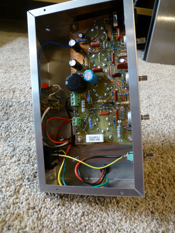

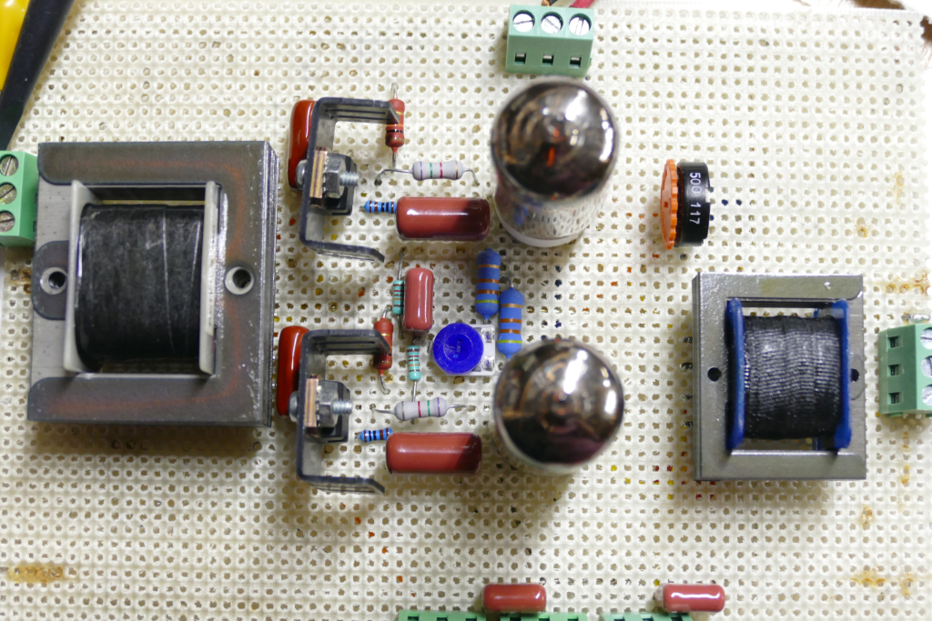

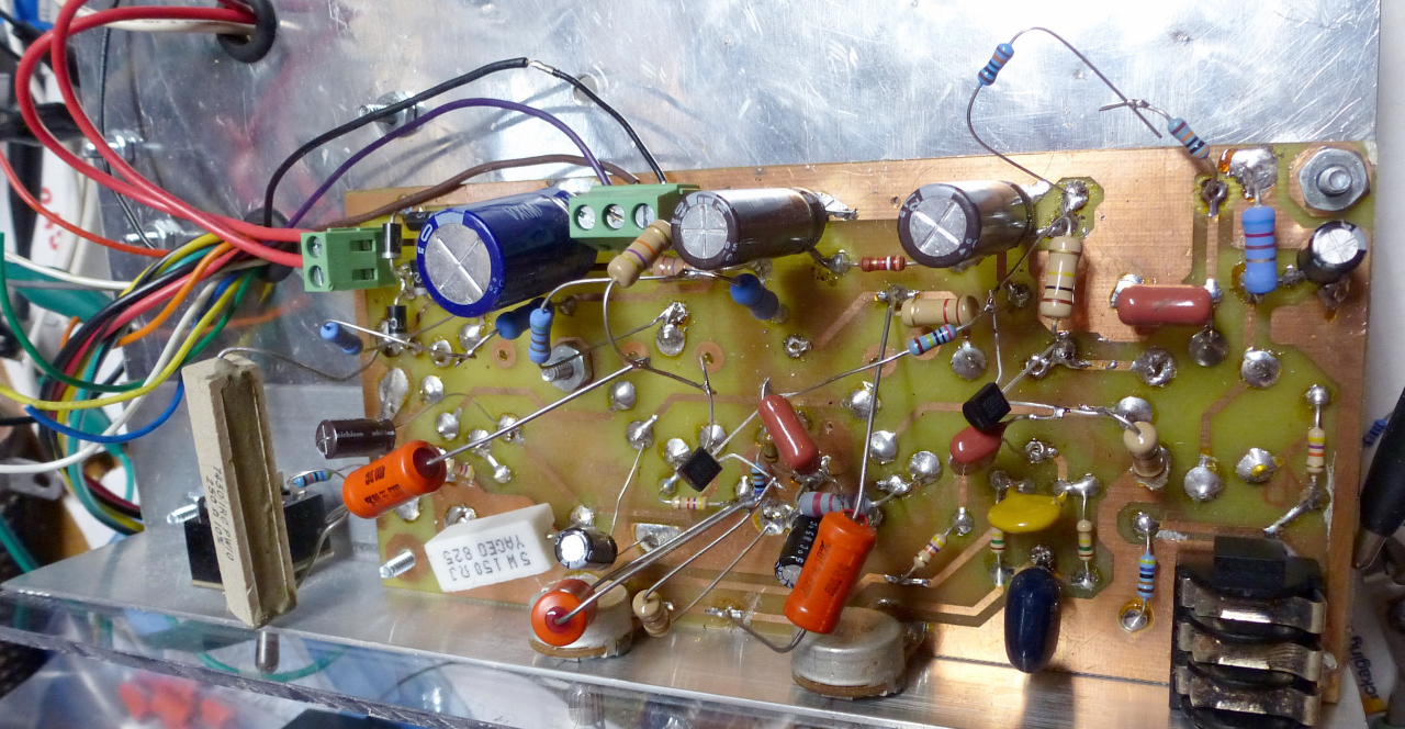

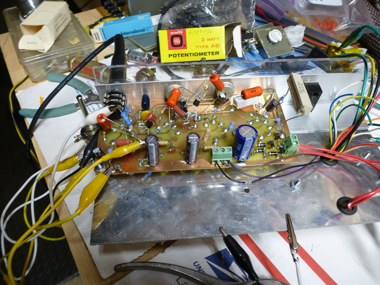

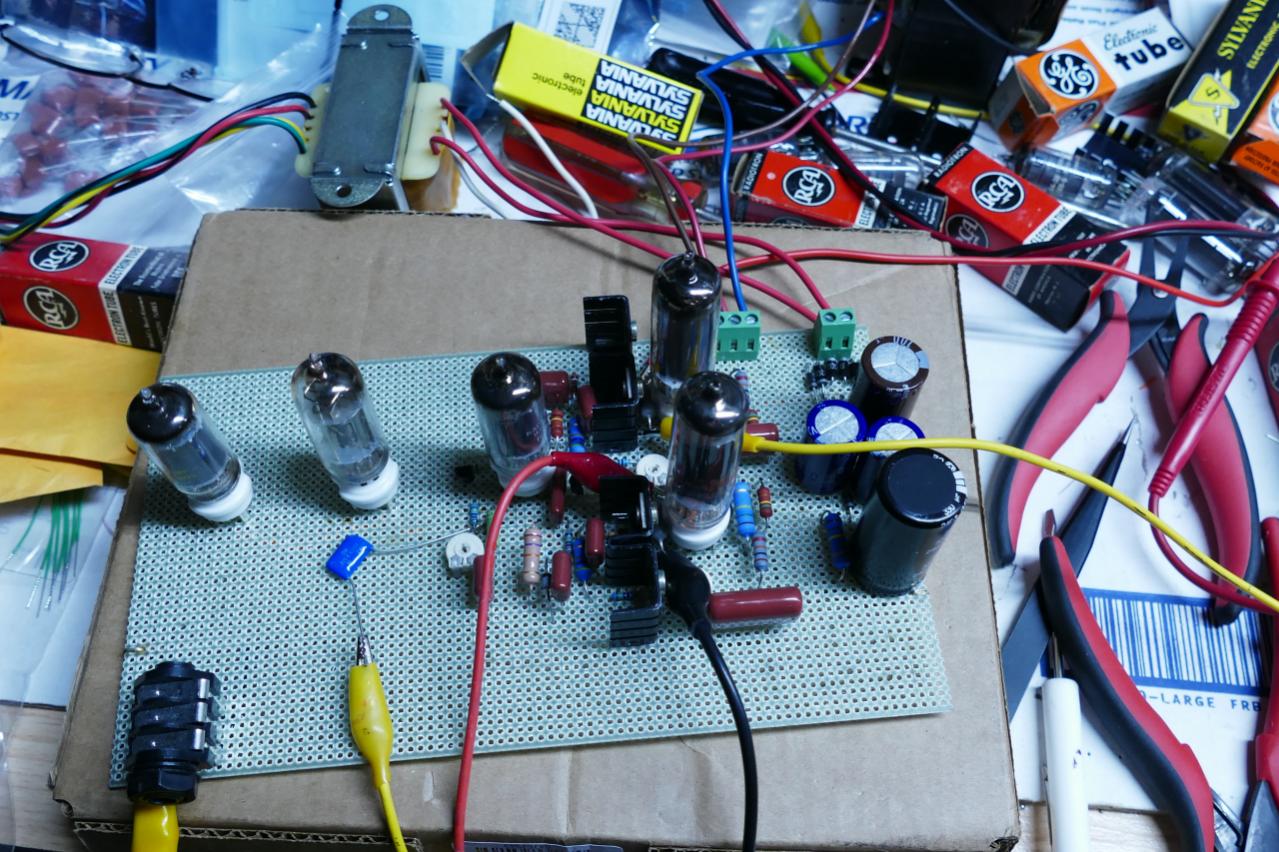

I have been looking for a better way to rebuild and improve the Tubelab breadboarding system and collected some ideas and parts, but haven't started building anything yet. For now most of my experiments look like flying messes of parts built on perf board, or on top of an old failed PC board design.
The flying lead solid state parts and clip leads leading to several pots pictures were part of the process of an all tube guitar amp built for the Hundred Buck Amp Challenge being modified into an amp that I really liked and still use today. The resulting design was made into a new PC board design, and fitted into a proper small chassis. It is seen sitting on top of the speaker cabinet. The remains of the original cab be seen on top of the spectrum analyzer behind my head and to the right of my ear. It served its useful purpose and was tossed into the "box of dead projects" where it will be robbed for parts, or used as the basis for another experiment some day.

Hey TubeLab,
That’s such a cool story, I would love to have even 10% of your knowledge and experience!
Those photos really help me visualise ways of doing this. They look remarkably neat! This all makes me think I’m over thinking things and I should just stay cheap and pragmatically.
A question: looking at photos 1 and 2, how do you know that the tube sockets could pin mount directly into holes on your board? Or did you mount them in another way? Did you mount the transformer just by cutting out a hole?
