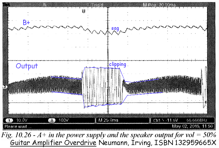

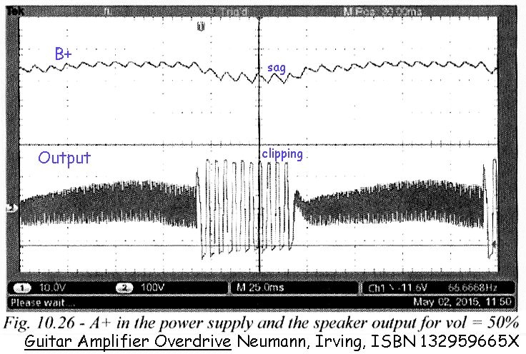

> info about signal envelope!
I just passed a plot in Neumann. See attached.
From Guitar Amplifier Overdrive Neumann, Irving, ISBN 132959665X
The run starts with a 2KHz tone about 6dB below clipping. The B+ is steady with some ripple. (Here "A+" is the first B+ filter node, not the filament supply.)
Then a MUCH larger 200Hz tone is added. The power stage is about 14dB past clipping. Because this is an AB stage, and the drive is past Sine to Square, average B+ current increases. The B+ sags. You also see more ripple. The overdriven 200Hz tone starts from the un-sagged B+ but drops slightly as B+ sags. The peaks of the clipping shift with B+ ripple (making IM at 200Hz +/-120Hz).
The blue line is an approximation of the "envelope" of the output wave (some bent because of overload effects).
When the abuse stops, the B+ un-sags and ripple goes back to before.
Incidentally, while OVER-driven, coupling networks charged, bias shifted. When abuse stops, the bias recovers. Notable is no gross wonkiness after a burst of OVER-load. (Some amplifiers "faint" due to grid-blocking.)
This is !NOT! how we use hi-fi amps!! We do clip, but very rarely. Our average is 20dB down from clipping, not the -6dB used in this test. We usually aim for lower ripple than this. (But due to push-pull action, and reduced ripple at idle, amps like this {even with exceptionally efficient speakers!} can have low hum in a quiet club or worship service.)
When I modded big tube amps for "good" sound (reinforcement of clean acts), I did test with HUGE overdrive to be sure they would not go "acccckkT!" if hit a bit hard. I did not obsess about how much virgin llama-oil was in the filter caps, or strive for "no sag". IIRC, a 300W amp which idled at 600V B+ would sag to 550V in OVER-drive, but working live-sound to the point I could hear some clips it only dipped to 590V.
The amp shown is a Fender 5F6a. You can find the plan(s) everywhere. This is perhaps a minimal starting point for a 40+W tube amp with 1950s economics. Many fine hi-fi amps used the same 40uFd first cap right to the OT. Most filter the Screens with R-C not L-C (because they are not meant to play at-max). It is ugly on 'scope but it mostly cancels in the OT. 10+dB NFB almost hides the residual. In today's economics, MUCH bigger caps are low-cost (and Si rectifiers can stand larger peaks than 5U4) so hundreds of uFd might be used in a Hi-Fi 2x6L6 amp.
The referenced book is a dense read, and not suggested for beginners. It also focuses on *distortion*, so by definition has little for the Hi-Fi fan. But if you want to know "why" we do a power supply a certain way, this specific example shows what happens at an extreme.
