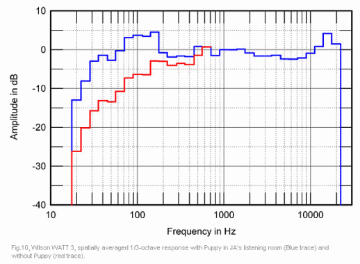

Amazingly I can't find any response curves of those speakers like the Canton LE 900 or Quinto xxx. It was an emphasis of the upper bass region around 100 Hz and the tweeter region. It was quite the opposite of the "english" sound of that time. It has been pointed out, that this "zisch-boom" (onomatopoeia) sound didn't show up in the direct response graph as much as in the diffuse field response. Like overcompensation of the baffle step combined with turning from an already beaming cone midrange to a dome tweeter ...

Frequency response on axis is certainly the biggest factor in voicing - or Tonal Balance.
You can walk from room to room at an audio show and hear tonal balances all over the map. Some of that has to be the designer looking for a certain sound. Bumps and dips in certain places give speakers their character, just as they do for ladies. 🙂
