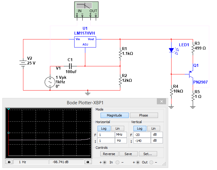

A good standard PS regulator will do it, but wiring should not be too long.
The CCS circuit is a standard textbook one.
It has improved impedance due to negative feedback.
The greater R2, the greater is the feedback and the output impedance.
Even the standard version with moderate R2 has a negative output impedance at higher frequencies. This can cause oscillations...
A current source instead of R2 needs careful testing. Better to use a cascoded current source for good HF impedance. At higher f the impedance is limited by Cbc.
The -5 dB PSRR means that 1mVolt of PS ripple is seen at OUT as 0.56 mV.
The signal due to CCS at OUT is about 3 mV.
The voltage drop at R3 and R9 should be about 5 Volt.

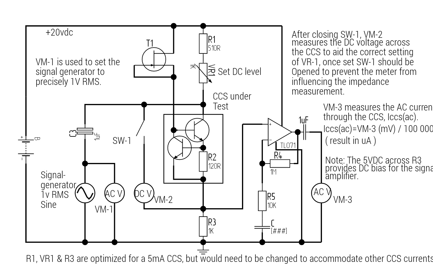

Putting all the ideas together I have derived the following scheme, featuring a x100 / 40dB amplifier ( I don't need 5 MHz bandwidth ), hopefully this will work. If possible I will try it out tomorrow and post my results thereafter.
See attachment.
See attachment.
Have you the time to explain what this is?

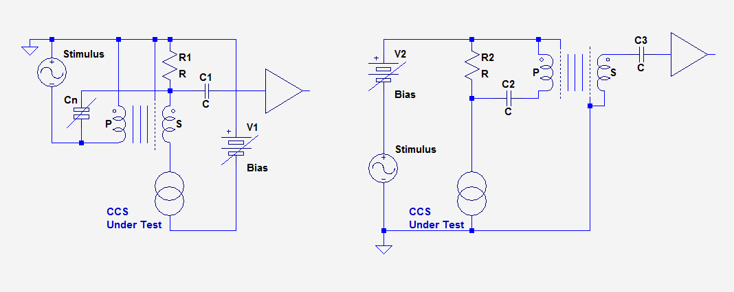

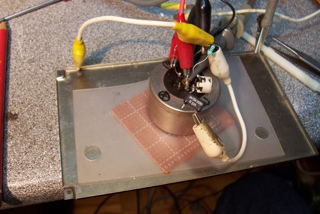

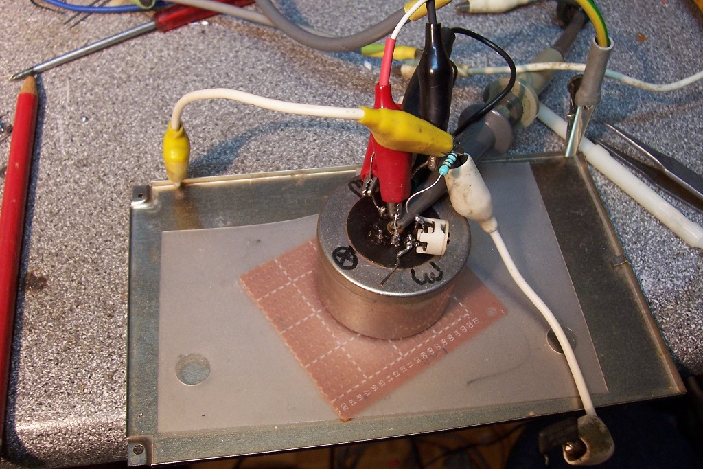

Here are the two setups outlined; in the first, the transformer is used as a floating stimulus injector.This sounds expensive, I am hoping to come up with something I can build from parts that I already have. However, like Andrew I'd be interested in learning more about this, if you have the time to teach us.
The transformer should preferably be equipped with a secondary screen, and the final residual can be perfected with a small neutralization cap.
This configuration has the drawback of letting the CCS current pass through the transformer.
For a few mA, even prerhaps up to some tens of mA, this shouldn't be a problem, but for higher currents the transformer needs to be gapped.
The second configuration dodges this issue, but it requires a primary and secondary screens.

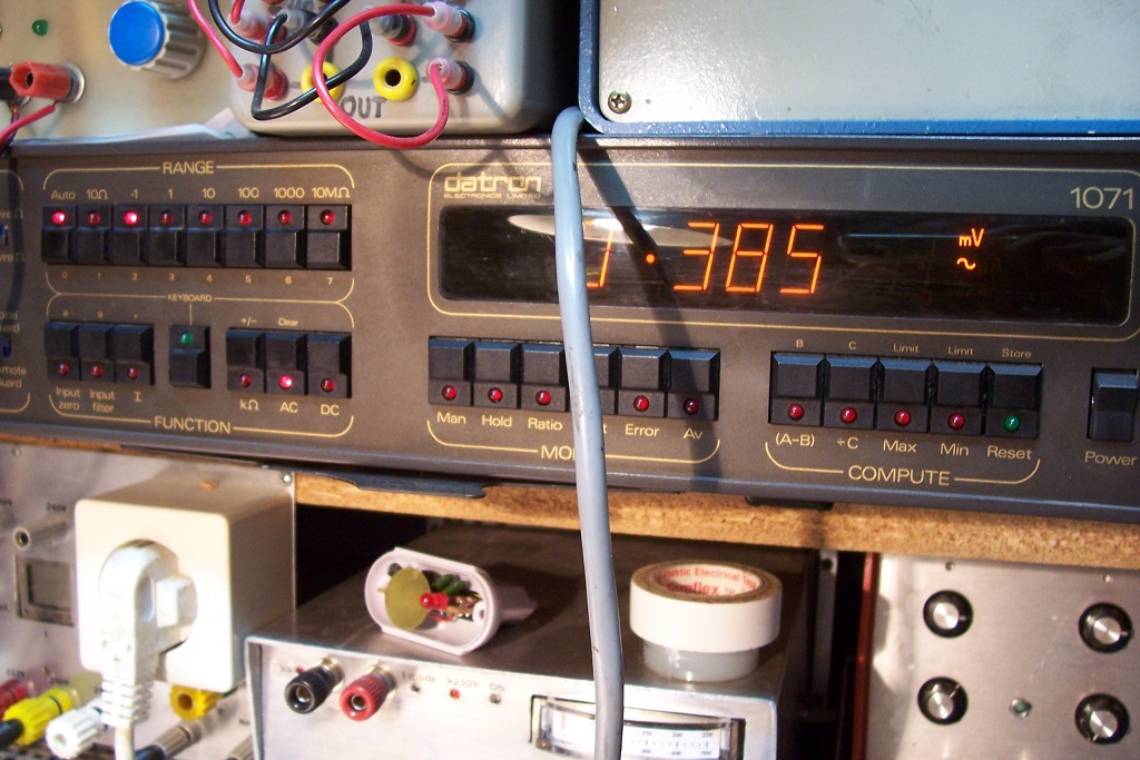

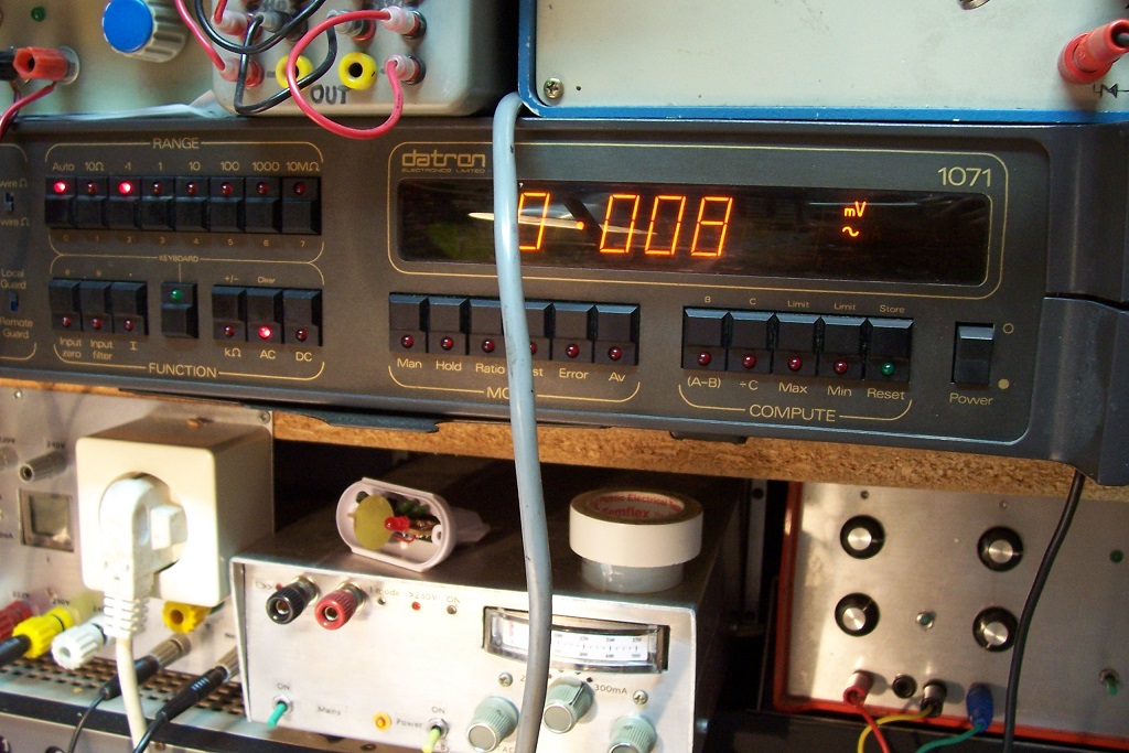

I made a quick test with the first transformer I could find: a Pikatron, apparently ~1:1.
I used the first configuration, except there is no screen.
The first pic shows the setup being crudely adjusted (without DUT). Next is the result: 8µV AC. Note that this residual is probably not mainly the 1KHz stimulus, but 50Hz hum: the setup is shielded, but very moderately.
Third pic is the DUT being measured:in this case a 100 Meg resistor (I didn't bother to use a real CCS with DC bias as for this type of evaluation, it isn't necessary).
The output voltage is now 385µV.
With ~5V stimulus, a shunt of 10K, this falls about right for 100Meg.
There is a ~20% discrepancy, but for a quick and dirty experiment, it is not particularly surprising.
Anyway, this shows that the method has a large potential: with 1000Meg, it would still be usable.
In addition, it is compatible with any type of CCS, including OpAmps, it is polarity-agnostic, and it allows the test in the real conditions: even with a 2W CCS, the way it is driven does have importance, because of the capacitance to the ambient space.
When you place the drive and the shunt at convenient places for an easy measurement, you lose these aspects, and they may be important because for a good CCS, the impedance will be dictated by capacitance for most of the frequency range.

I have revised my scheme for measuring the DC resistance of CCS. On reflection the previous setup, given in post #97, using the ina131 wouldn't really work so well and also I think it was unnecessarily complex. The set up attached uses only 1 active device, a jfet, there is an explanation of the measuring procedure above the schematic.
The circuit uses a sensitive DVM ( 200mV fsd ) across a DC bridge, the purpose of the bridge is to null the large DC voltage across R3 due to the CCS and to leave only the tiny ∆V corresponding to ∆Iccs, the difference in current due to the internal resistance when the DC test voltage is varied. Therefore Rccs = ∆V / ∆Iccs.

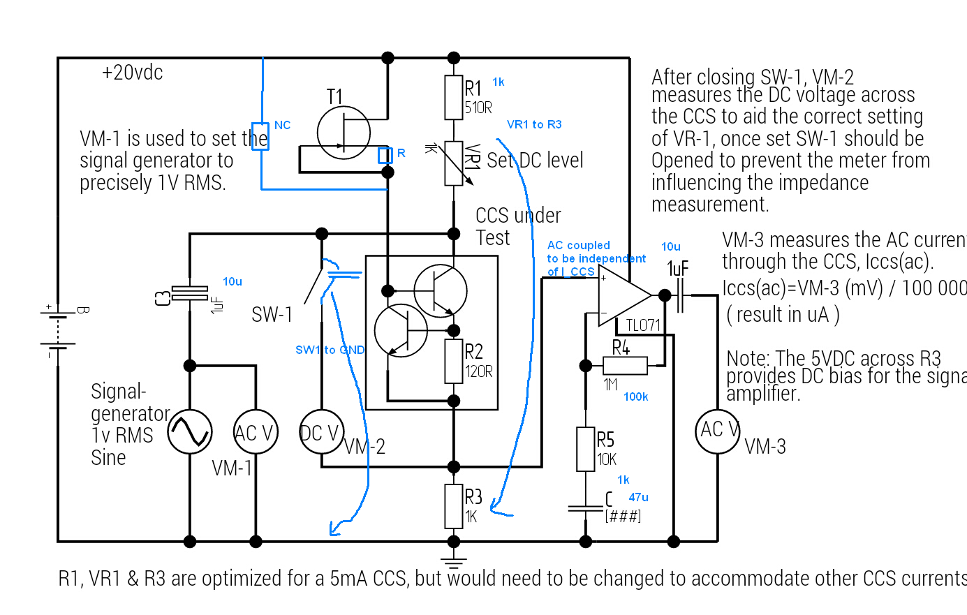

See attachment.
I have done some comments on your circuit. I am looking forward to see some
transistor measurements 🙂
I understand most of the suggestions, though I need clarification on a couple of points. The resistor in parallel with the jfet current source, does this mean, use both or instead of?
The DC voltmeter, you say the switch should be on the ground side, but is the meter to measure V across R3 or the voltage at the + side of the CCS?
Thanks again Udok. I too am looking forward to some more results. I think Jeanette might be taking the kids out tommorow ( they're on easter break just now )so I'll get peace to do some work!
Gordon.
The resistor in parallel to the current source is an alternative.
The CCS impedance depends on the impedance of the JFET CCS.
Use the resistor between Gate and Source to adjust the current of the JFET.
VR1 does not make mutch sense here, use it at R3 (to adjust the DC level) or at R2 (to adjust the current).
The DC voltage at the CCS is (VCC - I_CCS*R1), no need for VM-2 at that position. Use
VM-2 to measure voltage across R3 (I_CCS = V_R3 / R3)
Greetings,
Udo
Greetings,
Udo
