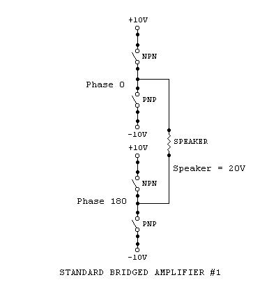

The purpose of my post above was simply to provide the pic. Both amps are fed the same non-inverted signal. BTW, the X1000 uses an extra box which is basicly a bunch of isolation transformers before the inputs to allow such operation. Internally the X1000 has no Earth connection except on the case which is isolated from the circuit. The downside of this whole idea is that if the amps are slightly different in terms of frequency response or in the time domain, the output will get messed up to some extent.
AudioFreak said:The purpose of my post above was simply to provide the pic. Both amps are fed the same non-inverted signal. BTW, the X1000 uses an extra box which is basicly a bunch of isolation transformers before the inputs to allow such operation. Internally the X1000 has no Earth connection except on the case which is isolated from the circuit. The downside of this whole idea is that if the amps are slightly different in terms of frequency response or in the time domain, the output will get messed up to some extent.
Thanks. As I said I had no idea how the X1000 was set up but they would need to be like that or similar to do it.

In general when bridging PA power amps, the gain is set to max so as to match them as closely as possible and levels set with the preamps or mixers.

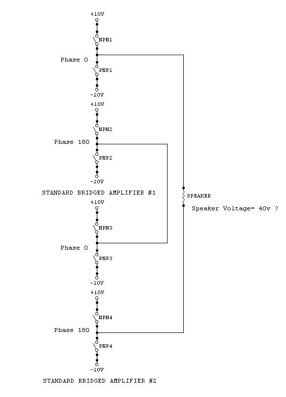

if u are talking about car amps then :
car battery is 12V so normal car amp will give u 12Vp-p (or 10-11Vp-p to be more accurate)
bridging two amps will give u 24Vp-p and thats it , u cant connect 2 bridged amps in series and get higher voltage (-higher power)
paralleling amps? well its possible , but why ? its better paralleling only the output transistors .
bridging 2 amps will give u higher voltage
paralleling 2 amps will give u higher current

"How do you bridge two already 'bridged amplifiers'? I never seen this before.
Can someone draw a schematic or block diagram on
how this works?"

The problem is not with bridging but rather with serial connection of multiple bridged amps. The amps must be floating to do this. As was stated earlier, alot of car amps are not floated.

u CANT . thats what i tried to explain , it may be possible if they got separate power supply but if u are talking about car amps (without smps) that using the 12V battery then its impossible.

Very very few car amps do not use a smps. Having said that, even if they use smps that is still no guarantee as stated ealier.
