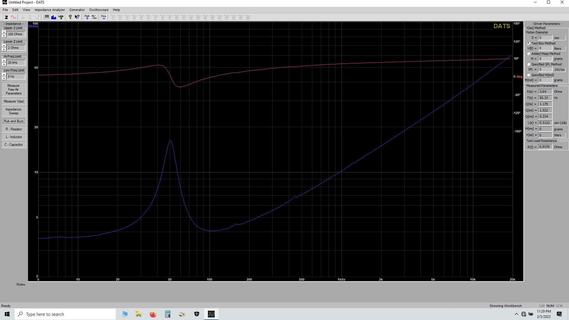

Sorry, the Dayton DATS WAS EVIDENTLY USELESS FOR ACCURATE MEASUREMENTS

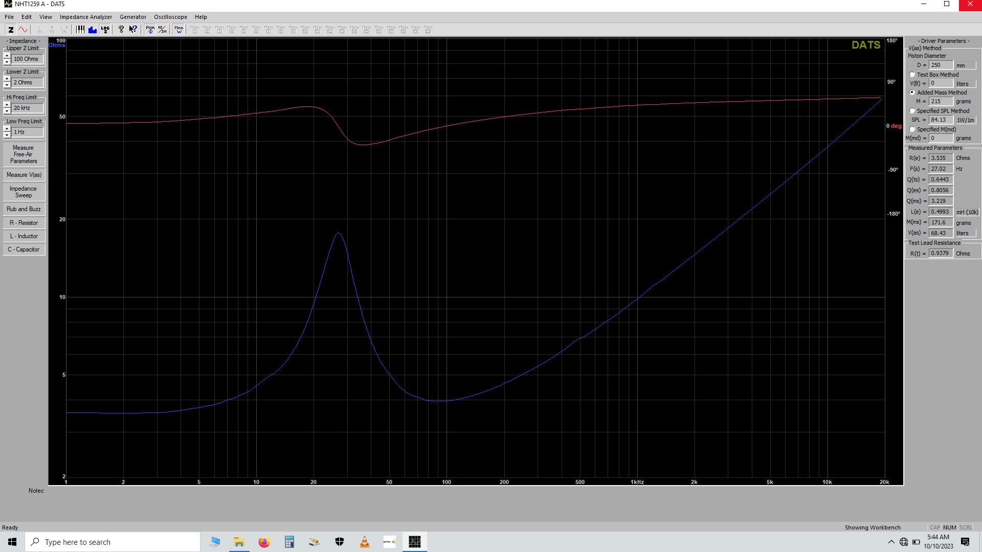

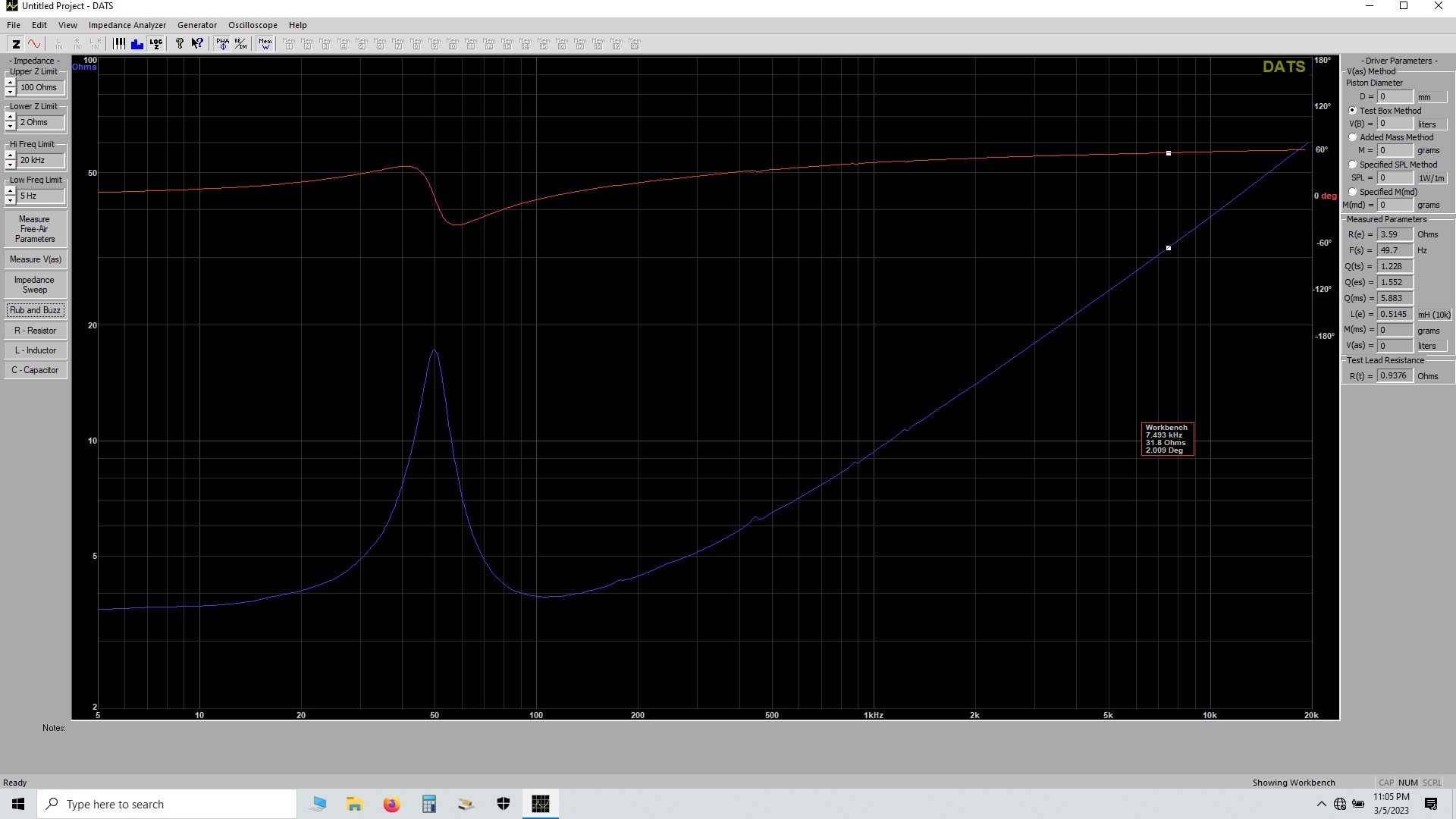

I actually have 2 of the old 1259 woofers and a total of three 1.42 ft3 cube enclosures (but I only mentioned one set to keep it simple)
I tried Dayton's DATS measurement device to measure these, with questionable results (carefully following instructions for added mass).
attached are screen shots, showing free air measurements for one driver, and then measured both units ("a" & "b") w/ added mass.
I became disappointed with the DATS, and returned it to the seller.
Do any of the data look useful for figuring out this project?
-C
p.s. I am stuffing these enclosures with 1lb each of AcoustiStuff per manufacturer's recommendations.

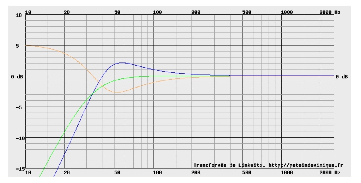

Well i've tried to simulate Nht 1259 on an online sim ( petoindominique.fr) and it seems to match more or less number you gave for box volume ( circa 40 liter).
It says with an Linkwitz Transform of Qtc 0.707 and FC 33hz, you'll loose something like 6db of max SPL ( half an octave extension as said earlier) and max output circa 99dbspl/1m with 150/160watts.
You'll need something like a notch eq with Q around 1,150 at 44,5hz and a +6db low shelf around 50hz. Should be in the ballpark.
Blue is driver in box, orange eq profile to reach green trace ( 0.707qtc at 33hz fc).

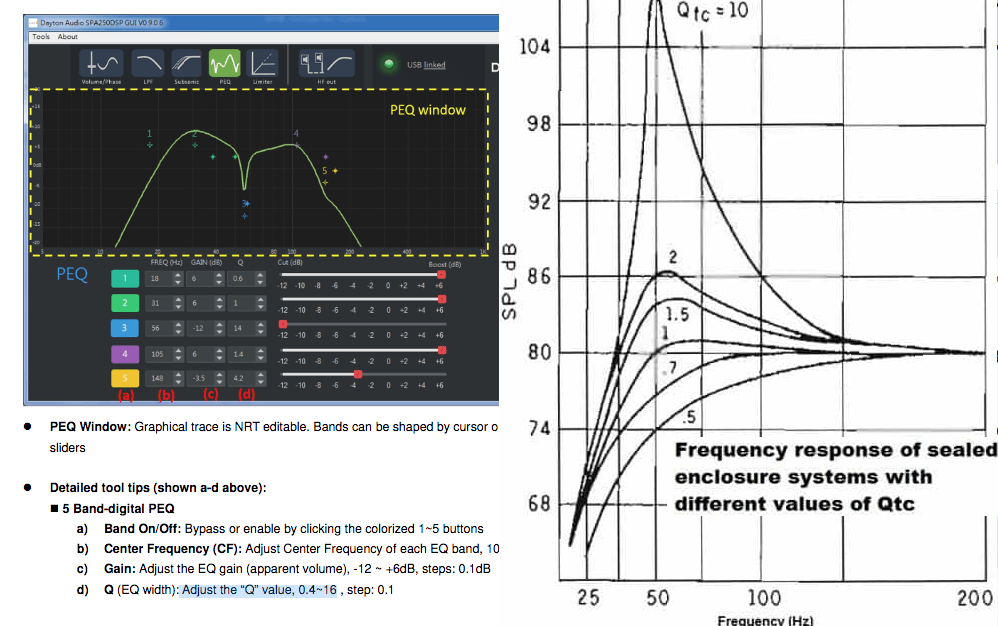

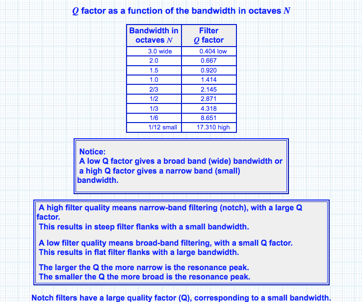

Your Dayton SPA250DSP has filters with "Q"s ranging from .4 (about 3 octaves wide) to 16 (about 1/10th octave wide).
http://www.sengpielaudio.com/calculator-bandwidth.htm
You can see the graphical result of applying 5 different filters of various "Q" in the screenshot from the SPA250DSP manual in post #7, each filter results in shape transformation (amplitude vs frequency) of the signal.
A very wide filter (.4) with frequency set low can be used to emulate a "shelf" filter as used in the Linkwitz Transform orange trace in post #11.
Basically, you apply the inverse of the measured response shape to achieve the desired system "Q".
Apply the -24dB/octave ("subsonic") filter at 25Hz to reduce excursion and maximize the use of your amp power below the point where the filter boosts provide little audible result.

Simple approach to set the DSP settings on that amp:
1. Export the predicted (or preferably, measured) FR of the subwoofer as an FRD file
2. Import the FRD file into Room EQ Wizard (REW)
3. Use REW's "EQ" feature to generate the DSP settings required to obtain the subwoofer response curve you want.
4. Configure the DSP with the settings from step (3)
