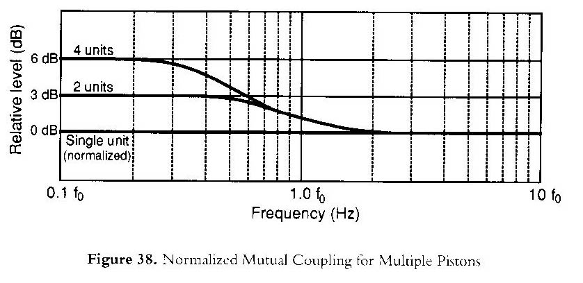

Ok, here it is, I have a graph but I don't know if I can paste from my computer.
The f(0) you calculated will be the reference point.
For two drivers.
- At .5 * the f(0) will be a full 3db increase
- At 1.1 * f(0) will be no change as compared to a single driver
For 4 drivers.
- At .3 * f(0) you will have a full 6 db increase as compared to a single unit
- At 1.1 * f(0) you will have the same output as a single driver (same as the 2 driver system)
Notice that for the two driver system it says 3 db increase. you would have to also add 3 db to the full frequency response because we doubled the power output going from say 8 ohm to 4 ohm.
f(0) is the point (below) were the mutual coupling becomes effective.

Here is the pictoral image of mutual coupling.
