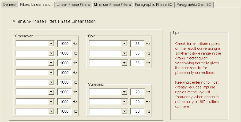

In rephase there is a Filters Linearization tab, there you can select the order of Linkwitz Riley crossover you are using and frequency, then when you generate a filter the phase turn associated with that filter will be "undone" for Jriver or most other convolvers generate the file as a 32bit stereo wav file at your sample rate and it should work without issue. It also has a box selection for port phase wrap and subsonic for a undoing the phase of a Subsonic High Pass filter. You can generate the filter and see how close to ideal it is in the main window and then use more or less taps in the filter to get the response you need. Very low frequency correction will need more taps if you want fine resolution.
You can use the other tabs for EQ and paragraphic phase EQ.

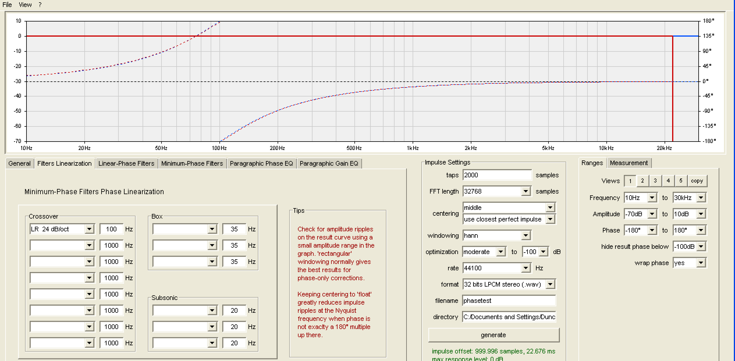

In this example I set rephase to undo a 100Hz 4th order LR phase wrap, and at 2000 taps it is only just starting to deviate from ideal.

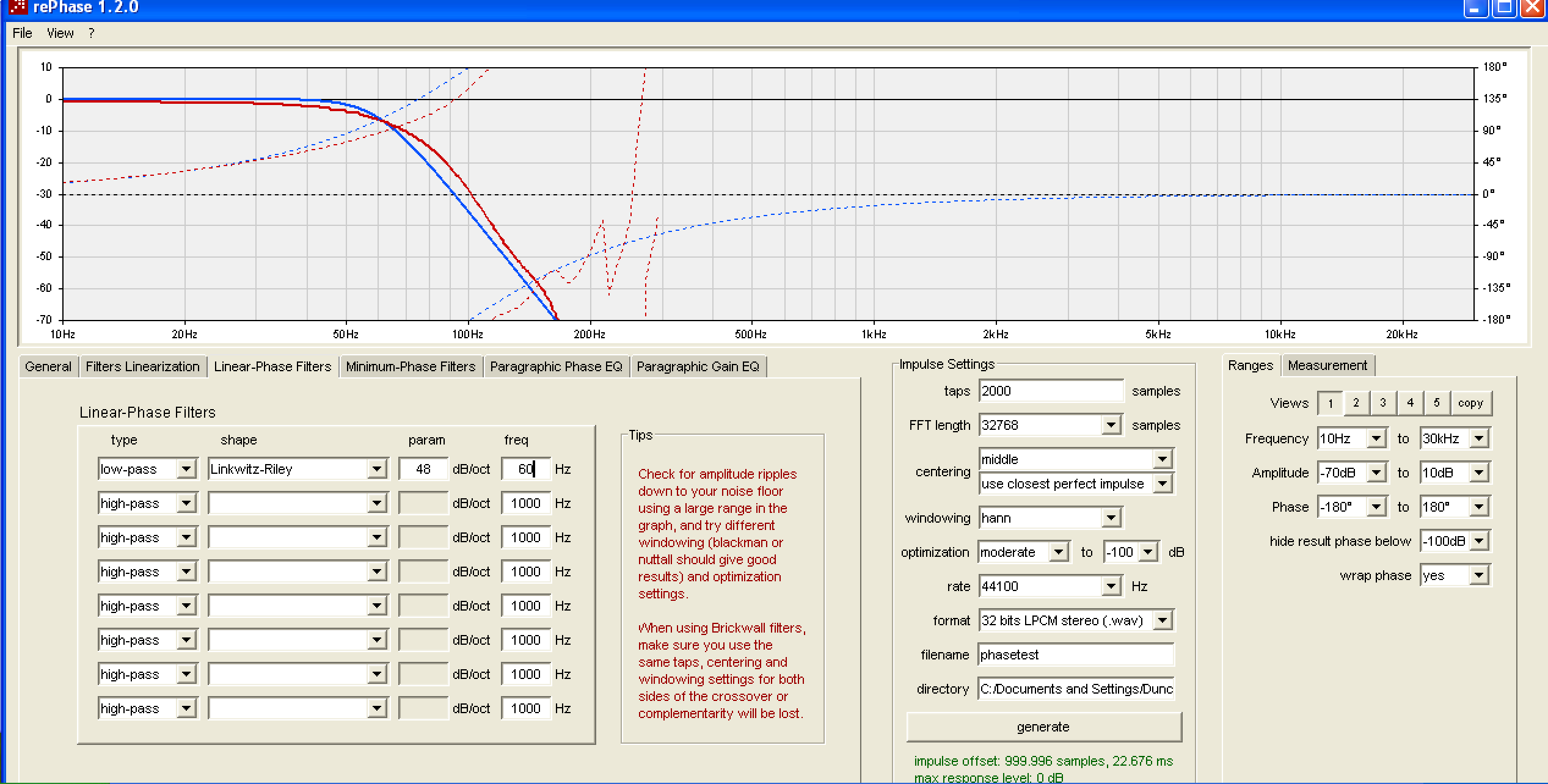

Now I ask for a 48dB LR crossover slope at 60Hz at 2000 taps, hmm not looking so good.
So phase change only is not so bad you could even load that in the Najda and use it's own FIR mode to do it. If you want to add any kind of EQ then you need more taps. How many is a bit like low long is the piece of string 🙂
