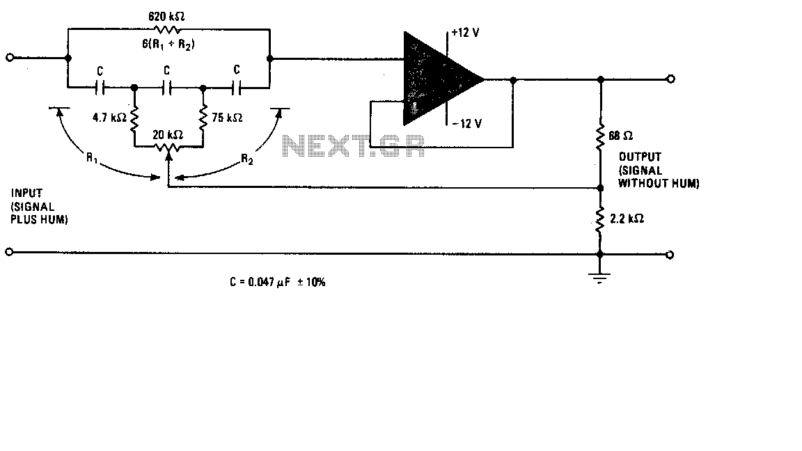

This came up in the low distortion oscillator thread, I forgot whose name is on this but there were some references in that thread last week. I simmed it and it worked great. It also works as a passive filter without the op-amp and Q enhancement response is then identical to twin-tee but with one pot frequency trim.

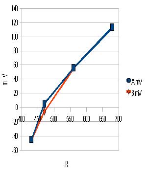

I have gone down from 680r (114mVac) through 560r (56mVac), 470r (5.6mVac) to 430r (45mVac). That 430r seems to have been too small the null went back up.
So I need somewhere between 6800+560r and 6800+430r since I do not know which side of correct the 470r was.
I need to fill in the gap @ 6800+510r and see where it fits with the other "off tune" nulls.
But the jump from 5.6mVac to 45mVac for a 40r change (0.5%) in total resistance shows the sensitivity to incorrect resistor values.
Thanks for that. It is a Thread I am following but I did not remember that proposal.
I will try it after I fail, or succeed, with the twin T.
I think you need somewhere around 478R. If you plot values, assuming that 430 is too small, 680 and 560 are too big, then you get a more linear curve by assuming that 470 is too small. Linear interpolation then gives 478.
I did some calculations for an added resistor value + trim pot and came up with 510r in parallel with series combination of (100kVR + 5k1)
That gave a range of 463r6 to 507r5
That funnily enough fits with your predicted 478r !!!!!
