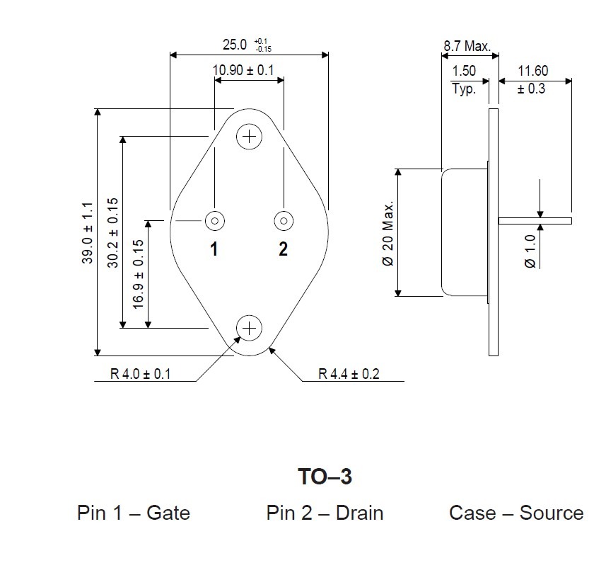

The BUZ is an N channel device so a quick check is to put the meter on a Diode Check range and measure from Drain to Source.
The pinouts are on the data sheets. Connect the Red meter lead to the Drain and the black to Source.

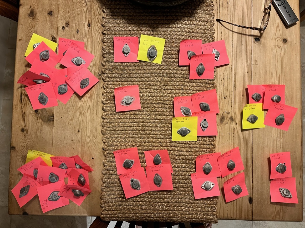

I got myself a Peak transistor tester which is what I used to test them this time around.Less than 1 minute each. 🙂
