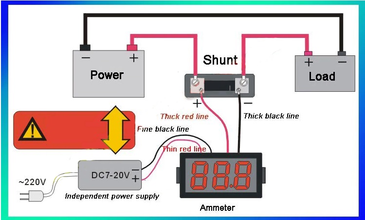

a few mV implies you're measuring voltage, not current. And the above about parallel runs is completely true. You can get an ATX extenion cable and use that as a way to make a shunt feed without ruining the wiring on your ATX.
Yes, sorry! ~ typo error! I meant mA (milliamps) i.e I was set to DCA.
I already got an extension so I wouldn't have to 'butcher' the real cable.
Please explain more about the shunt feed? What is it, how do I make it, many thanks!

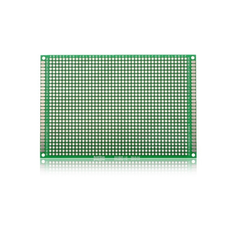

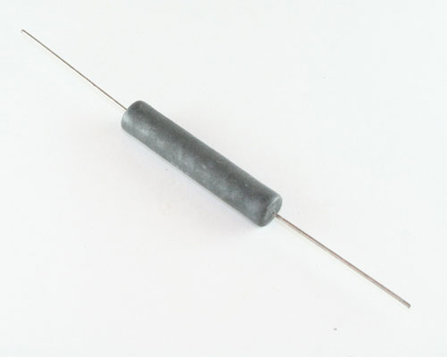

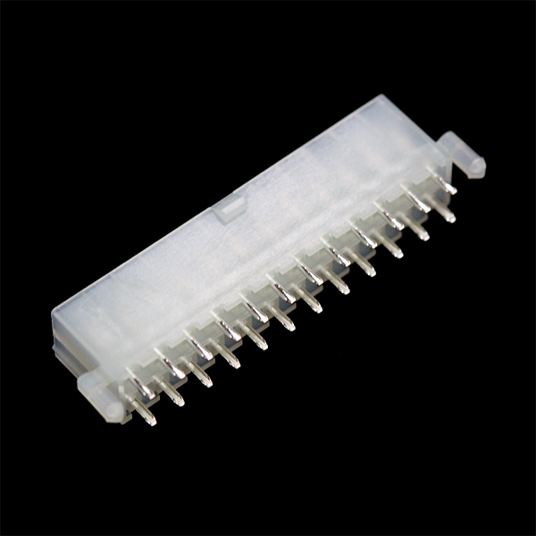

Anyway, if you really still want to measure that current you would need male and female 24 pin ATX connector, few 0.1 Ohm 5-10W. Solder it on universal PCB, place resistor in series with 3.3V / 5V / 12V lane. Measure voltage at each resistor. From Ohms Law I=U/R so for eg. I = 0.75V / 0.1 = 7.5 amps. Be careful to not short anything as you may end with fried PC. Keep in mind that under high load under voltage protection may kick in considering voltage drop at shunt. I don't think you will get any meaningful results with clamp meters.

Thanks for your reply! I am not entirely clear on this though(?):
"you would need male and female 24 pin ATX connector, few 0.1 Ohm 5-10W. Solder it on universal PCB"...
Can you elaborate any further? Picture? drawing?
Cheers!
"you would need male and female 24 pin ATX connector, few 0.1 Ohm 5-10W. Solder it on universal PCB"....
you mean these:
you mean these:
