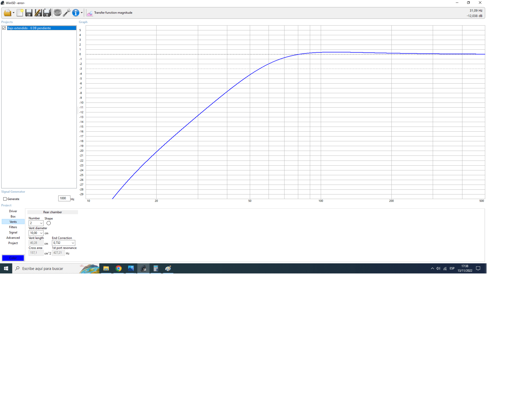

1) So you say that I should use 40.28 cm long each tube, correct? Just to make sure, I didn't understand that part about "at least it shows to me". In what, the box is shaded, is that perhaps?1. I think it already has the 0,732 correction, at least it shows to me, that it has. And it gives similar results to other calculators with the same parameters and K.

1) I plan to use round ports as it is in the attachment, you can enlarge it to see the values better. So 2x 16" long, just tell me yes or no, I don't want to clutter up the OP's thread.
2 ) Yes, that is the case, DeltaPro18A, 6.70mm Xmax,15mm Xlim. I only improve 2 Db in F3, but it strikes me that Eminence does not recommend it for sealing, so far it worked perfectly (with DSP) .
1. Then the WinISD length should be correct.1) I plan to use round ports as it is in the attachment, you can enlarge it to see the values better. So 2x 16" long, just tell me yes or no, I don't want to clutter up the OP's thread.

1) Does the length of the tuning tube calculated by WINISD have the 0.732 correction factor already applied, or should we apply it ourselves?
The program automatically applies the end corrections to the physical length shown.
For example in this attachment, I must multiply 40.28 x 0.732 and the actual length will be 29.48 cm? Or is 40.28 already calculated with the correction value?
40.28 cm is the actual physical length of the port tube.
The program adds the end correction lengths as necessary. No need for you to worry about them.
The 0.732 average end correction factor assumes that one end of the port tube is flanged and that the other end is unflanged.
Flanged = 0.850
Unflanged = 0.614
Flanged + unflanged = 1.464
Average = 1.464 / 2 = 0.732
Total end correction = 2 ends * 0.732 * port radius (same as 0.850 * port radius + 0.614 * port radius)
In your example there are two 10 cm diameter ports having a total cross-sectional area of 157.08 cm2
The equivalent radius is therefore 7.07 cm
Total end correction applied = 2 * 0.732 * 7.07 = 10.35 cm
Port tube virtual length used in the simulation calculations = 40.28 + 10.35 = 50.63 cm
Thanks David for clarifying how to get to 0.732. It's not easy to understand everything for a neophyte like me, but I'll keep trying ....🤔 As I said, I'll use only one tube, less work and easier to place. But...WinIsd marks "error" (top left, see attached) which puzzles me. I looked for my old laptop with Win 7 where I had installed WinIsd and copied all the values of the Eminence Delta Pro 18 A speaker (now out of production, they have even changed the web page and I can no longer find the PDFs of various cabinets .) there everything works better, ( no error message on the top left ) and there is information available, such as the graphs of admissible power, maximum SPL, etc. that can be visualized perfectly, not so in the desktop PC I currently use with Win 10.... Something must be wrongly loaded there, I guess I'll have to follow the instructions for loading data to the letter, - I understand that the steps for loading data of the speaker must be followed, so the program calculates the remaining cells. To work ! Thanks again.
