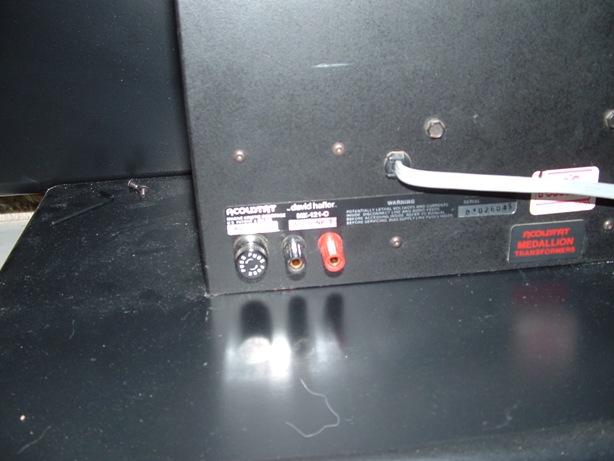

how do i know if my hf on my acoustat 2+2 are the same level?
I have this adjustment with a resistance that I slide a metal ring with a wire attached to it,I have a little gauge that tells me approx. where there high frequencies it is leveled but seems not to play exactly the same on each side but they are on the same spot.any type of mesument I can do with a multimetre?and is ther a modification I can do to have a sort of exterieor adjustment like other 2+2?

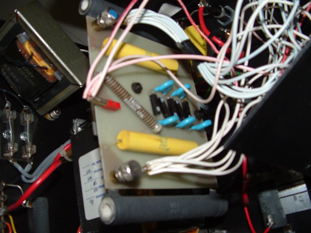

Ok, first thing - no matter what.
Get RID of that blue electrolytic cap that is in parallel to the yellow and silver (polystyrene) cap, I think in pic 2, that is in the audio path!! Replace with polypropylene of the same or similar value.
BIG difference!
Now, I can not see if you have two or one audio step up (drive) transformer in the the interface box or not??
The slider on the HF level control can be replaced with a LARGE like 20 watt or 50 watt rheostat, as is in the 121 MkII interface... but it is not necessary really. Or you could parallel a slightly smaller rheostat with the existing resistor, of course it would be a higher resistance unit... or add taps and put a switch in... 😀

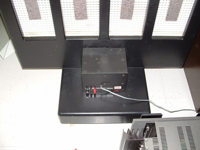

how about a wide shot of the innards?
_-_-bear
Hmmm... my 121-Mk2A interfaces have a different physical package...
A wide shot top down, showing the overall layout would be excellent. But we can assume that they are essentially the same electrically.
So, definitely change out the electrolytic cap, ASAP.
On my unit the the resistor w/slider is a rheostat. No reason not to buy a pair and sub them in... gotta be similar wattage rating though. These are have fat wire and are ceramic... surplus would be least expensive probably... remember you can get away with a slightly smaller or larger value, since most of the time the thing is at a mid position... or do the shunt trick as I already suggested.
Probably yours has the 50 ufd coupling to the mid/hf xfrmr. It can be argued that the 200ufd coupling is better/worse depending on your ears, etc... all of the early models had the 200ufd coupling there... you could always split the diff.

To repeat: REPLACE the blue electrolytic cap that is in the upper left of the third picture you posted. Replace it with a film cap - preferably using polypropylenes - ASAP!!
That will make the single largest positive improvement in the overall sound that you can make.

I have changed the electrolytic 47mf that you told me,my other question is which color wire really goes with the blue dot on the screw,is it the light blue wires or the white wires?I lost the othe rcolor on the other screw and want to make sure that the panels work in phase pushing before pulling,thx in advance so far so good didnt break anything yet!!
