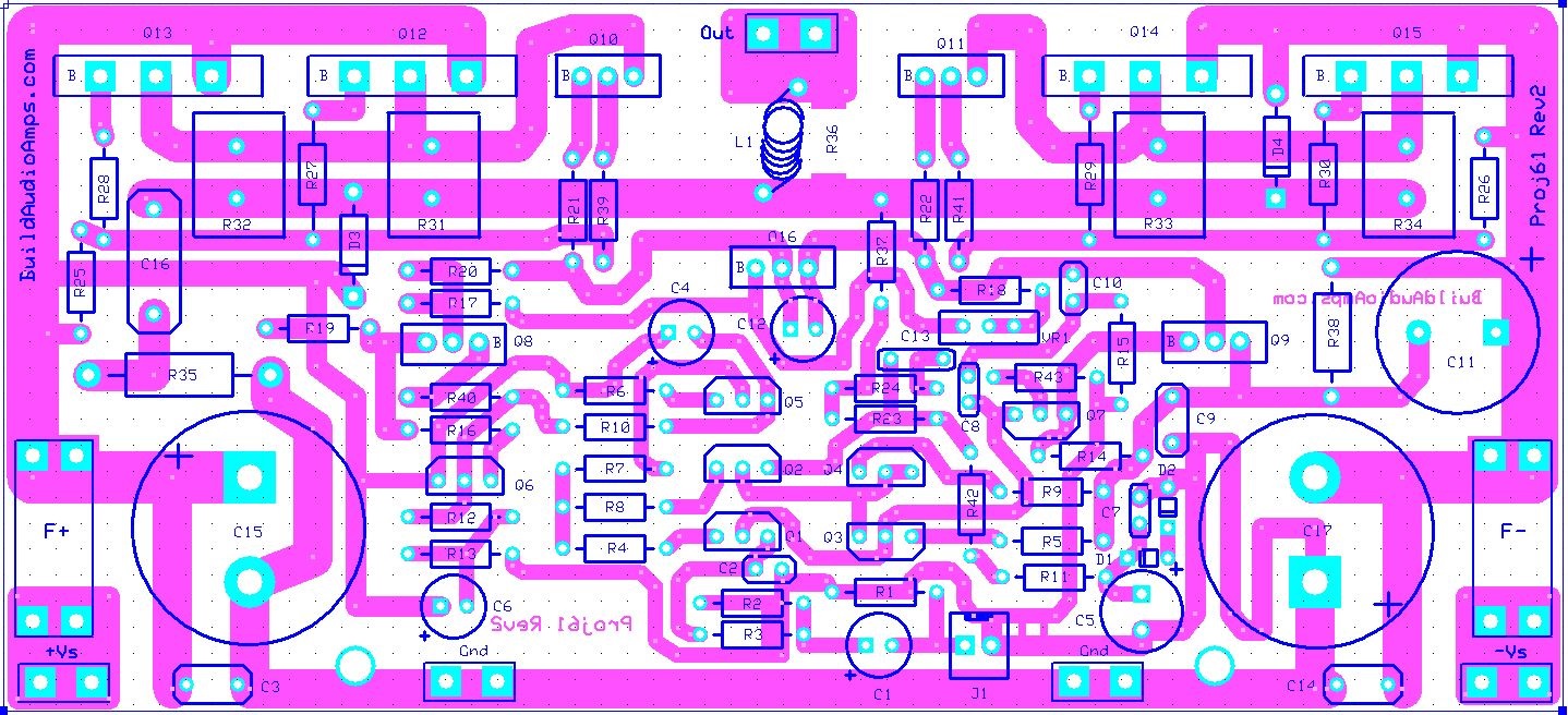

I’m going to build an amp based on the Douglas Self and Randy Slone’s designs form buildaudioamps.com, (http://buildaudioamps.com/project-61/).
The designer has an image of the PCB that has both the foil and component graphics. I just want the foil side. I’m not an expert manipulating images to make a PCB.
Is there a standard or easy method to isolate the layers so I can use the image to make a PCB?
I’ve attached the image.

If you can find a software that can remove a single color.
But then you still have the scaling problem.

It took me about 1 hour to do it. I used the Sprint Layout software. It allows to read a picture file. I took the file from the site you indicated and scaled to the 6x2.725" size. Then overlap the components and draw the connections. If you use the full version you can export the gerber and drill files that allows you to place an order on a PCB manufacture.
I gave up of doing my own pcb at home. It's a mess. There's a lot of manufacters doing that, with the advantage of double face (plated holes). The main drawback is the delivery time
