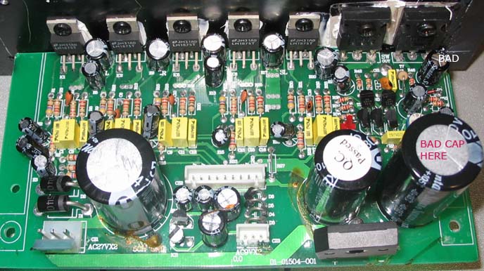

how do i fix my subwoofer
i bought a home speaker system second hand and it has really bad distortion throught the subwoofer channel, all the other speakers work fine. I opened it up and found 2 bulging and dried up capacitors with my ESR meter so I replaced them but the problem still remains. I dont know much about amps what else should i look for with this distortion .f rom what I see its using LM1875T amps for the speakers and using IRFP150 & IRFP9150 for the subwoofer, could these be stuffed? how do i test them?

Recheck the other electrolytics, especially the large one beside "BAD CAP HERE". If two already went west, likely some others are on their last legs. You might also want to verify the solder joints under the IRF devices, as they looked a bit dodgy to me.
i replaced the cap but no difference. i measures voltages of the mosfets while playing audio and they dont change at all
IRFP150 Vgs 3.2v Vds is 49.4v
IRFP9150 Vgs -2.9v Vds -48.9v
should the voltages be the same? also shouldnt gate voltage go higher than that? plz help im trying to learn
